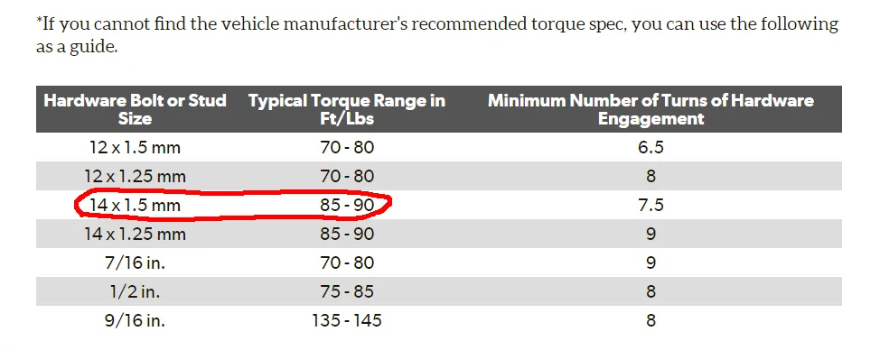

Reply from another firm, who also recommend 85 - 95 ft lbs per default for their lug nuts:
"I would not recommend any of the lug nuts that we manufacture when
torqueing to 150 ft lbs. They are not designed to be used at this high
of a torque spec."
So it looks like we have to be a bit careful about this, and not a) blindly assume (like I first did without giving it appropriate thought) that what the lug nut manufacturer recommends for our Mustang is correct, or b) assume that all lug nuts can safely be torqued to 150 ft lbs.
At least this company (Circuit Performance) gave a straightforward answer.

It's strange that they would manufacture lug nuts of a certain thread size, but which do not withstand the torque that's generally prescribed for that particular size. Because that torque value was not invented by Ford specifically for the Mustang.
I wonder if there's any car with M14x1.5 lug nuts whose manufacturer recommends 95 ft*lbs.
