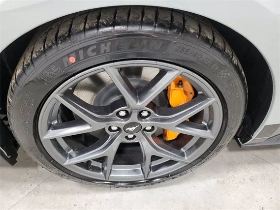

I'm converting my non HP car for the track. My question is about track tires. What should I wrap the factory HP wheels I have with? Pilot Sport Cup 2's or Pilot Sport 4S's? Would like to have a dual purpose tire but I do have my 255/275 4S's that came factory non HP.

Hi Bobby,
I would actually advise against both of those.
The 4S is a fantastic street tire but comparatively slow on the track.
The Cup2 is very fast on track but overpriced and wear quickly for street miles.
A "dual purpose" tire will make compromises for both fields. The more track oriented it is, the faster they will wear out on the street. The longer they last, the slower they will be on track. Finding the balance that best suits you is a decision only you can make.
With that being said, I think a tire around 200tw will suit you best.
BFGoodrich Rival S 1.5
Goodyear Supercar 3
Hankook RS4
Continental ECF
Kumho ECSTA V730
Hope this helps!

Not wanting to compromise, Sounds like I should keep my 4S's for the street and get Cup2's for track use only... any other track tires as good at the cups? I live close to Mid Ohio so they will see some road use to and from.
Goodyear Supercar 3R is faster than Cup2 and cost half the price.
Cup2s cost just as much as Hoosier A7's...I see zero reason to ever get Cup2's to be honest

looks like 305 or 325's out back, that rear wheel is 19x11..... I'm not showing a 315 in the goodyears

I would advise differently than the other responses in this thread. I would buy something with a tread life rating around 300. Typically that will be a tire that can run street or track and that you should be able to get 15,000 to 20,000 miles on mostly street with a handful of track outings.
Unless you are made of money then go ahead and buy the stickiest tires possible, drive really hard and replace them in a few weeks or after every other track day.
IMO getting the absolute maximum track speed is a waste of money. You aren't going to win any prizes. Just use a decent tire and have fun. Some people will be faster and some will be slower. It doesn't much matter.

this is a pretty good list of tires. There are a few others, but this list is already paired down to the good tires that will take the heat from track abuse and won't wear too fast. There are faster tires, but they'll also wear faster. (295/35R19 A052s if you can find the Yokohams. Also Falken RT660s)
If you're going to get a dedicated set of tires for street and for track, then its a good idea to look at a dedicated set of wheels too, and something closer to 11"F 11"R in size. Being limited to 255s on the front isn't great for track use.

I also suggest the Goodyear Super Car 3 tires. Fantastic tire with 220TW, only problem might be finding a set in stock. Another option is Hankook RS4’s for longer life and increased heat tolerance (hankookmotorsports.com).
