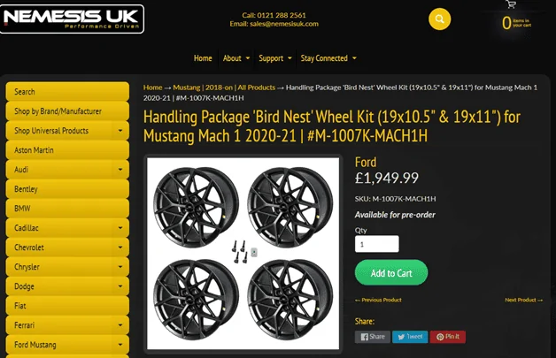

For all those in the UK (or EU?), Nemesis are also offering the wheels :
https://nemesisuk.com/collections/m...-kit-19x10-5-19x11-for-mustang-mach-1-2019-21
Also they are getting the front wheel arch lip mouldings, RHD strut tower brace, splitter, rear wing etc for those looking for other HP parts...

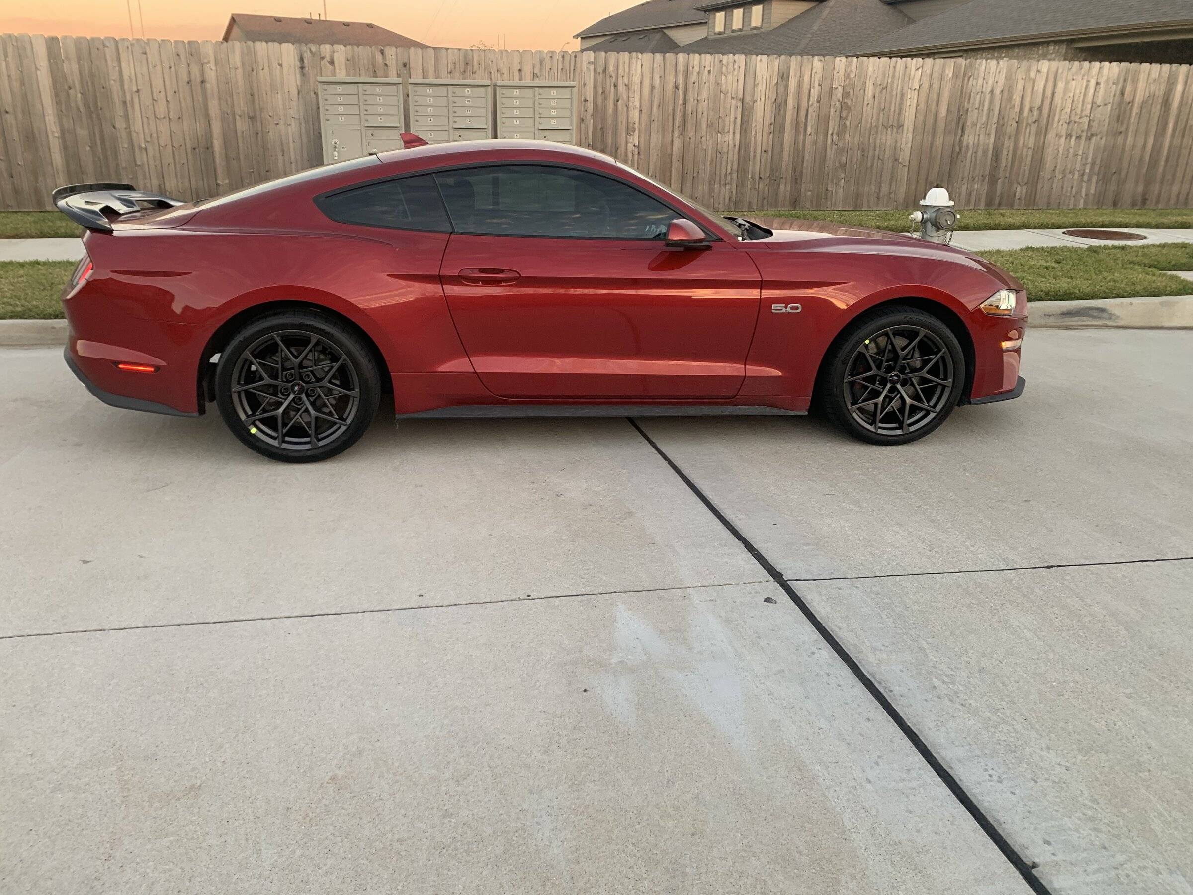

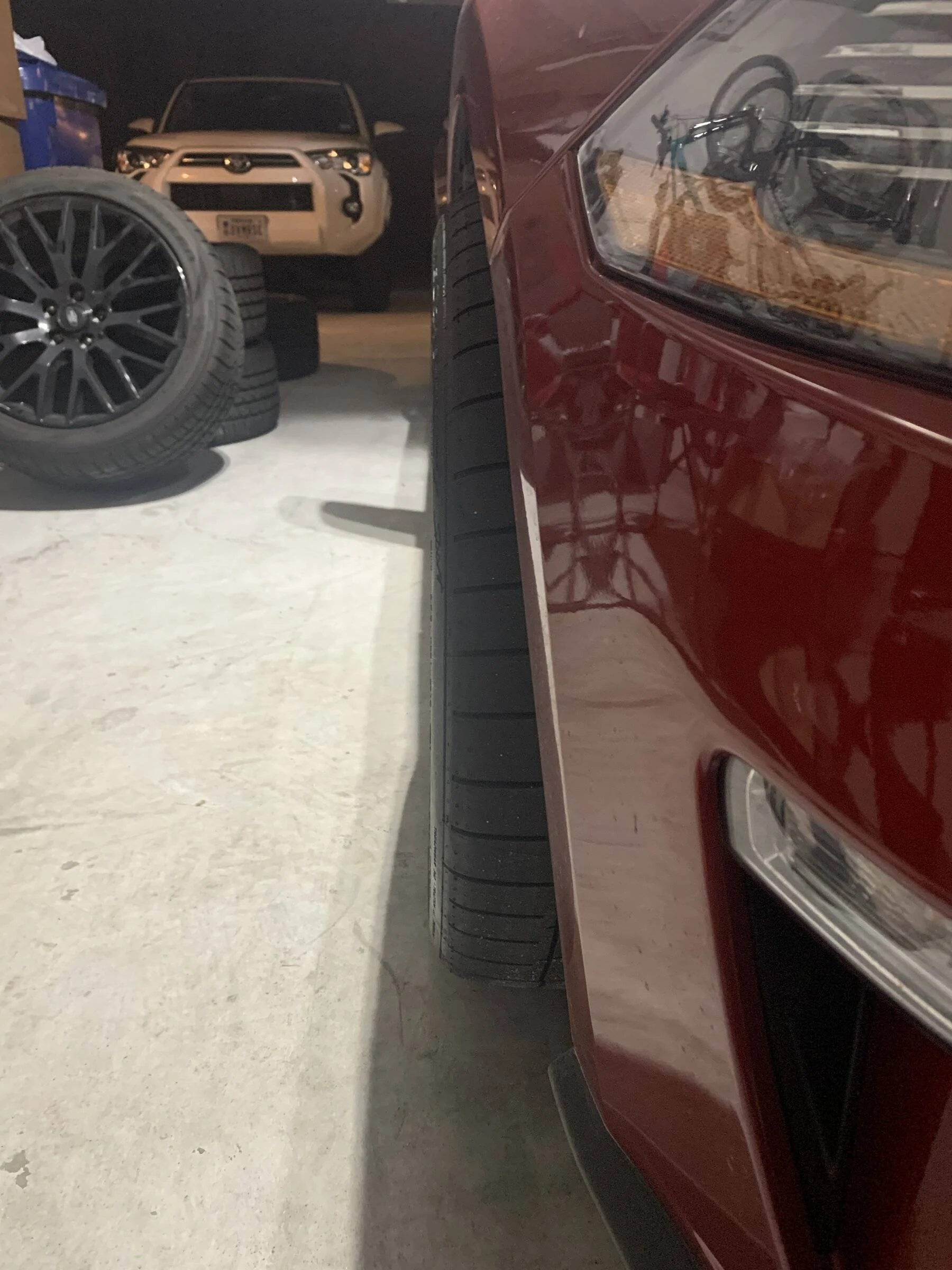

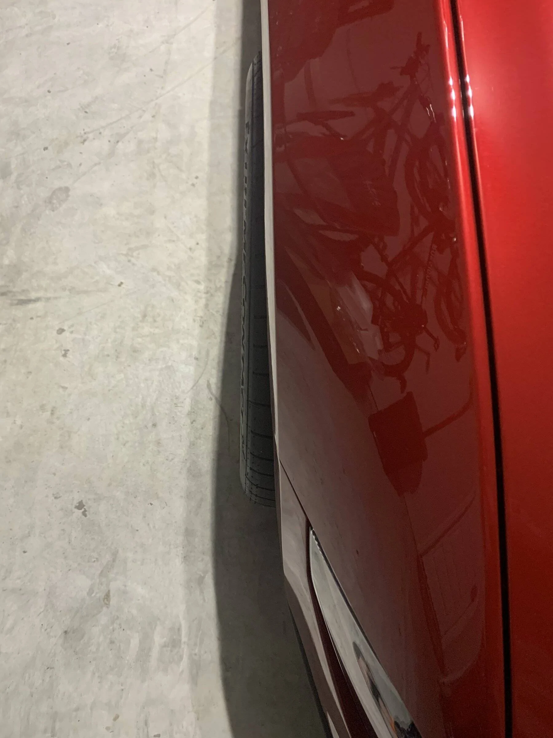

Just installed on Tuesday
Continental Contact sports
305/30/19
325/30/19
only Tires I could find in 315/30/19 were shitty cup 2 tires/pirellis and Goodyear supercar
front bulge is like a PP2 car I’m guessing
yes I know it has a mini 4WD kit lol

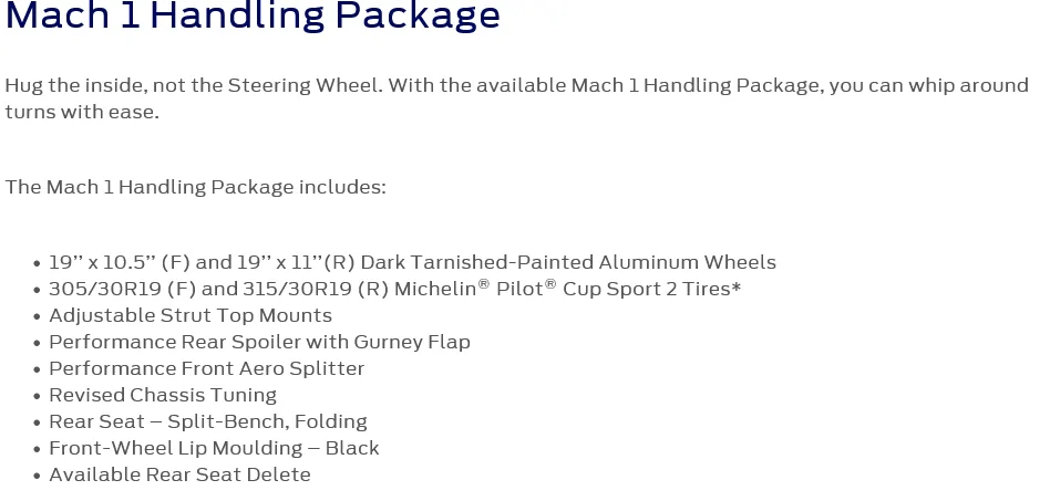

Where have you seen that the OEM HP wheels are forged?
I haven't seen that anywhere. All the literature from Ford only says Dark Tarnished-Painted Aluminum Wheels. I really doubt they are forged, and I'm pretty sure the wheel sets they are selling are left over 2021 HP wheels from all the forced cancellations of HP cars last model year.
Straight from the Ford Spec Sheet:
Screenshot 2022-07-24 at 12-01-29 2022 Ford Mustang Mach-1 Sports Car Model Details & Specs.png
If you have proof they're forged, please post the link.
If you want rotary forged, with a 1/2" narrower front wheel, go with the SVE MHP1 wheels. They have them in bronze, gloss black and graphite. FYI: They are also available for Mustangs all the way back to MY2005.
