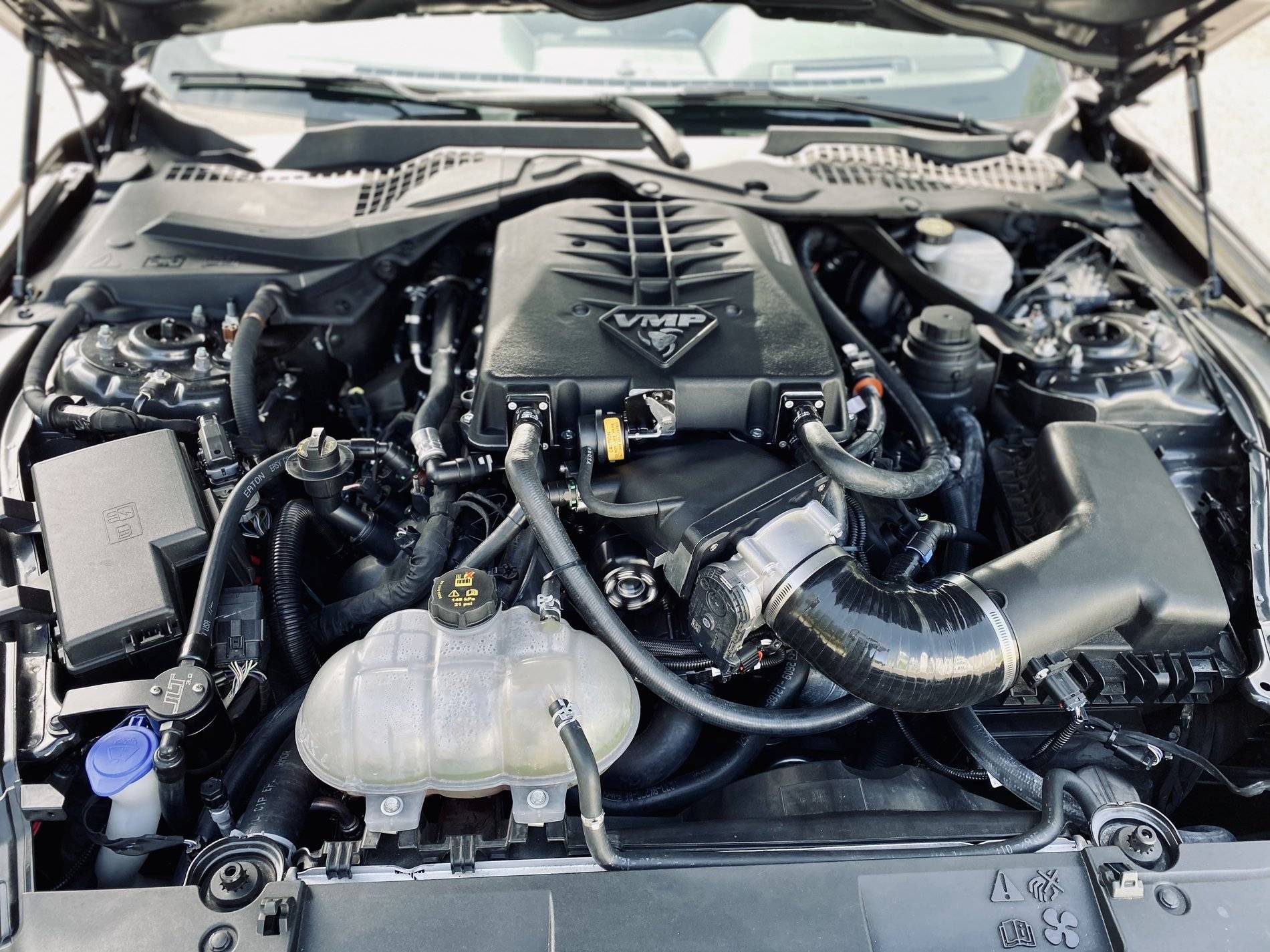

Adding some feedback on Loki. I installed with a friend last month. Upgraded to Boundary OPG/CS too. Kit came with 56# injectors, BAP and uses stock CAI and TB, single pass HE w/ Bosch pump.
Only fitment I didn’t like is Odin kit has a smaller footprint VMP CAI. Loki with stock CAI has me mounting the IC de-gas bottle off strut tower above the dipstick due to space limitations with the stock CAI. Not ideal to check oil.
And the smaller h/e and pump I'm seeing IATs consistently around 40-60* above ambient. Average Fall temps in my area are 60s right now and very low humidity. I'm working with VMP on the IATs but, their support is very slow with responses. That’s my only gripe with the Loki kit. Otherwise, easy install and great to drive.

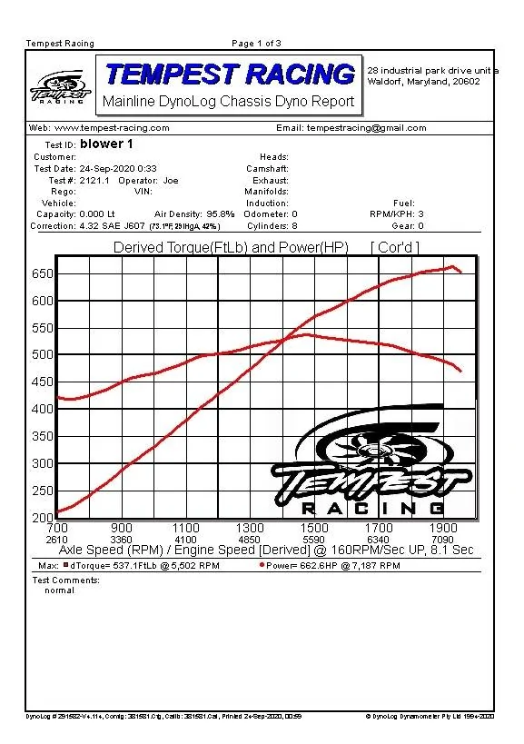

Tuned with Lund remotely for 93 pump gas and street driving. Had dyno run w/ 662whp/537tq . I’m very happy with my results. Loki is making about 10.5lbs of boost.
I went with Loki because I wanted to keep as a DD and not interested in dragstrip or track. Simply for my driving enjoyment. Just my feedback fwiw.

662! On a mild setup? That’s pretty good numbers. You got a gen3 or gen2?

right? i dont think anyone is going to scoff at 662 hp on a daily driver. thats an awesome number. Bet it feels great too.

40 - 60 above ambient sounds about right with the single pass Heat exchanger. That’s where mine are too with my GEN2R.
I’m thinking I will upgrade to the triple pass heat exchanger before summer returns.

Man this setup is insane! I think I'm gonna end up going with this! Sweet setup and nice engine bay!
