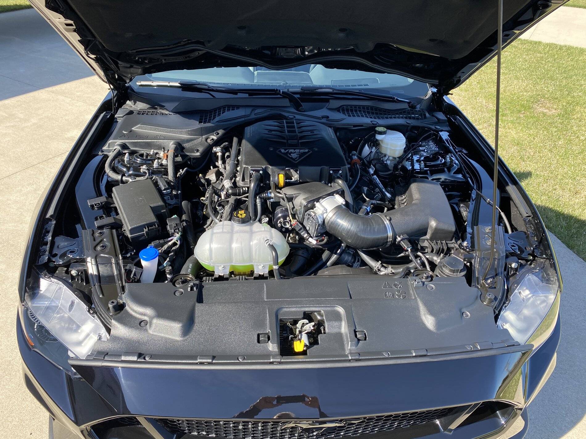

Question. I’m finishing up my install right now. The reservoir is supposed to go on the driver side but there isn’t any room over there. How did you route the reservoir? If I put it on the passenger side there would be way more room. Plus it won’t interfere when I need to check the oil. The recommended location just isn’t gonna work? I’m also wanting the new reservoir or ice tank, but can’t buy one as the new ones aren’t released yet, and the ice tanks are all sold out??... 🤷‍♂️🤨😒
I had trouble with the coolant tank with the Loki also.... I called and told VMP that there is no way that bracket is plug and play, they said they do it all the time. The only thing I could do was move it to the front of the car with a custom bracket I made at work.
