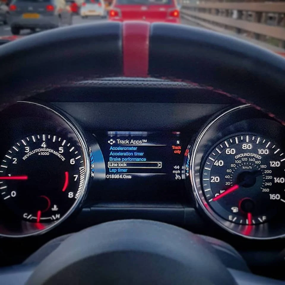

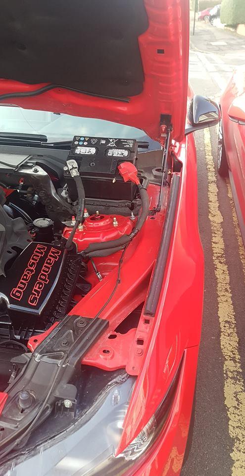

Just got this on mine (Thanks to @acull200 and this thread), we had a few issues, my battery is a little bit fucked, so the ABS ECU ended up getting bricked (about 3 times!)
ended up putting Adam's battery into my car to get it to work:
GtfPHkmpfnJWyPaaiDtgST09kj30INyMu73RWwIomLfQX2CZtH4zfmDxpnofZmX9X4HWLBfEA&_nc_ht=scontent-lhr3-1.jpg
But alas, we've got it working, tested, sorted, happy days!
