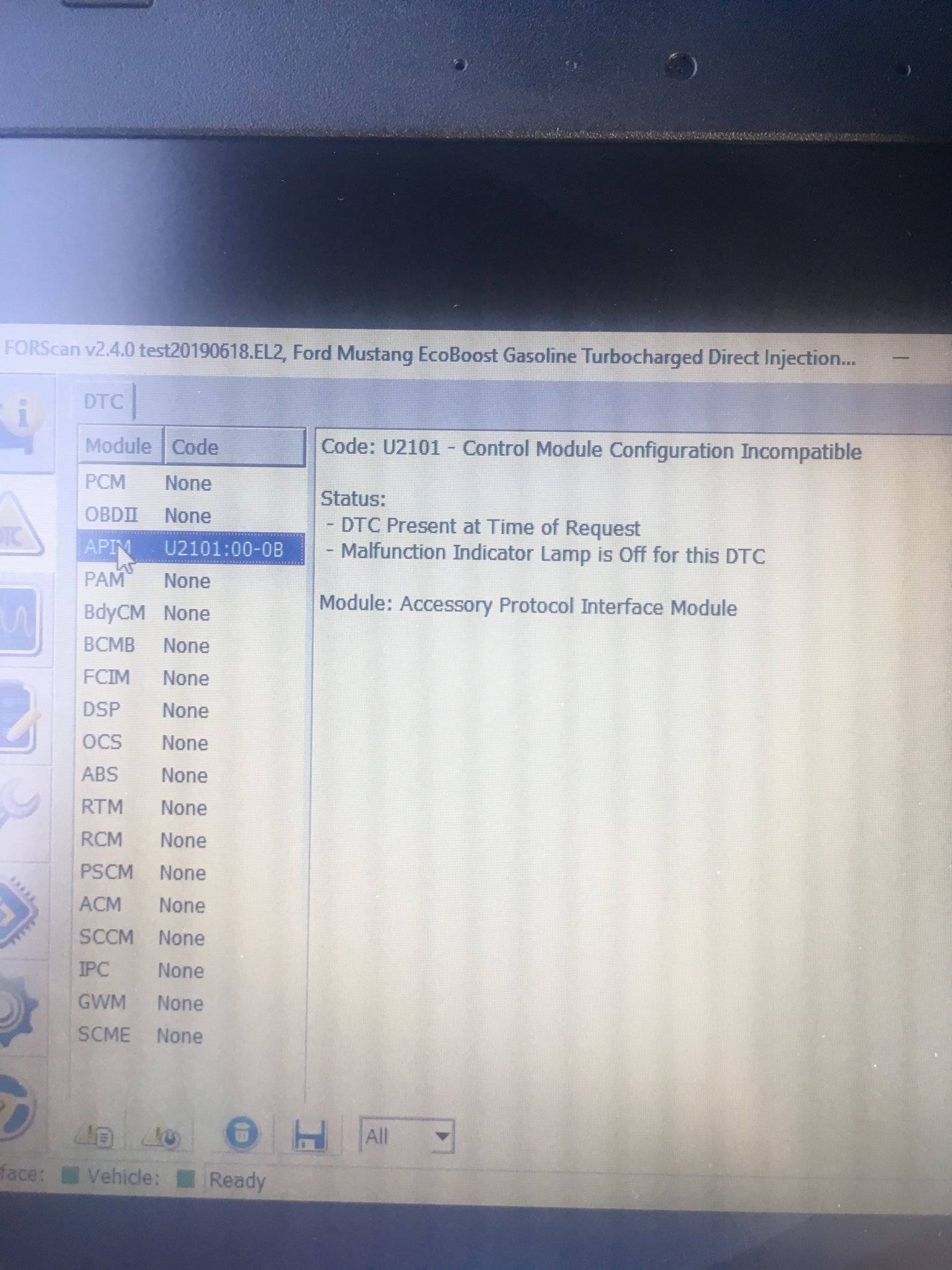

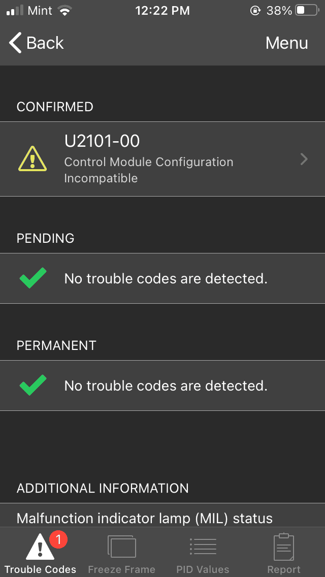

I flashed the gt stuff on my ecoboost and I have this code, everything works just fine. But is there no way to get this code gone?
does this cause anything negative? Not slowing car down or anything?
if I went to dealership. Paid $100, to flash abs module back to as built- would it fix this and can it even be done back to my ecoboost settings? I don’t even use linelock and kinda want it back to normail.

it actually may not be a DTC from the abs module, it may be my APIM. im gonna reset the APIM to as built first, see if goes away. I have no driving issues.
other than I cant use my ford performance dongle tuner, because it says firmware doesn't match hardware/ (ie. abs module) which I might have them reset honestly

[QUOTE = "FreePenguin, сообщение: 3070482, участник: 44822"]
на самом деле это может быть не код неисправности модуля abs, это может быть мой APIM. Я собираюсь сбросить APIM в состояние, в котором он был построен, посмотреть, не исчезнет ли. У меня нет проблем с вождением.
кроме того, что я не могу использовать свой тюнер ключа производительности ford, потому что он говорит, что прошивка не соответствует оборудованию / (например, модулю абс), который я мог бы честно сбросить
[ATTACH = полный] 522744 [/ ATTACH]
[/ QUOTE]I had this error fun even before updating the abs module. I still have it and I don't know what to do with it, it doesn't bother me.
This error shows up, if the module configuration does not work for your programming.
Have you changed anything on your APIM related configuration? APIM does not seem to be related to your changes of the ABS.

I’m going to post an update
Tuesday I receive my new obslink dongle and I’m I’m going to try to flash my original 3 software files back to abs module.
http://forscan.org/download/FORScanSetup2.4.3.test20210121.exe
I have assermines that the apim code is directly related to these abs files. I will find out though Tuesday hopefully and don’t blow my car up.

I successfully removed all old files and got oem
Files back, I also got all the as built back. Ecoboost owners, do not do this I would go against it fully . I cannot use my Ford percent tune due to numerous residual code changes
Ford is going to be reprogramming my car to factory and we will see how it goes from there.
my car did drive just fine, great and brakes great
but imo. I wouldn’t recommend this to another eb after me experiencing the hassle of reverting back
