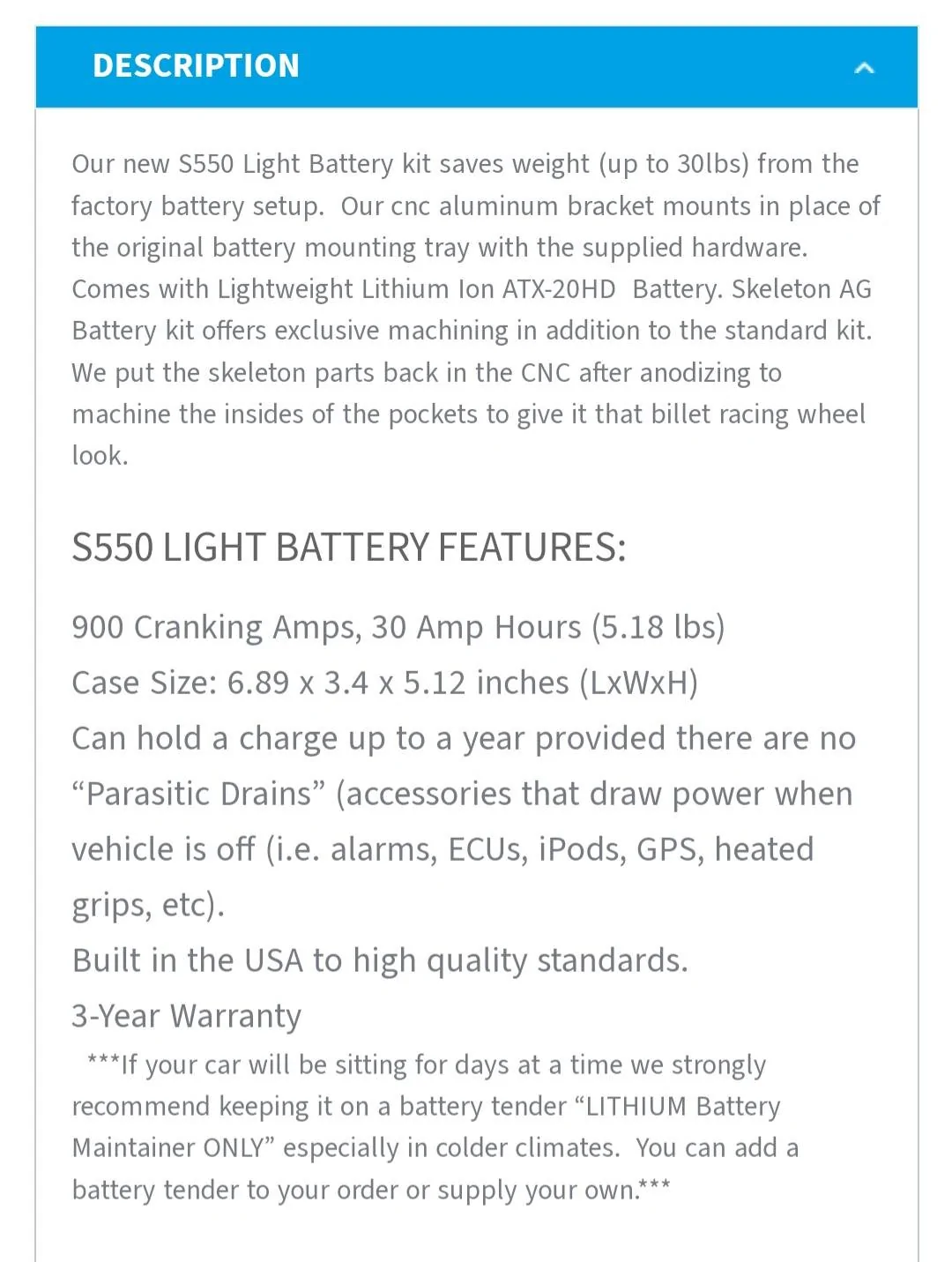

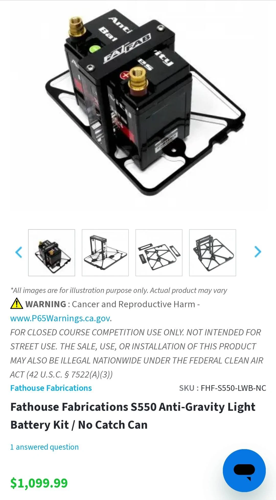

-billet battery tray &
Anti Gravity brand Lithium- 900CA.
You'll be paying ~$30+ per Lb, for wt savings - vs Motorcraft wet.
Li-ion should be tendered if sitting.
Wouldn't recommend as your 1st ~25 /~30lbs of wt# savings coming off a street car....
...but would be if it was last ~25 pounds you could find, at that price/per pound.
Cheaper options are out there.
