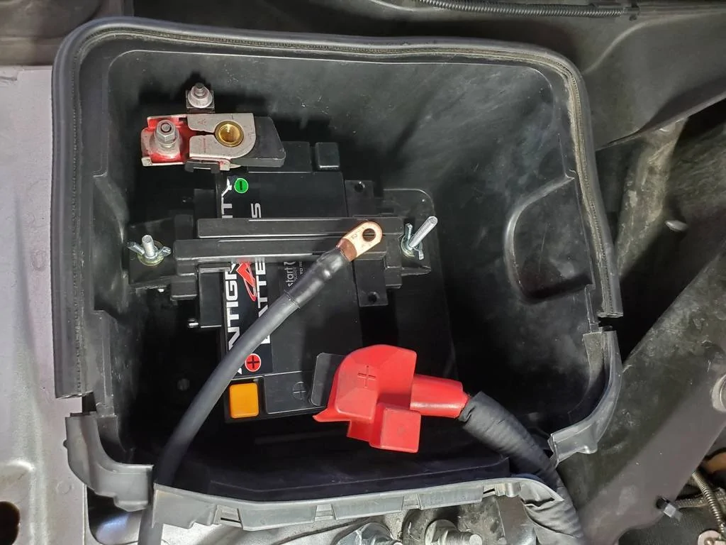

Are there any good lightweight batteries that are "plug and play" with the existing battery holder, cables, etc? It seems like most of them need semi-custom installation, with special brackets, tiedowns, tray, etc.
As much incentive as there is to reduce weight on cars, I'm surprised they haven't started to offer lightweight batteries as a factory option.
Antigravity now has OEM sized batteries but they're expensive: https://antigravitybatteries.com/products/starter-batteries/automotive/ag-h5-rs/
I relocated my small battery (less than 5 lbs) back into the OEM battery box using a generic tiedowns from O'Reilly's because local track techs weren't happy with it in the passenger side firewall area (passed the tech first two times).
I can think of a few reasons why LiON batteries are used in most cars:
1. Expensive
2. They don't do well in extreme heat and cold environments
3. Lower amp hours
4. Need to disable smart charging for batteries with on board batter management.

I know this is an older thread but really like your solution. Do you happen to have this set up still? How did it hold up since install?
Got another pic of it? Thanks man and looks great (and way more appealing than the other kits out there).
It's been working great since I turned smart charging off via Forscan. We've been seeing highs of over 100 degrees in the Phoenix metro area and no issues so far starting the car during middle of the day. One thing I noticed is that during the peak winter season where nightly temperature got close to freezing, it struggled a little bit to start the car and we are talking about a lower compression 4 banger here. So keep this in mind if you live in a cold climate and don't store the car for the winter.
Picture in the quote is how I'm running it now. Below is when I had the battery by the passenger size firewall when I thought the battery couldn't handle the engine bay heat during the summer. Let me know if you're looking for a particular picture.
