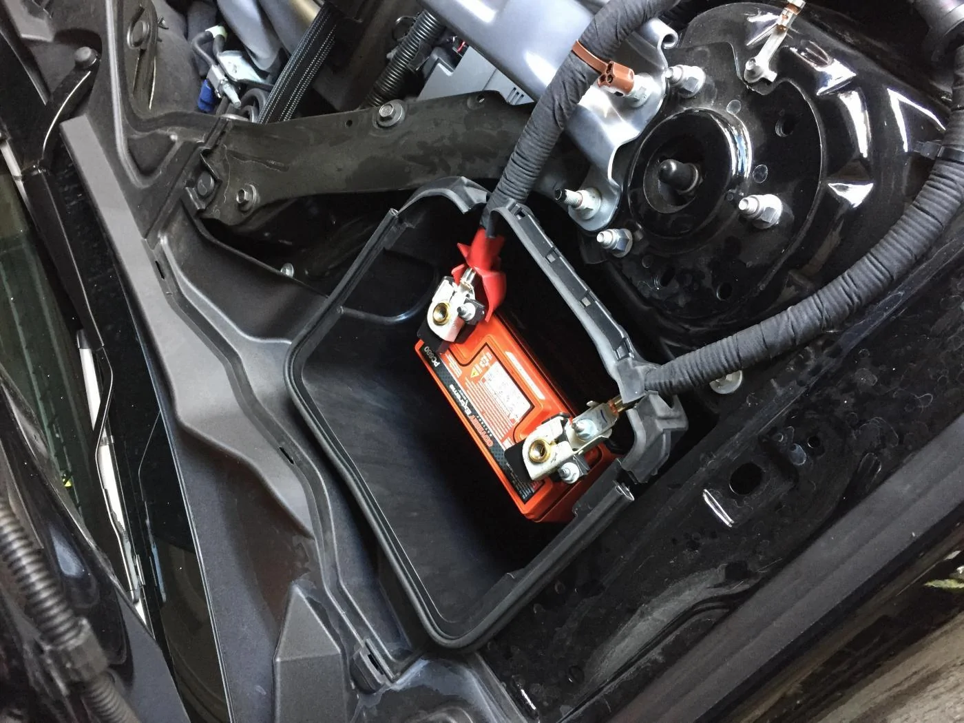

No they don't. I got everything from amazonNice! Thanks for the pics [MENTION=18243]Simmons-Racing[/MENTION].
Where did you get the automotive terminals from? They don't come with the battery, right?

Thanks for the update. Was about to place an order. Now having second thoughts.Update on the lightweight battery........ Ford decided to free wheel the alternator on the highway and only charge when needed. So I drove 7 hours to Wilmington Ohio for the pro solo and the battery is having a really hard time starting the car.
When I get home I might just put the stock battery back in and just take the lightweight one with me for big events.
