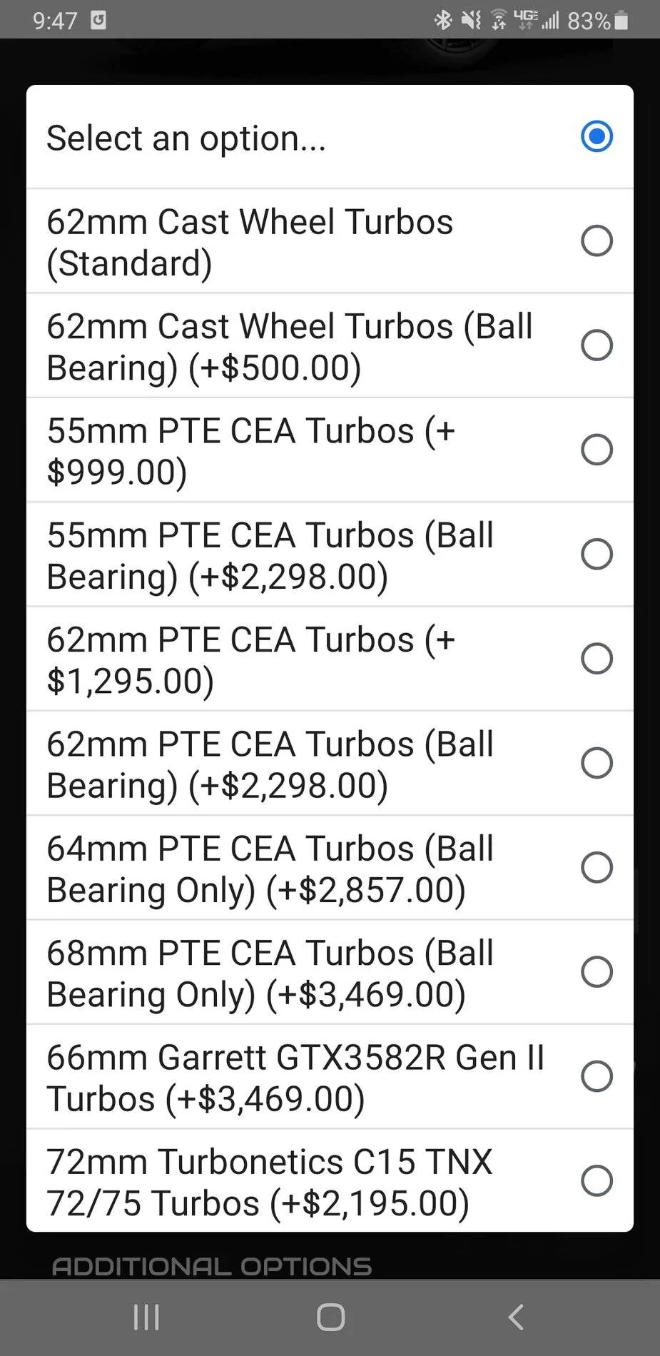

I'm talking about the options on the Hellion kit, where you can pick the turbo size in either ball bearing or no ball bearing options.
Not sure why the small 55mm are more expensive than the 62mm. Also not sure what PTE CEA is?

PTE are precision turbos. The journal bearing turbos do use water. The ceramic ball bearing turbos do not. The kit will come with the required materials/hoses oil restrictor etc based on whatever turbos you choose.
