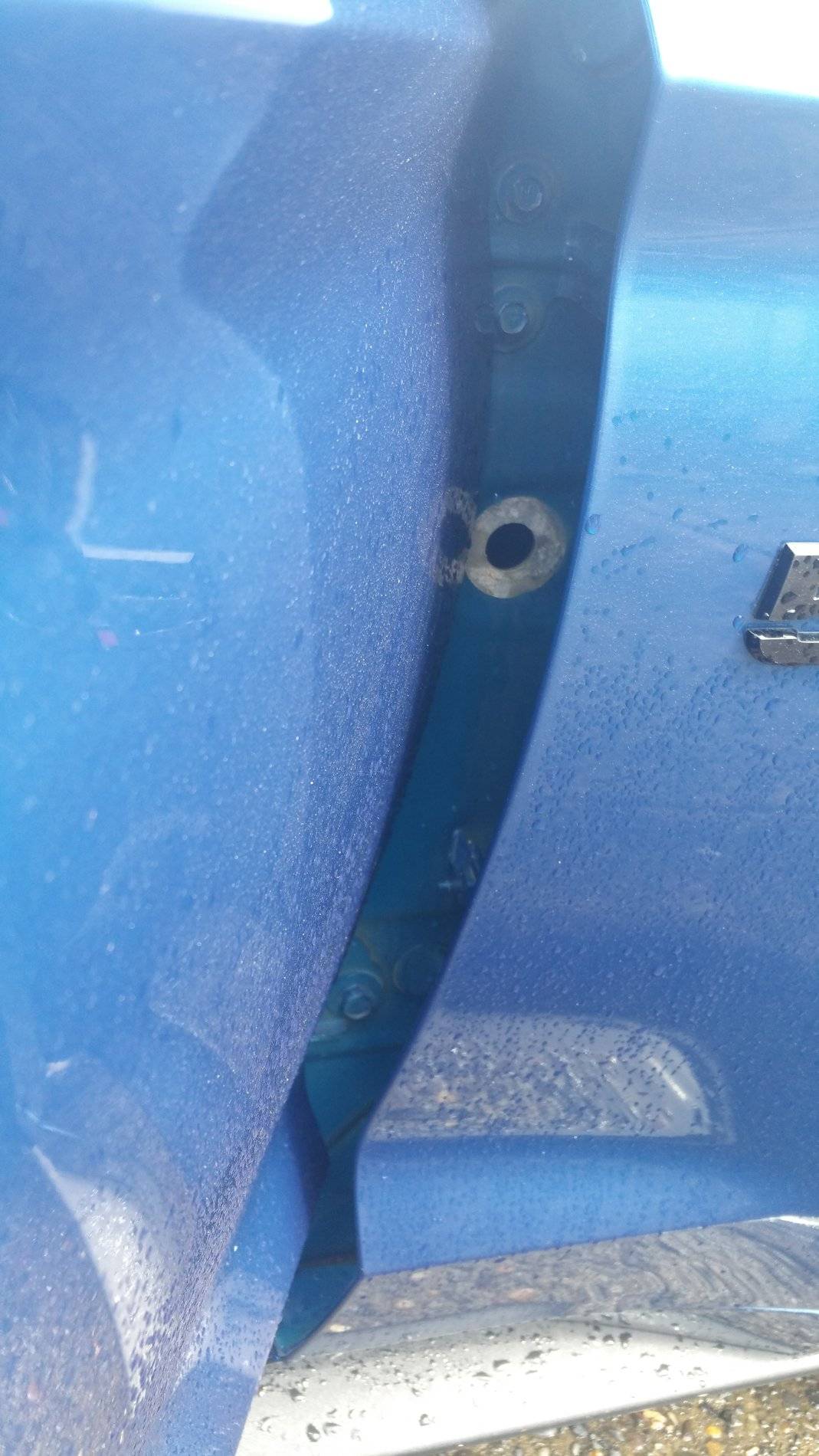

Here is my water leak I just located. The leak on mine is in the area by the door hinges. Ford put stickers to cover holes....painted over them....wala....sticker comes off.....3/4 inch hole.....flooded floor behind passengers seat. I plugged it with a tapered rubber plug....flushed it up.....swipe of clear silicone.....hillbilly fix. Trying to get Ford to weld up the holes and repaint....dreaming

I'm late to the party but does someone have a good DIY fix? I see some people used super glue on the old stickers, duct tape to replace the stickers or tape over them, and also some kind of rubber plug? Which way is easiest and most effective without having to remove the doors?

I am going to guess the holes are alignment holes for the jig, or robots to use as a known location.
Maybe a little dynamat to cover the hole after cleaning and scuffing up the area with a scotch pad, then put the sound deadner over hole, then seam sealer at the edges of the dynamat patches. This should last a lot longer than a "sticker"

Someone on reddit posted their update and a TSB for this specific issue.
The TSB fix is to plug the 2 main holes with a rubber plug, but it has no mention of plugging the other 2 holes that sit at the top. Both stickers (small one at the top and main middle one) are peeling way on my driver side.
I also found an article and rubber plugs that LMR posted to address the same middle holes that cause leaks, but they to do not mention the other holes covered by smaller stickers. Has anyone bought these from LMR to plug theirs?
