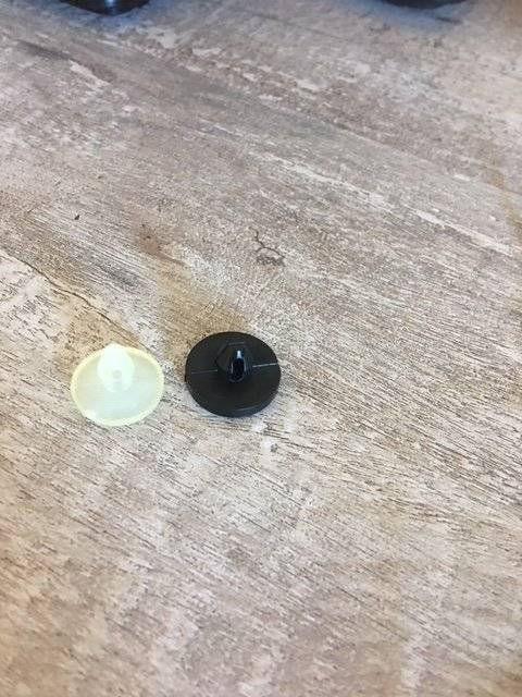

Thank you, but the holes look a lot smaller than that type of plug IMO. Look under your brake/clutch pedals and look for the yellowish rubbery pads to activate the switches; I think something like that is what we need (probably with some silicone behind as well).
I'll wait until somebody actually finds a plug that works, and just slap some silicone in there if necessary, in the mean time.

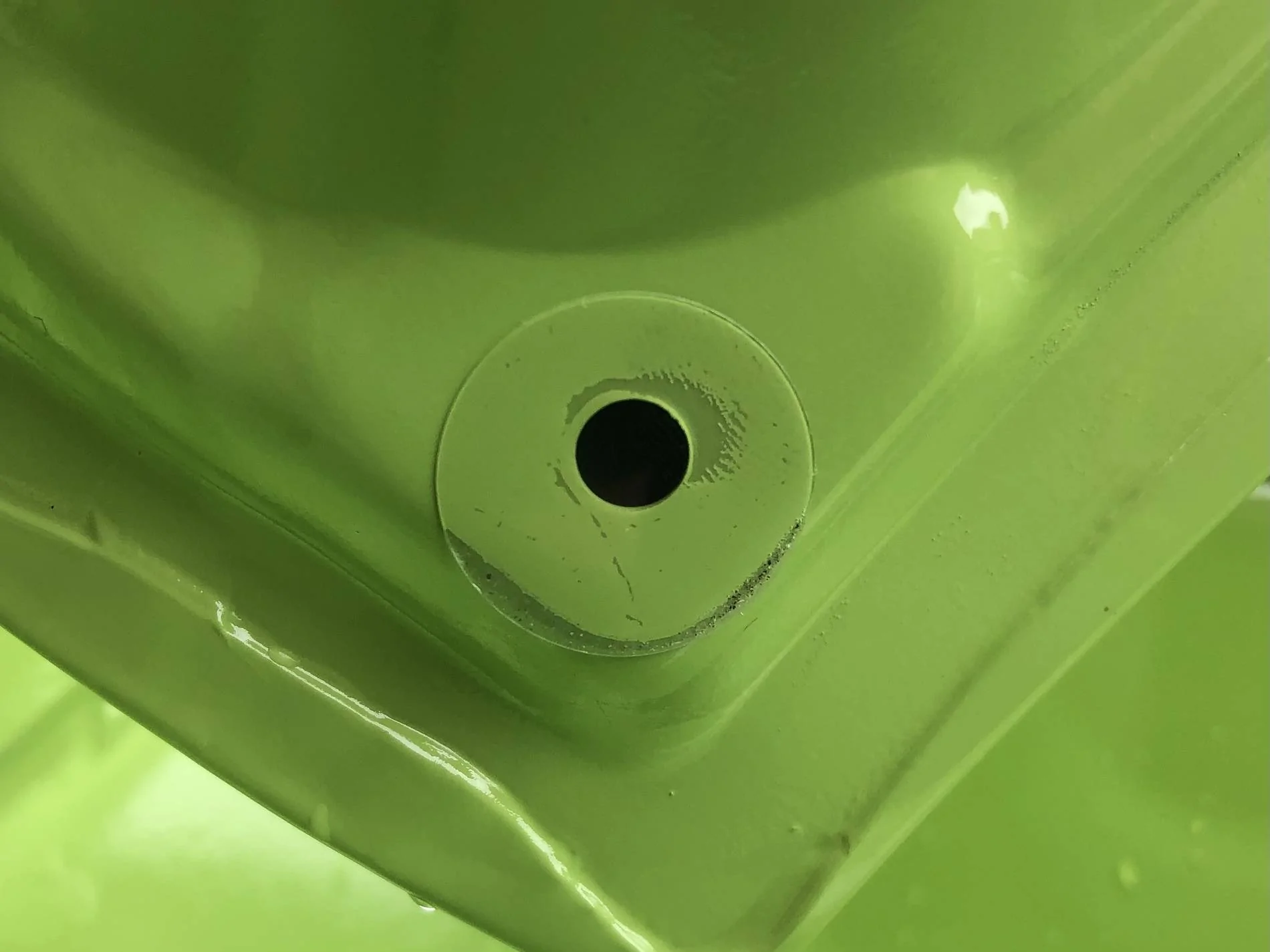

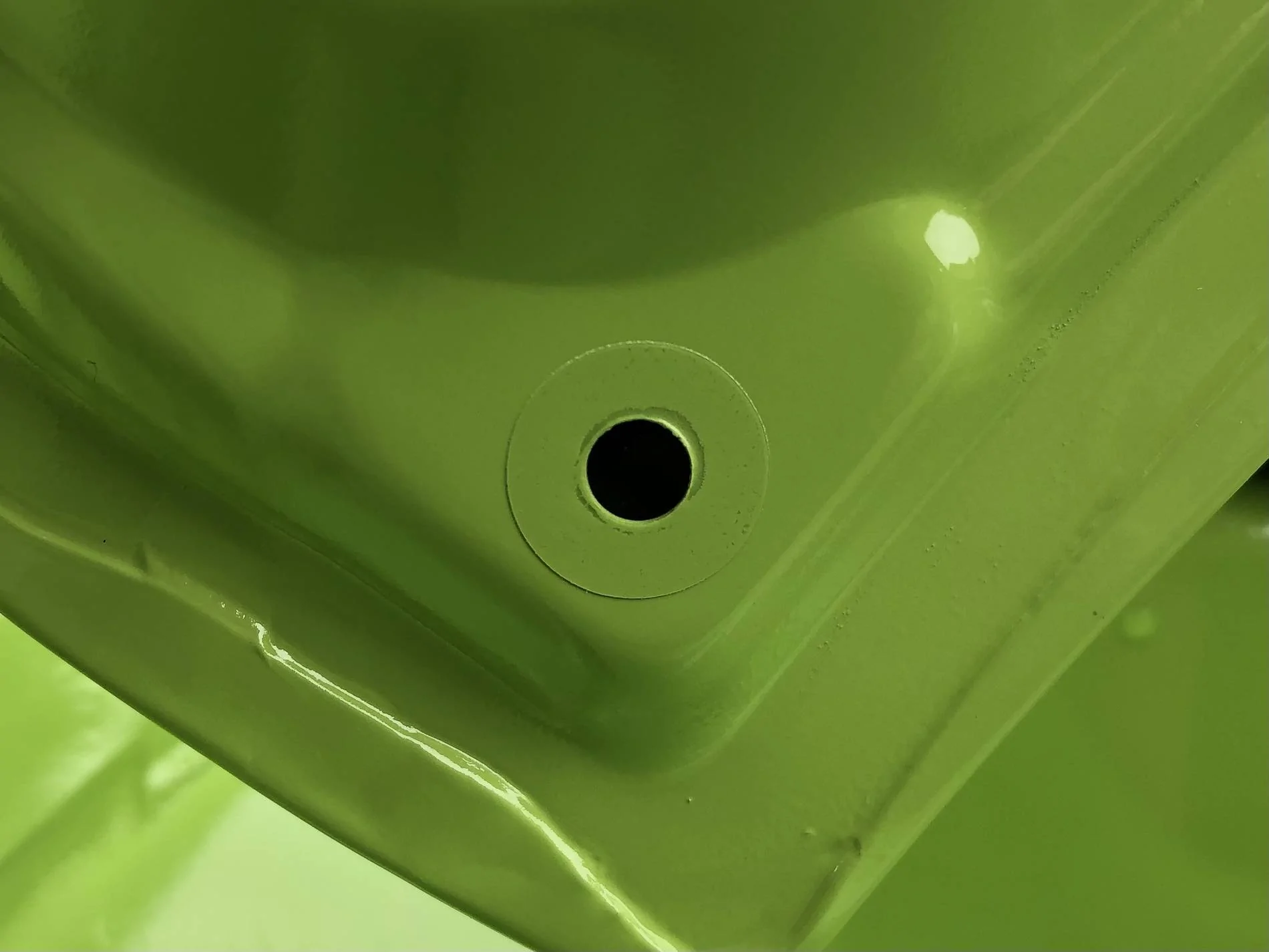

There are no “part numbers” for the asinine stickers that Ford is using during the assembly process. What’s even funnier is folks in the GT350 forum are posting images of same painted over stickers being used over poor assembly spot welds on the underside of their hoods...
If one were to look at that door location on their own car, the sticker is applied BEFORE the car goes through the paint process (obvious by the above pics of the blue car posted). The sticker is most likely a CLEAR GENERIC sticker being used, placed over the holes and then gets painted during the body spray process.
You won’t be able to find, buy or get painted stickers from a Ford Dealer Parts Dept to replace any that have fallen off.
Do as others have said - go to a hardware or automotive store, look for round black rubber plugs and place the plug into the hole. THAT is the absolute BEST fix, as the plug will stop any water, road debris or moisture from coming into the interior and if the proper size, the plug won‘t fall out.
If you must ”sticker it” - do yourself a favor and just get Gorilla Duct Tape, cut a slice and place it over the hole. That’s the only tape that will work, won’t fall of and will keep the hole sealed.
To further corroborate the claim that there are no part numbers, I just came back from the Ford dealership after speaking with one of the technicians, and he confirmed they do not have a part to fix it. They wanted to charge me minimum 2 hours labor to take the doors off and then cover it with duct tape and silicone. It officially is a jerry rigged solution. Might as well as do it myself then.
So disappointing.
What size holes are they? Are they the same size for all 3 on each side? I don't have a ruler to be able to measure, and trying to use AR doesn't provide consistent results due to glare.
I saw previously that someone reported a 3/8" hole but AR was saying 1/2", so I was hoping if someone already knew then that would be helpful.

YES. Same decals. Holes under decals vary based on body panels....
and who knows how many more of those stickers exist elsewhere that could allow water intrusion.

I think for those holes we need something like the clutch/brake rubber pads that activate the switches. I replaced the stock ones with Toyota black ones, since they crack over time, as a precautionary measure. So have the 3 OEM ones (yellowish), plus an extra black one. Well, have another extra black, but put it where the cruise switch used to be, to have as a spare inside the car.
Not sure if those pads would work, because the hole would have to be of the right size, but it looks small, so it'd have to be something similar. Hopefully somebody can measure the holes, to know what kind of plug we need. I'd use silicon too, as an extra precaution.
