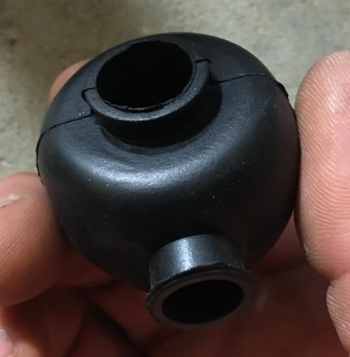

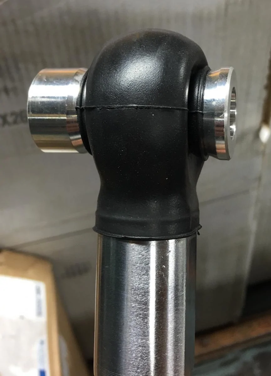

Get the boots.
Their a bitch to put on but it's worth it. They come is all sizes.

Before

After

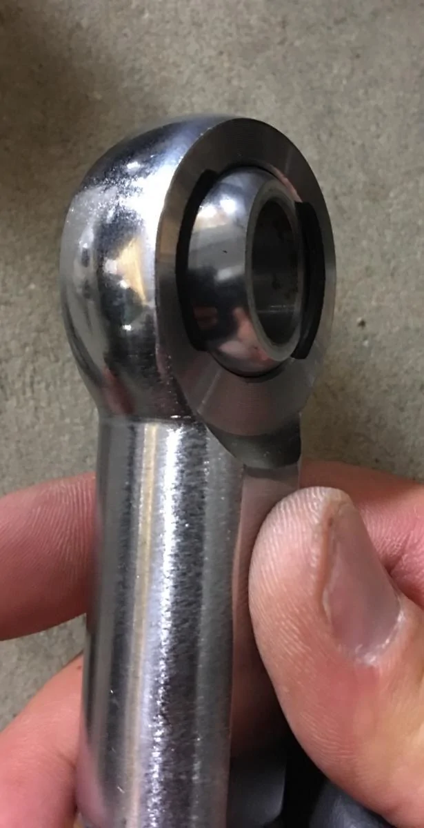

I have cortex LCA bearings on the front and rear control arms. I bought these seal-it boots last winter. I can't remember what size I bought. Measure the arm width where the bearing goes in. Go slightly smaller when you order. These fking things go on like a bitch. If I remember right I bought part # RERS3. Summit and jegs sell them. Also.

Without a boot the bearing will wear out faster, no matter how big it is. A larger bearing allows for more load rating. Road debri will take its toll on any exposed bearing.

You guys have boots for your LCA bearings? They're so massive I'm not sure how it would work:
