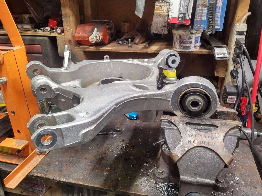

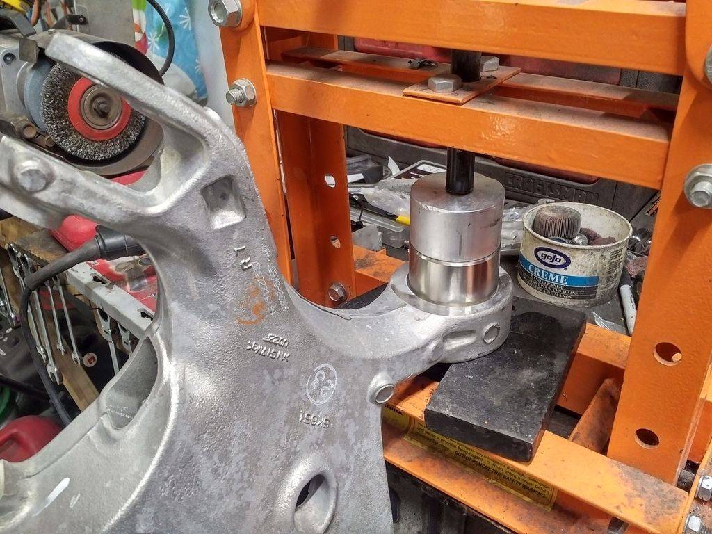

With the included tool from Steeda, I could of pressed the bushings out, but it was taking a scary amount of force and I was worried I was going to distort the A-Arms.

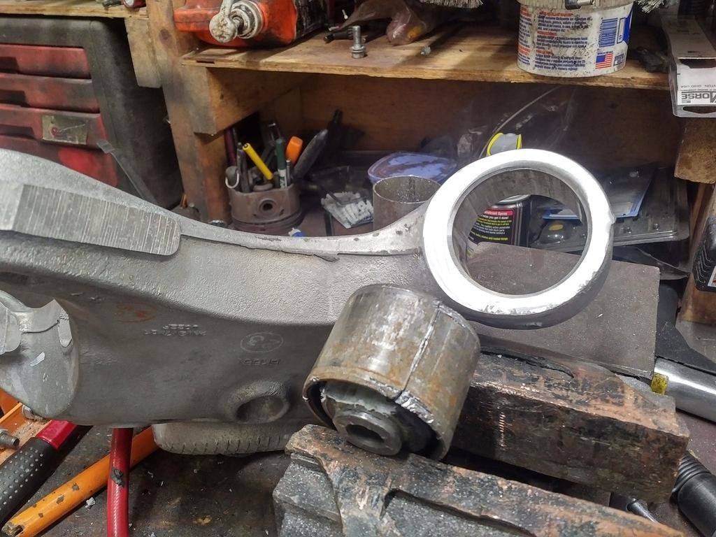

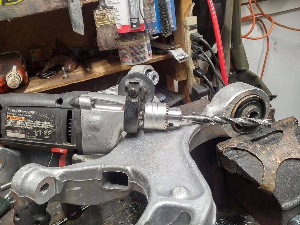

So I decided t take some pressure off First. I took a half inch drill bit and drill three holes in the bushing next to each other

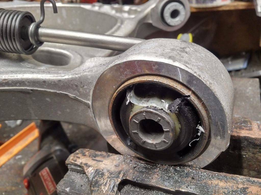

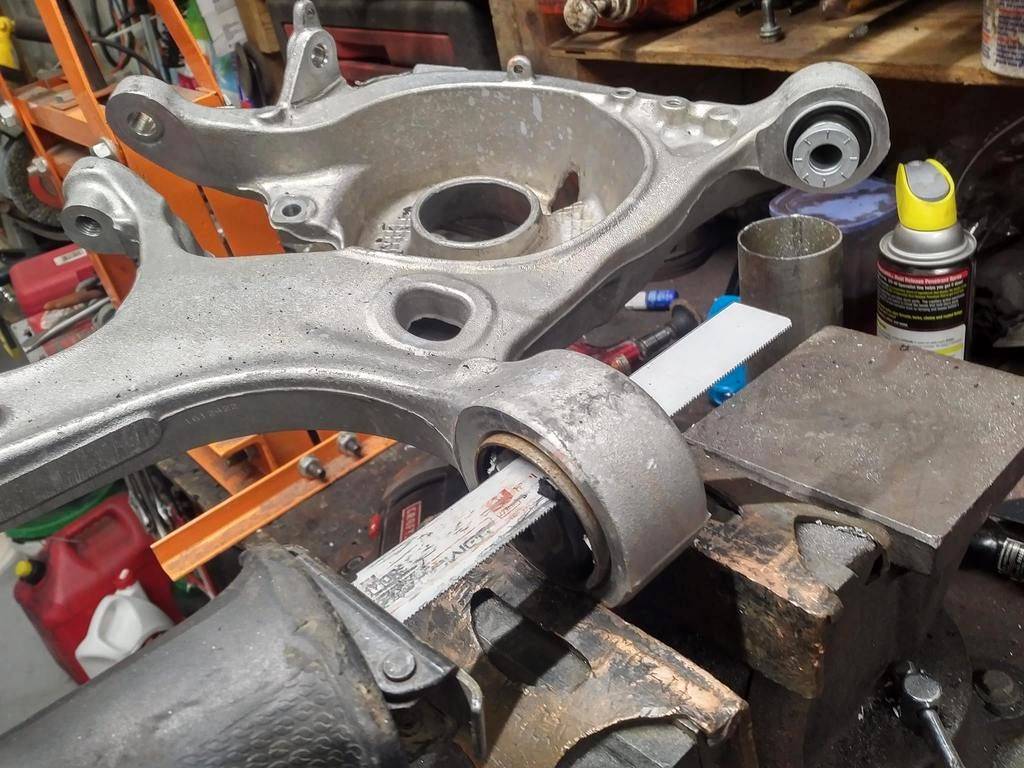

Then I took a nice sawzall blade and cut almost all the way through the metal shell but stopped just short

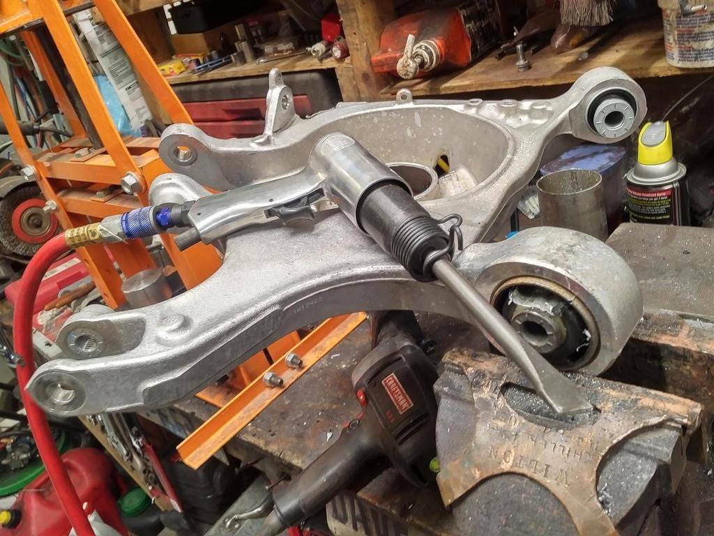

Then I took my air hammer and used it to snap the shell with a couple hits.

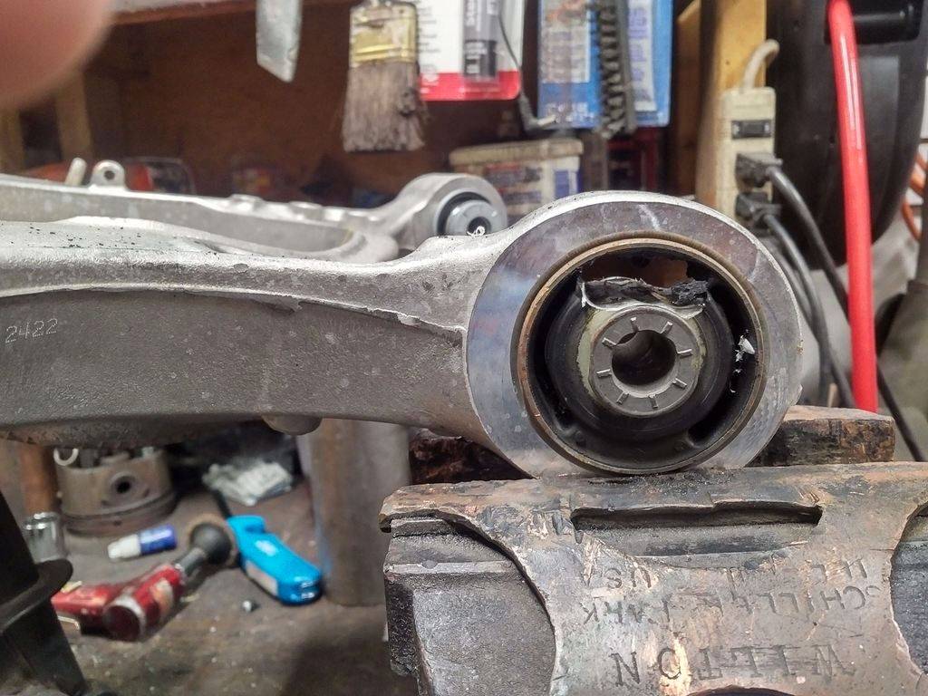

Then it was extremely easy to press out

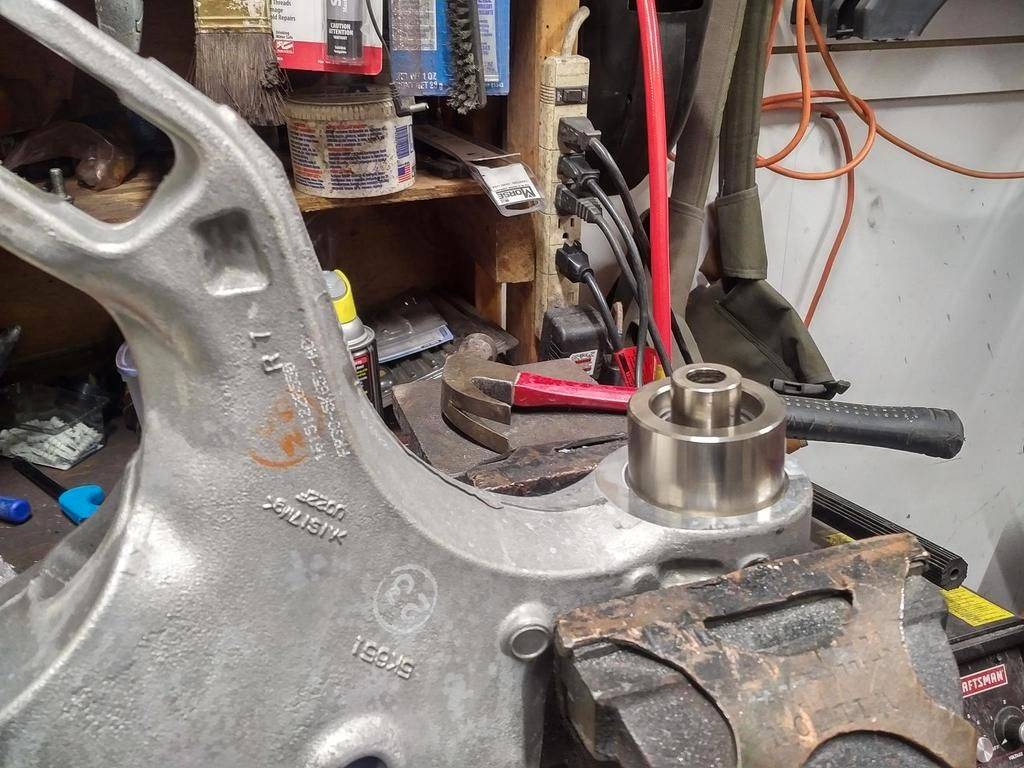

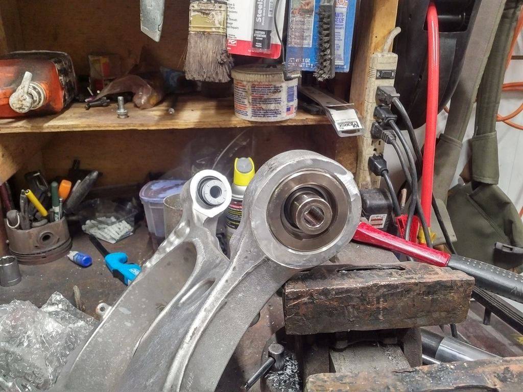

The new bearings go in without much of a fight. It helps to start them first with a couple of taps with a hammer

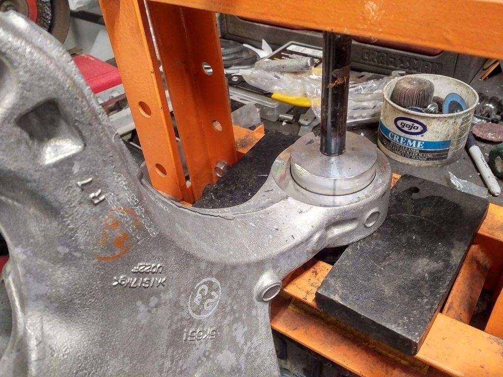

Then use the press to drive it home

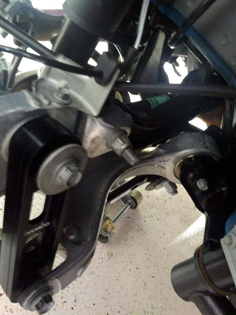

Here it is installed
