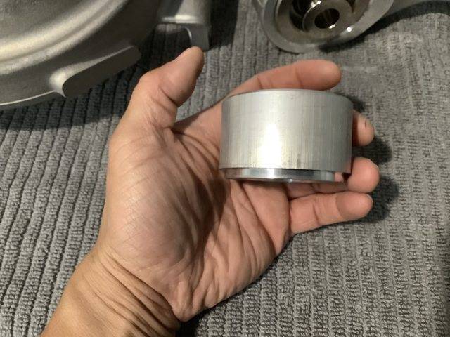

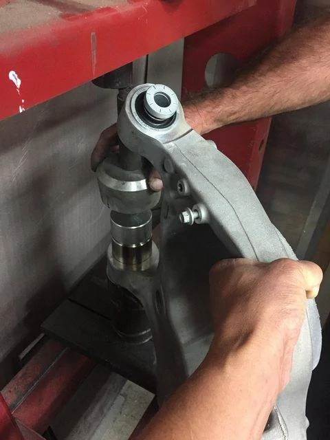

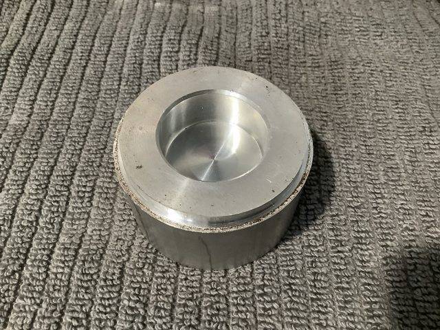

If you can get the bushings and sleeves out on your own, buy yourself a 20 ton hydraulic press and press the new ones in yourself. Here’s a pic of my buddy and me using his 20 ton press to install the new bearings. Pressing them in was easier than pressing the factory sleeve out. Note: My buddy turned down the aluminum press puck that Steeda supplied with the beadings, so that it fit precisely inside of the sleeve.
Steeda if you guys are reading this, this mod makes the press puck much easier to use.
