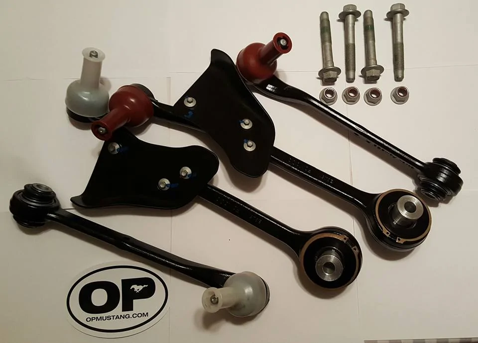

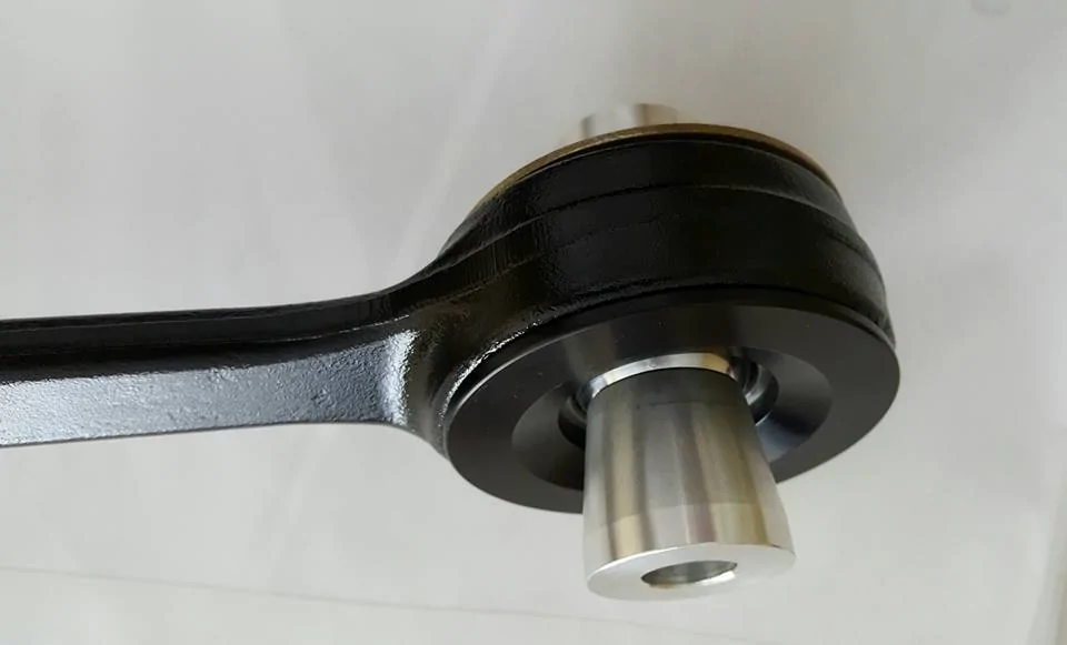

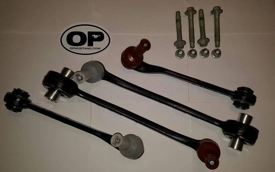

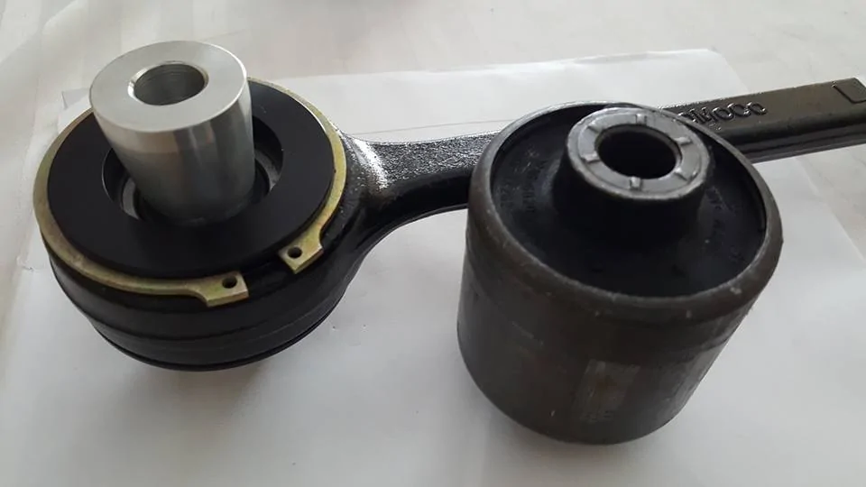

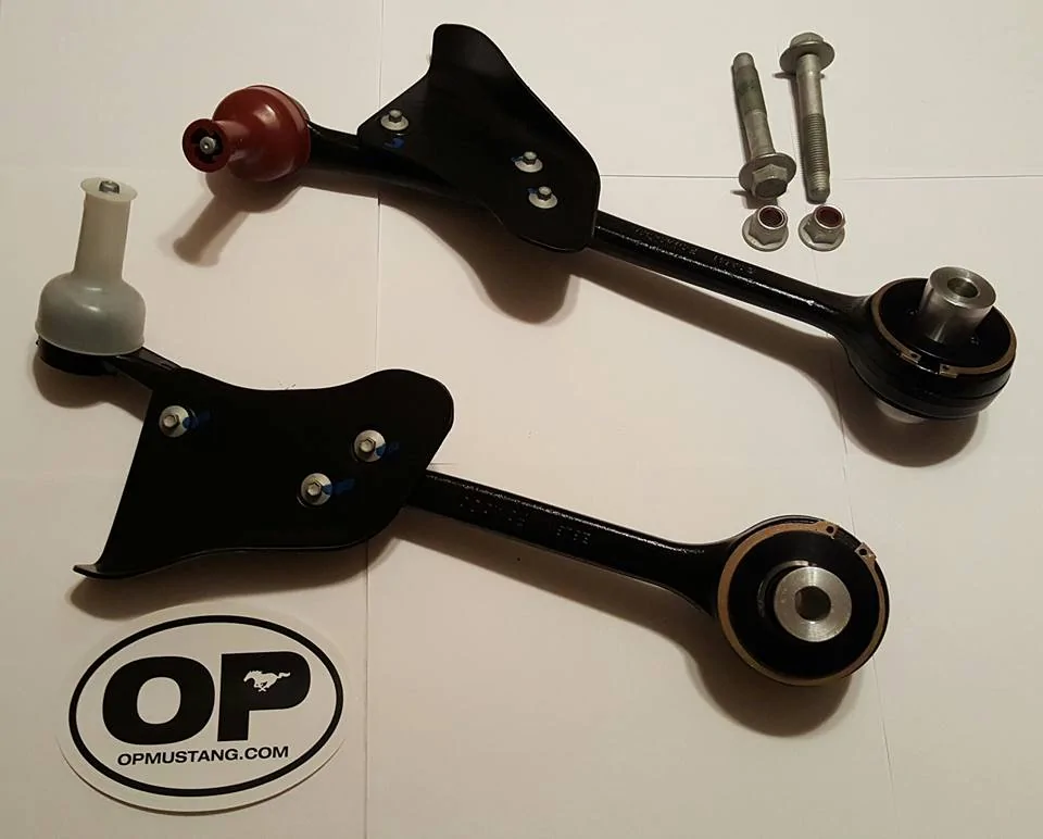

I can understand why other suppliers do not offer a bolt in solution. We currently have about $10K worth of Ford parts on B/O dating back to June. Ford is back logged on very basic parts (like bolts) for months.
We use the [MENTION=12802]Hotpart.com[/MENTION] J&M bearing due to the quality of the assembly. They use a higher load capacity bearing (Sourced from one of the largest US Manufacturers) at a price point that allows us to pre-assemble them as a plug-n-play product.
We designed special tooling to assemble these due to the high press fit of the OEM bushing.
