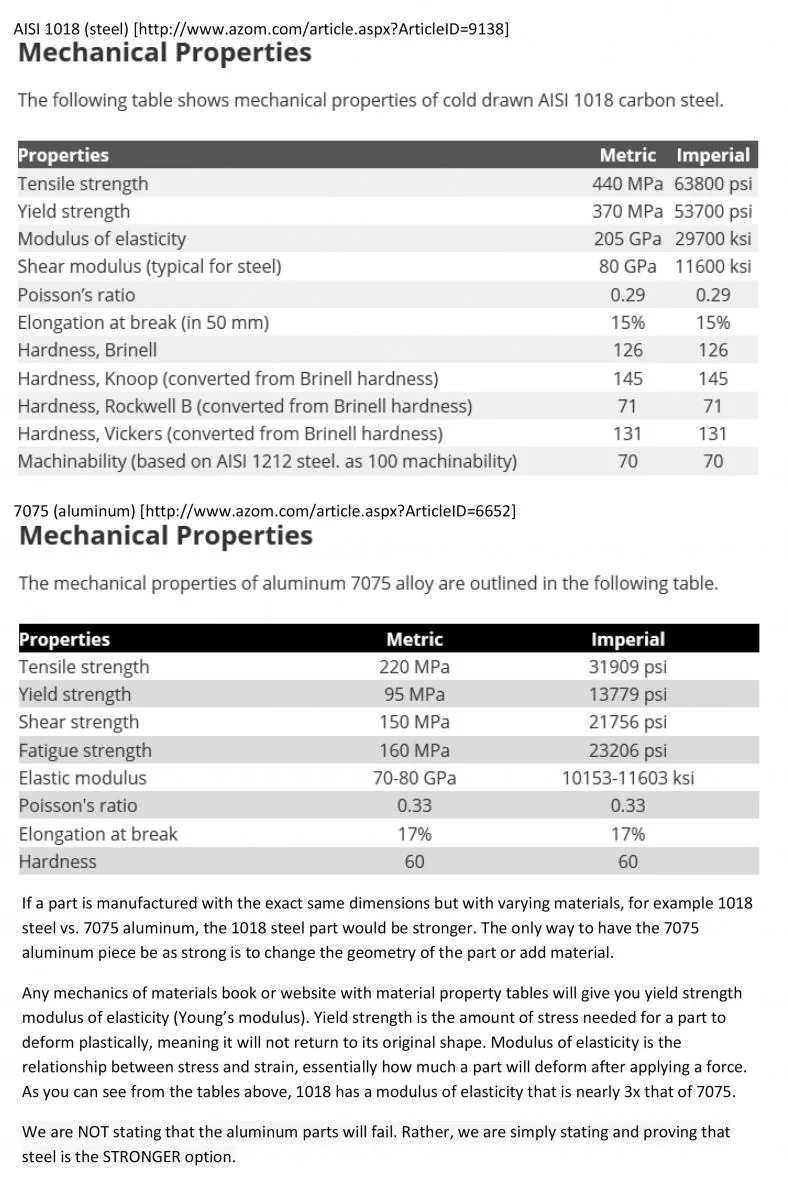

Please see attached.
Again, we use 7075-T6.
Curious - do you assist with development and testing of your product?
I agree with [MENTION=7033]Voodoo[/MENTION] about this stuff being moot....but I'm not going to sit and let my competitor make false and inaccurate claims when our product is involved.
