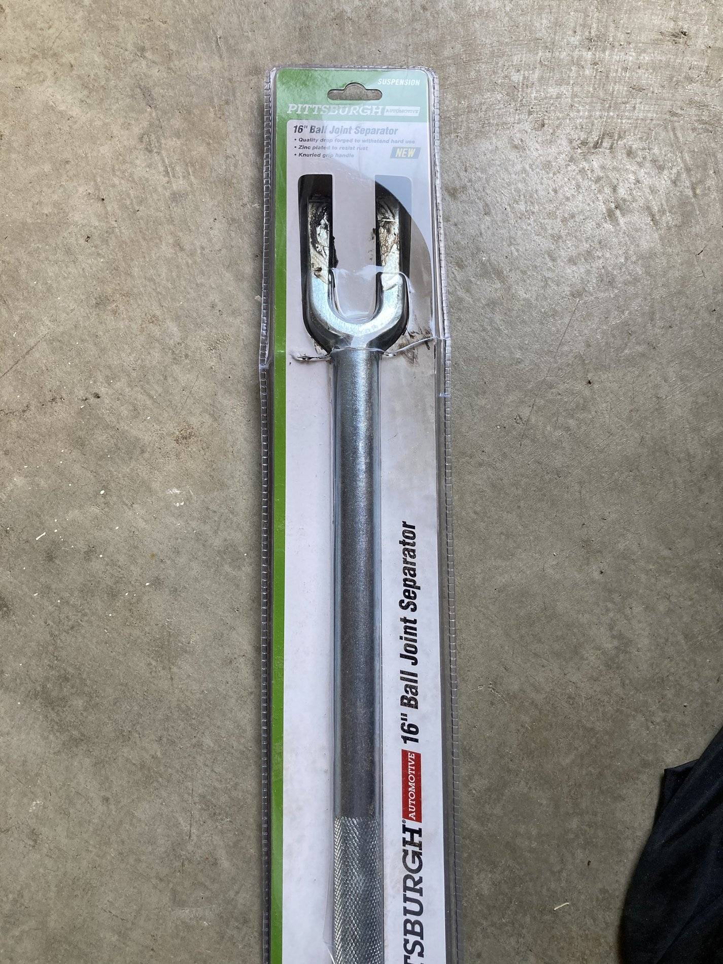

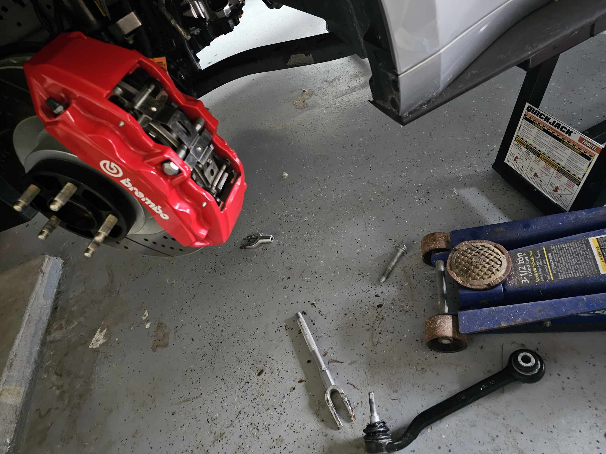

Old thread I know but same issue. I installed the FP MagnaRide Handling Pack. Afterward I was left with a floating disconnected steering feel and realized I needed the bumpsteer and lateral link kit which I got from Steeda. After spending several hours banging away at the knuckle with a hammer then a fork and air hammer, I really take issue, nay, umbrage to the videos posted by the likes of Steeda or CJ Pony Parts that shows mechanics hitting the knuckle a few times then the ball joint magickly separating. Horse hocky...buffalo bagels...I too had to resort to using the ball joint fork and a jack to get it to separate.
Same situation. Took a few hours to get both both ball joints off. Will do the other side tomorrow. Maybe they have a trick to make it easier to pop off? I don't know.

I ended up buying the unicorn tool Ford specs in the manual. Took 2 minutes to separate it.

Here is my experience:
Bottom Line, @kz was exactly right ,Eazy-Peazy with the right tool.
@kz was kind enough to measure the distance between the forks of his "unicorn tool", 1.26"
The reason I was interested is that I needed to remove both the Steering arm ball joint for the bump steer kit and the Lateral link ball joint for roll center adjustment on a lowered car. The Steering link ball joint needed a minimum of 1.1" wide fork (max of 1.4") to get around that ball joint but the lateral link is larger and needs a min of 1.44" span.
Some tools on line give that dimension, others don't.
Freedom Racing sells the "unicorn tool" for $200 plus, they have an non-OEM version for $139. I spoke with the Freedom racing people, Super friendly, helpful and accessible.
That being said, other options that should work:
Astro tools, 78912, 1.28" fork opening, several seller between $40 and $50
SPO Racing rts 25112, 1.34" fork opening
I purchased the SPO Racing rts for $50 shipped, 2-day. ($41+ tax & Ship) On the Lateral link, the stud is a little taller so I had to take the "foot" off the tool under which is a small ball. I needed to drill a concave surface in the top of the lateral link stud to prevent the tool from slipping off under high torque pressure. The Steering arm ball joint stud already has a bit of a concave surface on the tip of the stud, so no issue there.
Then, Just crank down on that tool till its almost too hard to crank, then begin tapping on the outer steel housing of the ball joint, nothing crazy, I used a 4 lb hand-held sledge. Be patient, keep tapping and BANG! it explodes off. Leave the nut on the very top to limit the arm travel as it removes itself from the ball joint socket.
The problem with the HF tool @thornclaw posted, which I have, is the fork is too narrow ( mine is about .75") and also, it doesn't open enough to used on these 2 mentioned ball joints, even after I took my grinder to the tool pretty extensively.
I hope this is helpful, I've always been a little intimidated getting ball joints off without causing other damage. Never comfortable swinging a sledge at my suspension. Clearly, its all about having the right tool. (AS ALWAYS)
