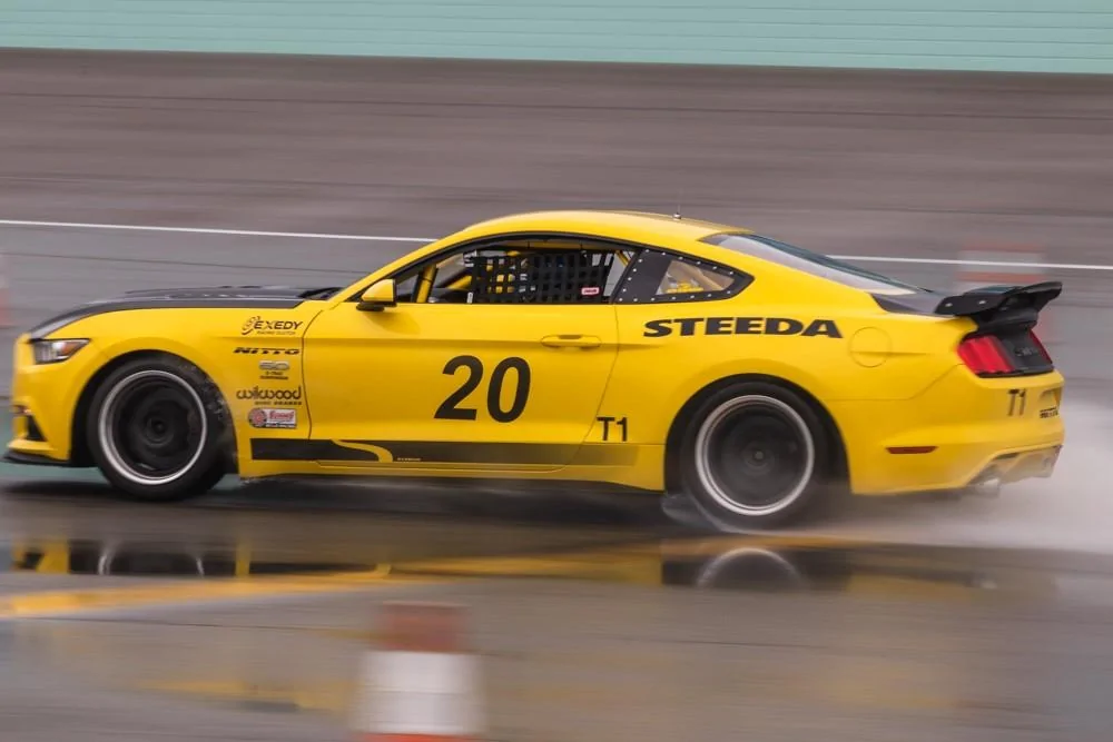

Finished 2nd first race and Won the last race! All done in the rain. The last race was a nail biter! The M3 BMW was fast, lots of great driving between them! The victory was only half of a second! Steeda NT01 equipped. BMW M3 Hoosier rain tires.
Steeda is leading in SARRC points!
