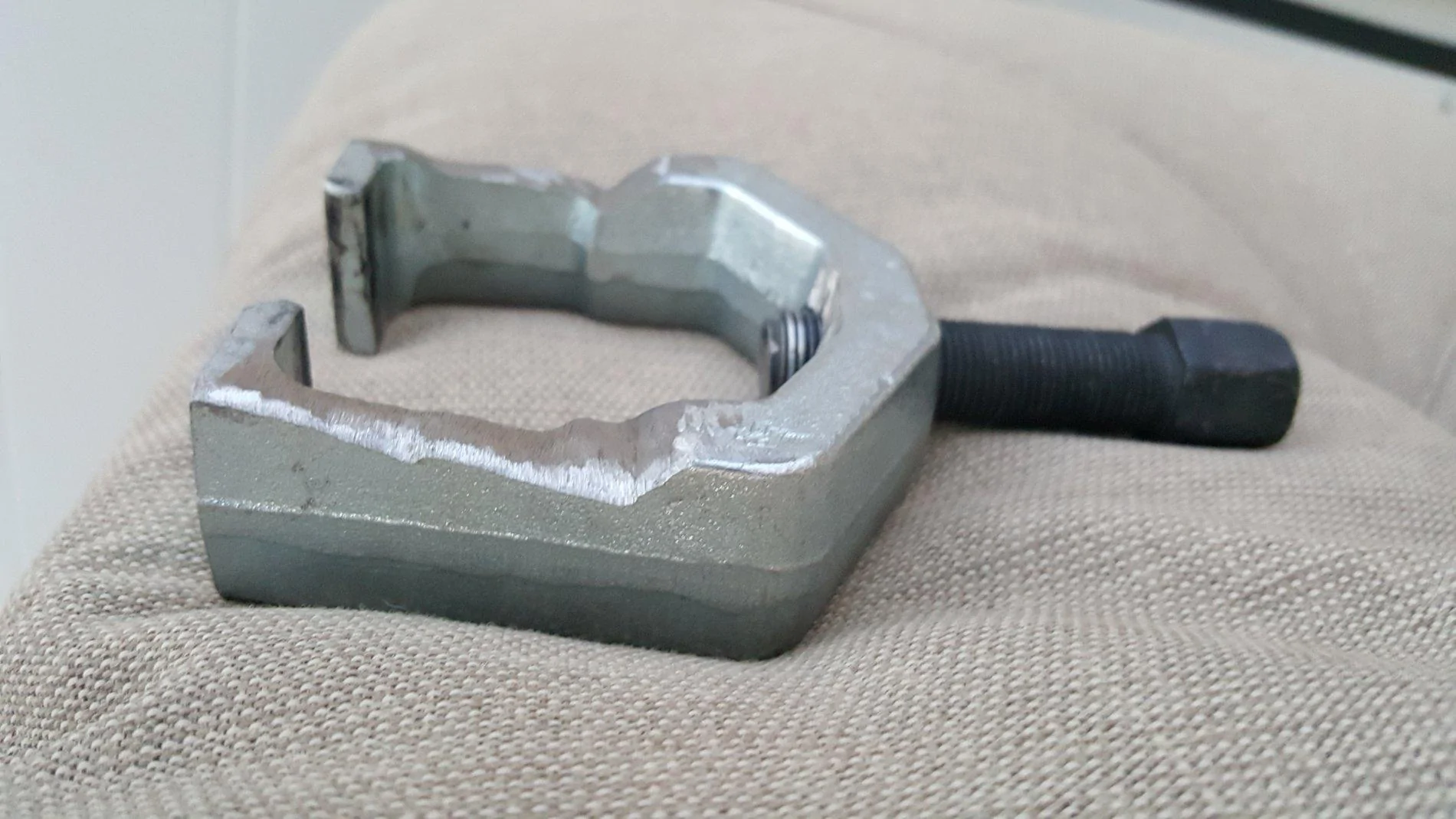

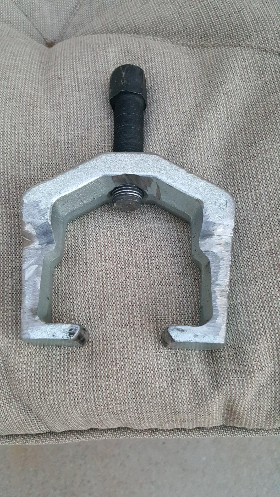

I shortened the bolt on the puller slightly by grinding off the nipple and test fitting it on the car. Keep in mind the surface of that bolt on the puller needs to be as flat as possible since the nipple is removed it makes it more prone to slipping off the stud as you tighten. I felt that was easier than trying to shorten the lateral link stud.

It looks like you also had to grind down not only the bolt, but also the casting.

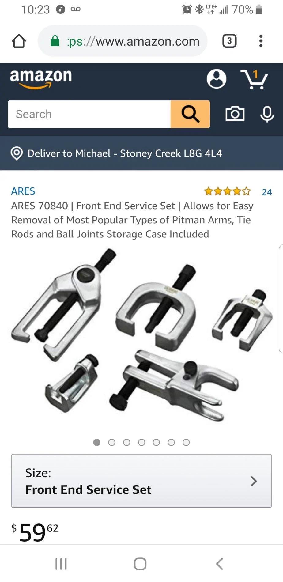

You can get Kits on amazon for pretty cheap. Even cheaper If you know the exact size you need as you can also buy them individually.
Here's the kit
