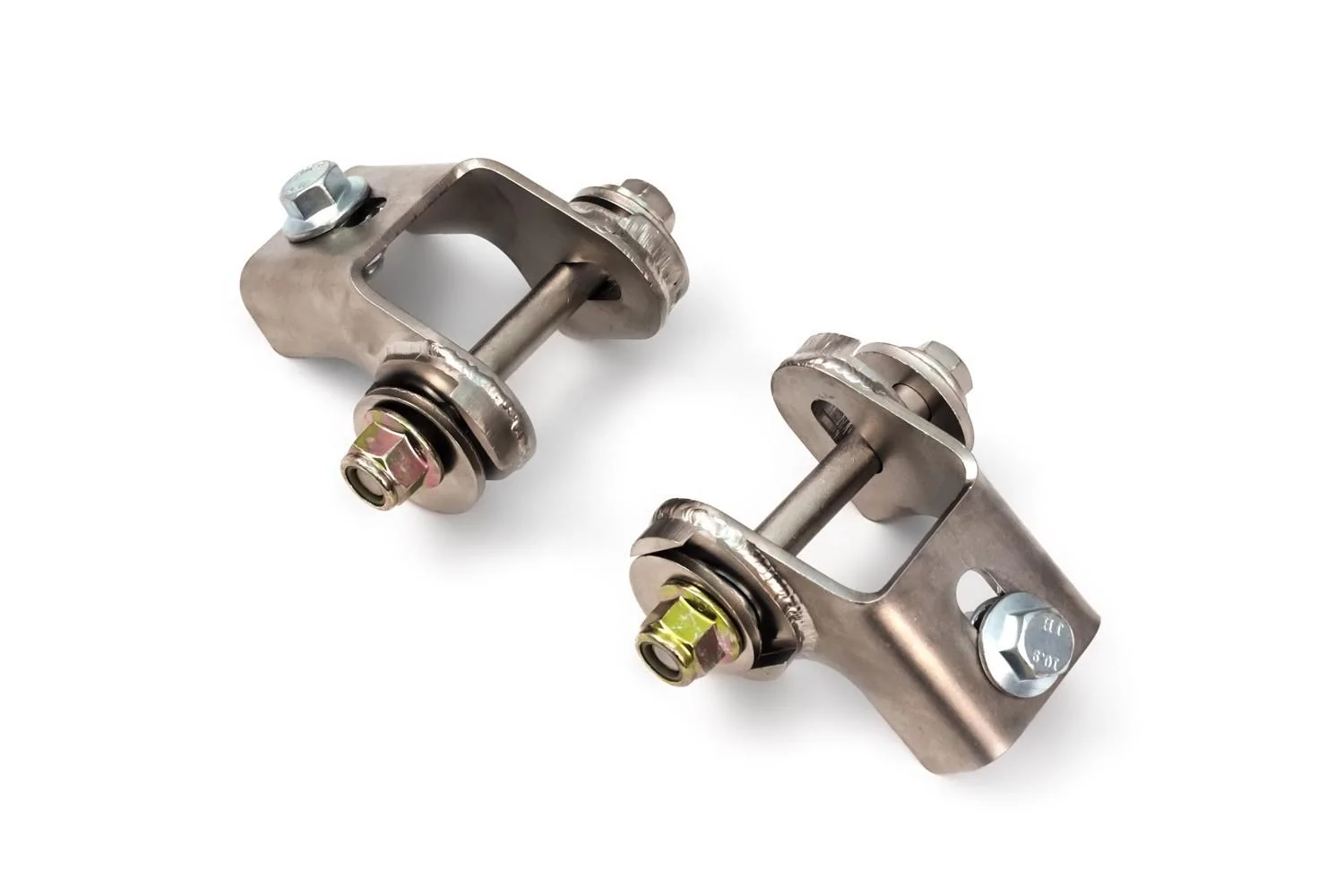

Same. This is what I want as well. The same as the PP lateral/tension link with the roll center adjustment.
I don't have bumpsteer so I don't need the extended ball studs. But I don't see steeda offering a PP equivalent lateral link for us base suspension guys.
Tension link with bushing + roll center correction
Lateral link with PP bearing and regular length ball studs
Any chance of steeda offering something like this? It would be perfect for base suspension guys and people without bumpsteer.
Same as the PP arms but with roll center correction added to the tension link.
The website has been updated to further detail what each component entails. I am not sure I fully understand what you are looking for, but I will answer each of your statements to try and clarify.
“I don't have bumpsteer so I don't need the extended ball studs. But I don't see steeda offering a PP equivalent lateral link for us base suspension guys.” – All vehicles have bumpsteer, it just becomes more noticeable after lowering it.
“Tension link with bushing + roll center correction” – We offer the tension link with bushings, but not with roll center correction. In our analysis, we found that the tension link had minimal effect on the roll center versus the lateral link. Is there a particular reason you want roll center correction on the tension link and not on the lateral link?
“Lateral link with PP bearing and regular length ball studs” – We offer the lateral link with the PP bearing, but not with regular studs. Our intent for these parts was to market them to lowered vehicles that needed the roll center correction.
“Any chance of steeda offering something like this? It would be perfect for base suspension guys and people without bumpsteer.” – We will certainly take this under advisement.

Some of my questions stemmed from the descriptions on the steeda site. I thought the tension + lateral link both had roll center correction.
I now understand that it's just the lateral link that has roll center correction & the raised ball stud.
I think I've got all my ducks in a row now.

Great, glad we were able to clarify.
