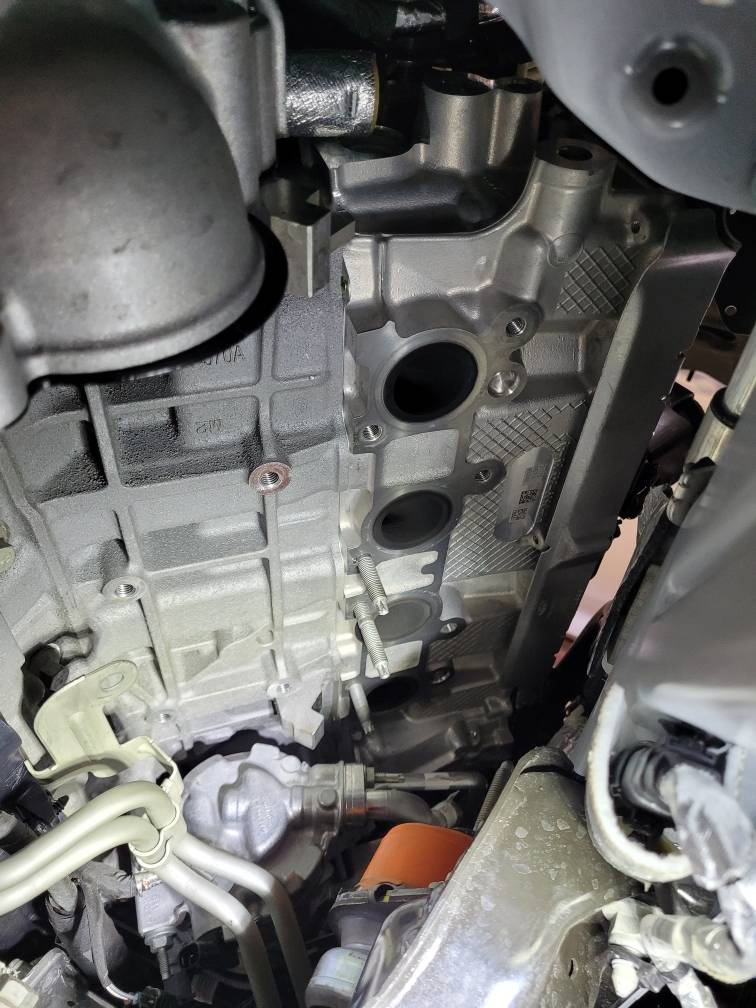

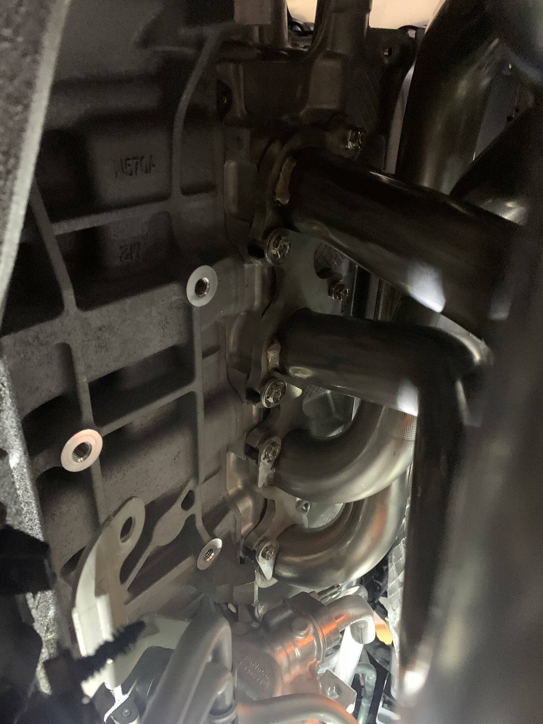

I did forget to get the stud above the AC compressor I did have to double nut the stud and remove it that way

Started about 10 this morning. 1 o’clock and the car is in the air and passenger side factory manifold is off. Gonna keep rocking.
I wanted to add that on our cars taking the under pans off makes this job much easier to complete!

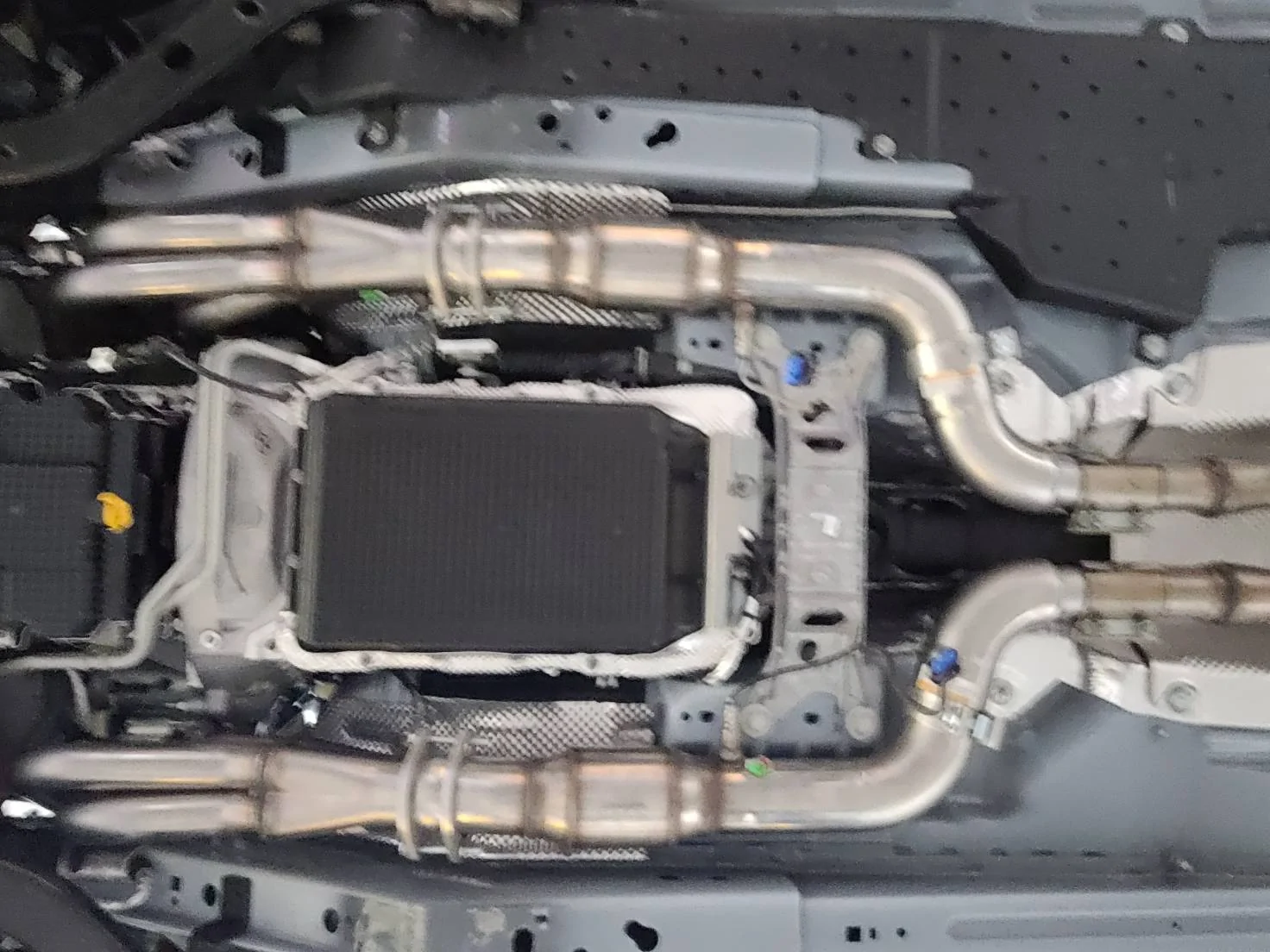

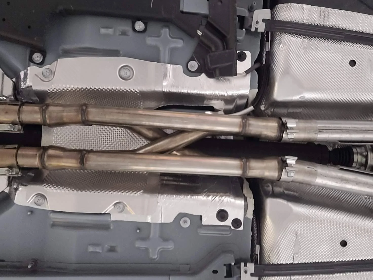

Also for you viewing pleasure, since I had all the underpinnings off it gave me a good chance to look at the coolers, I have attached some of those pics also.
