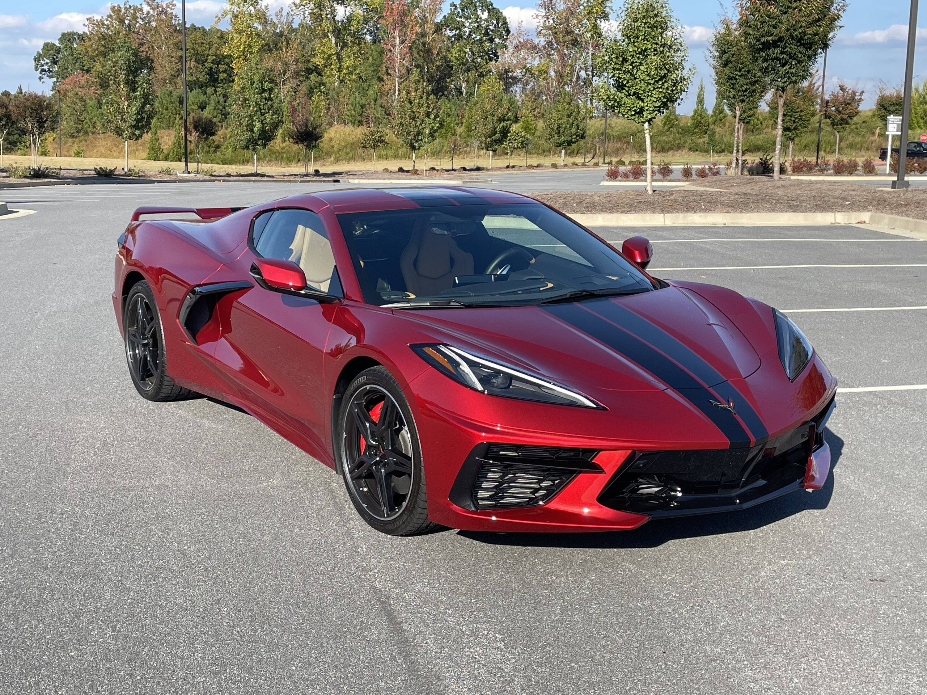

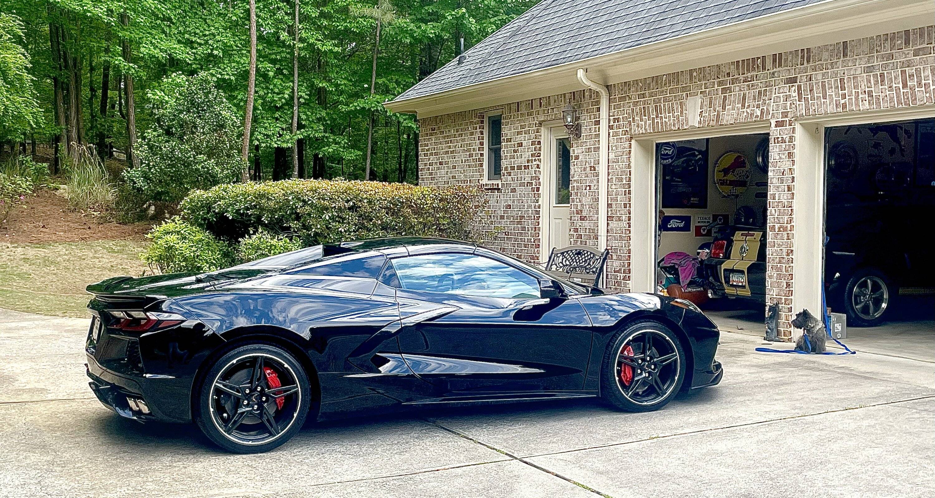

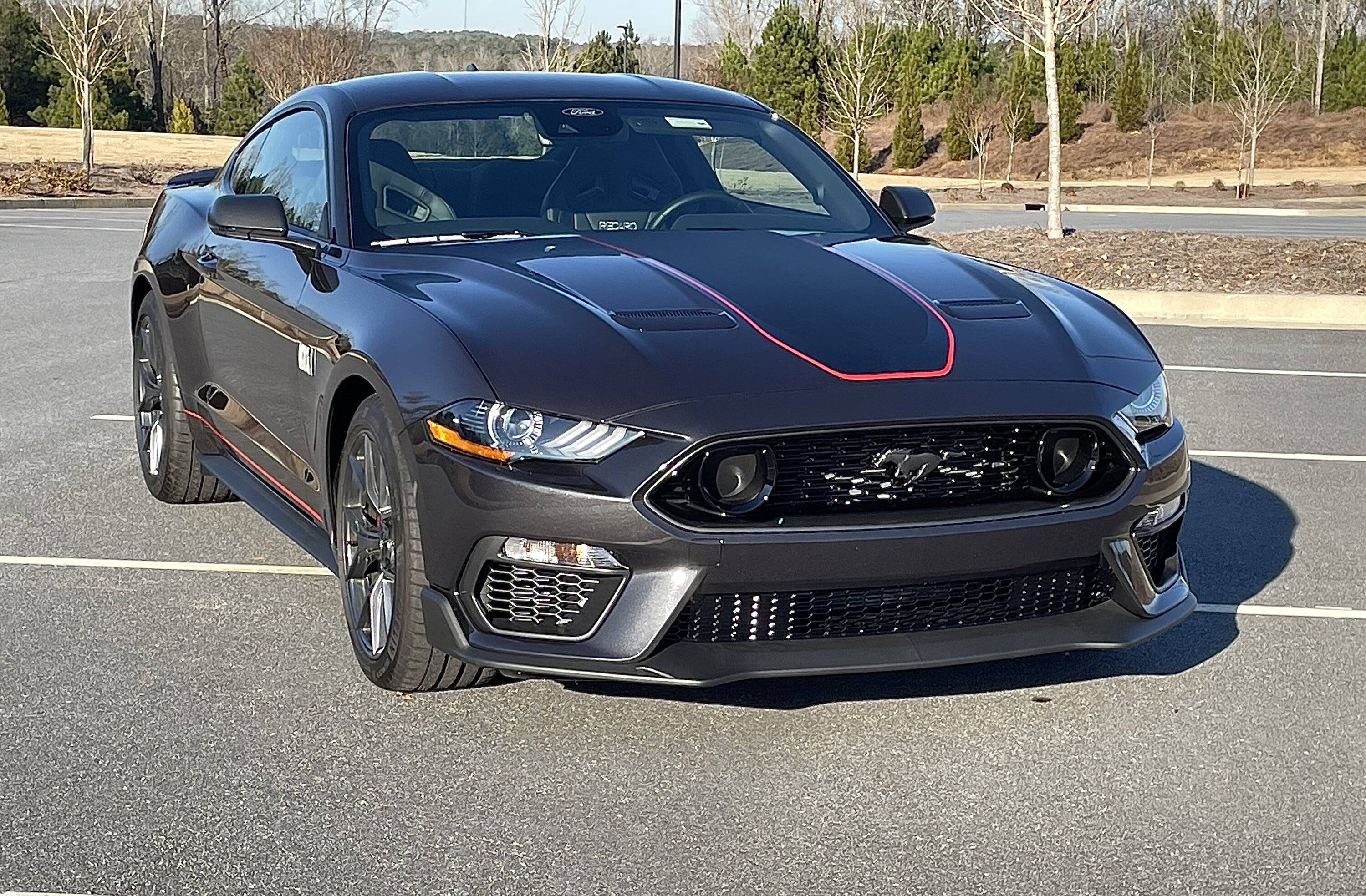

So I went from a 2022 coupe C8 to a 2022 mach 1. Manual. After 5 mouths I’m back in a 2023 C8 convertible. I really missed the driving feel of a mid engine car. These is nothing like it on the street. 0 to 60 under 3 seconds all day long. Instant torque and throttle response from that small block. Seat of the pants feel is amazing.
One thing lacking in the C8 coupe even with the performance exhaust is the sound in the cabin. The convertible has a rear window that rolls down and the exhaust is much louder . Problem solved . Not as loud as the mach 1 however. But if you want really loud get yourself a 20/22 GT 500. OMG it sounds like a old school big block at idle. 👍🏻👍🏻👍🏻
However on the expressway it can get a bit loose @ WOT. Let off or you will scare the hell out of yourself and the driver in the next lane. Buyer beware it’s a lot of power for the average driver.
