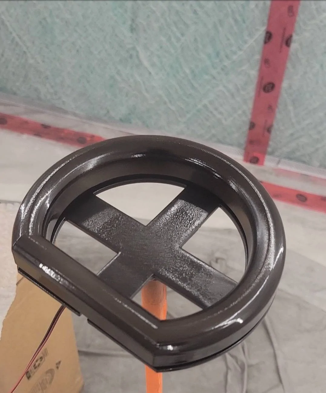

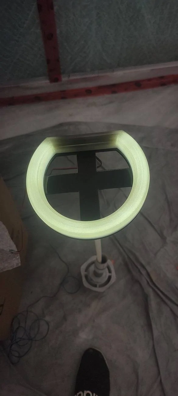

I'm doing some 3d printing and making my own smoked out style fogs that will work on any car, and lights will be able to change color as well!
