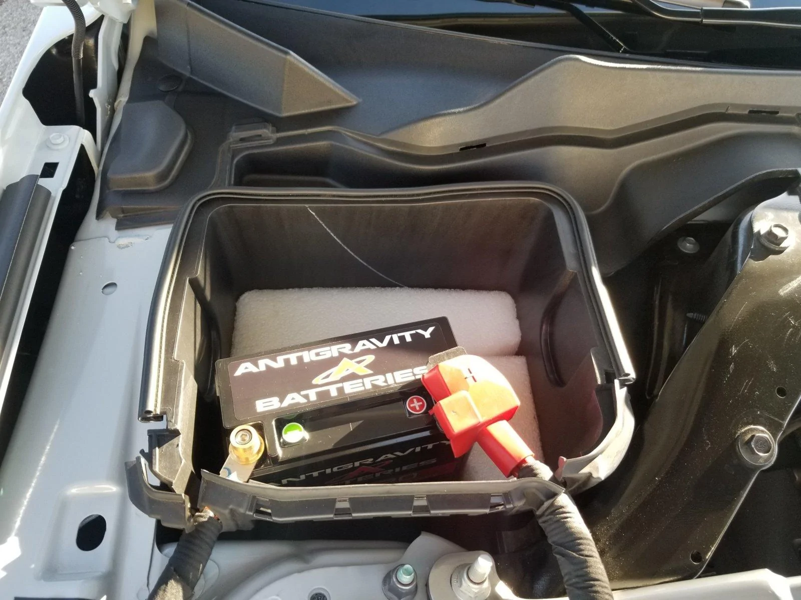

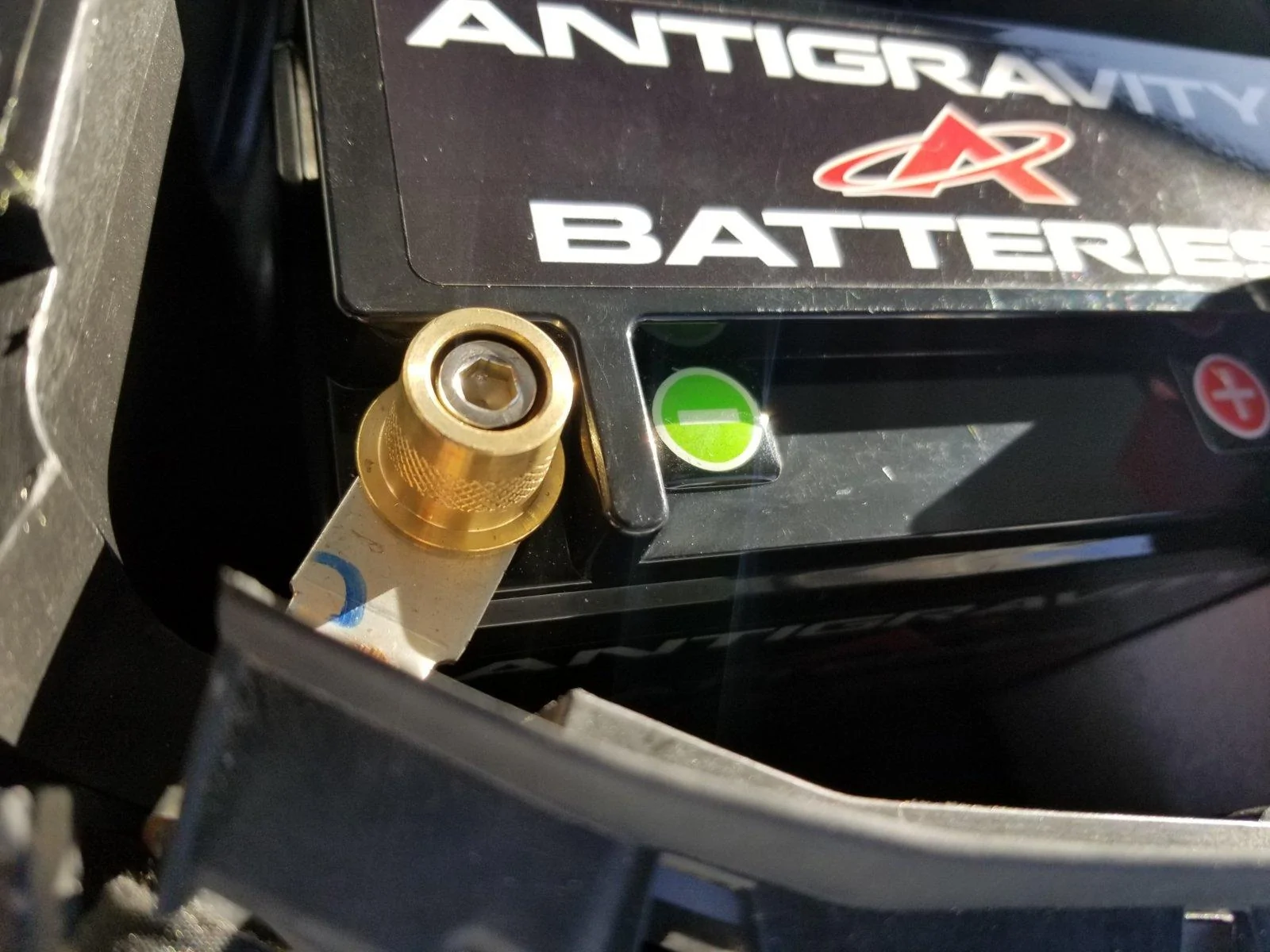

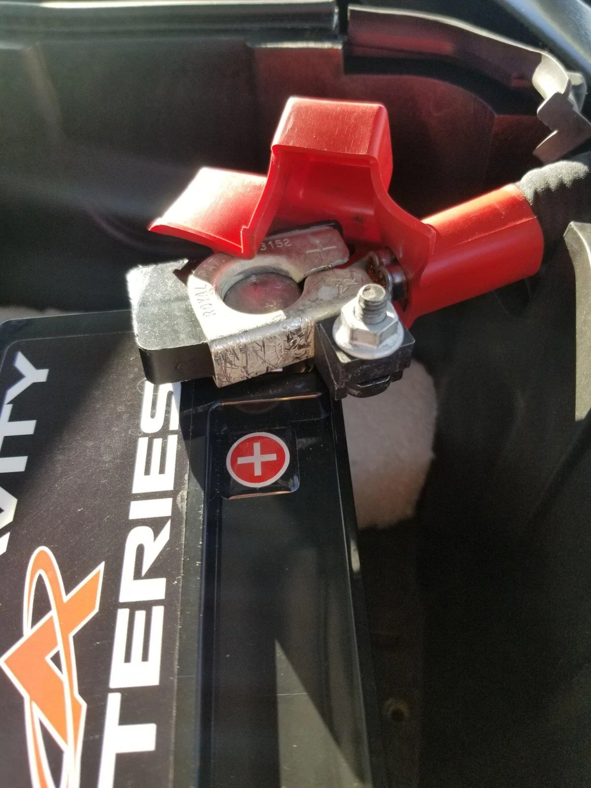

I finally ordered the Antigravity ATX-20. WOW!!!! My original battery was on its last leg so it was time to replace. My old almost unusable battery weighed in at 27lbs. the AG ATX-20??? 4.8 LBS!!!!!
YUP!!! Its awesome. I did not order the proprietary terminals but made it work. Used tool box foam (chem resistant) cut to shape and wedged around the battery to keep it from moving. Will load pictures soon. My car sits regularly and is driven at least once a week with the occasional two week stints off due to weather or work. No problems whats so ever. The most notable improvement is how quickly the car starts!!!! Man this lil battery has some starting power!!! Second most notable, at least to me, was the weight. With very spirited driving and track app tests, the weight reduction was impressive. Even more of a reason for me to lose 10 lbs LOL.
Make sure to due as Demonic has mentioned and all should be good. Reset the battery monitoring through forskin ; ):cwl: etc. Have not had any charging issues thus far. Albeit it has only been a week and the car has been driven twice. This battery will be run in the R and our Champ car during competition. Best 400 bucks spent on the car.
Thanks to Antigravity and Demonic for all the help answering various questions in writing and over the phone:captain:

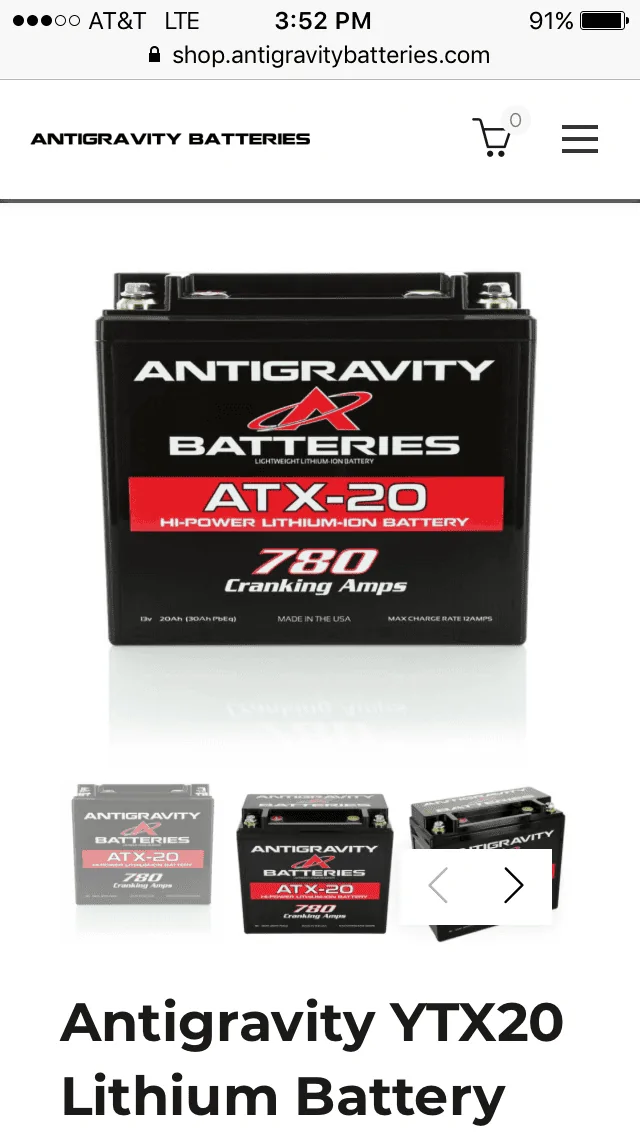

From what I see on the web site the restart is a ATX-20 and the non-restart is a YTX20 but the picture above the name YTX20 is of a ATX-20 without restart. Too bad the site is mess... I need to buy a new battery come spring does the "re-start" issue include the GT mustangs or just the GT350?
Zitrosounds
Oct 20, 2015
67
3,407
2,163
Madison, AL
Harold
16 GT350R/16 GT350TP/15 GT-PP/12 GT-PP
Go back to the site, https://shop.antigravitybatteries.com/?s=atx-20&post_type=product
YTX-20 is no longer. There are two ATX-20. AG-ATX20-RS (restart) and a non RS, AG-ATX20. You want the non restart. All S550 mustangs have the same smart charging system.
