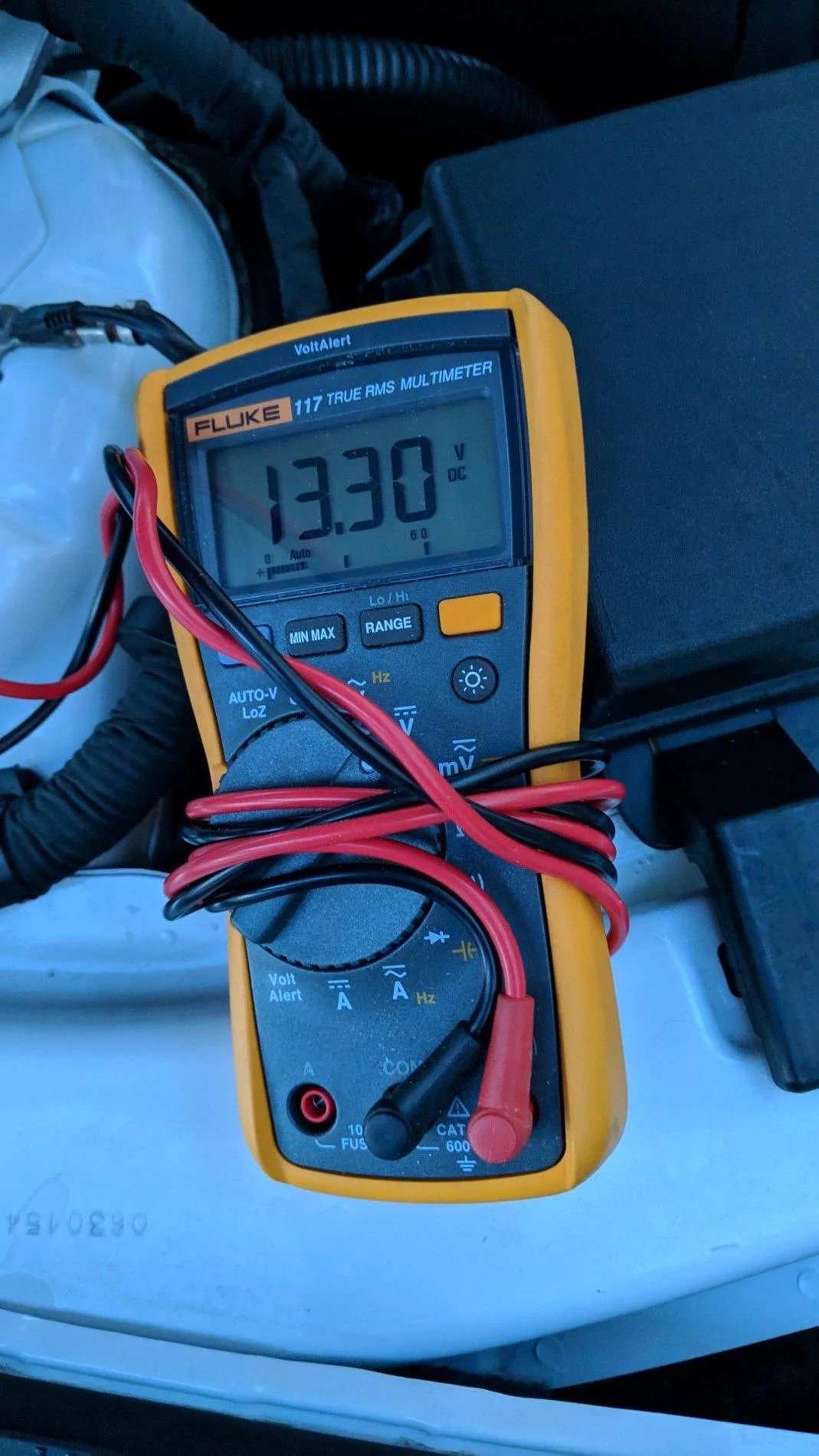

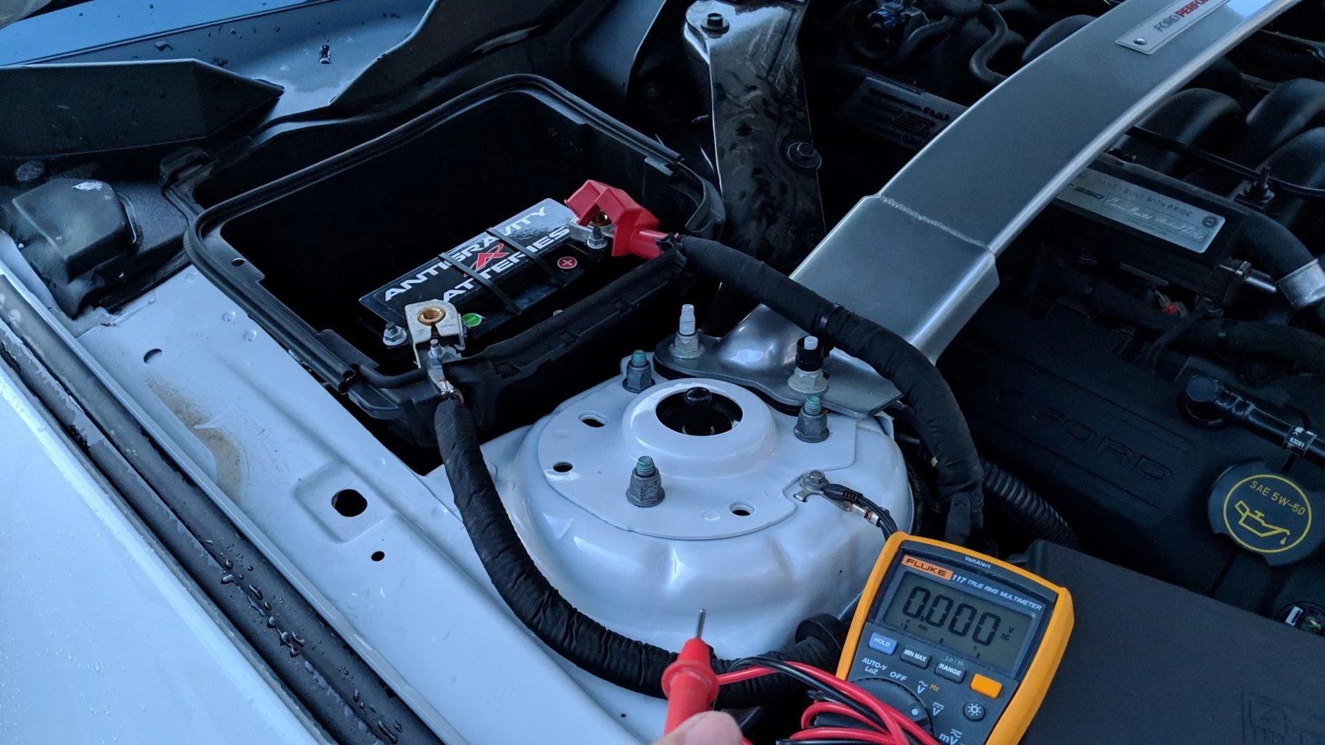

To follow up Demonic's suspected lower state of charge with the lithium batteries on the GT350s with the default smart charging lead acid battery profile, been finally driving the car with the YTX20 and recorded voltage three times on three separate days with the following parameters:
1. Waited 4-5 hrs after driving for the battery to self-balance
2. Approximately 45 degrees
3. Approximately 20 minutes of highway driving before voltage taken (my commute to work)
4. Taken with a Fluke 117 multi meter.
According to the Antigravity website:
After a few hours it will self-balance to the 13.3-7 range which is its normal state of charge
I recorded voltages of 13.25, 13.24, and 13.3.
According to Optimates Lithium State of Charge Tester:
This is approximately 60-70% charge.
I will do some thinking before I give the Ford GT Lithium Battery Profile a whirl... probably won't hurt anything to run the battery at 60-70%. Plenty of power to turn the car over with plenty to spare as multiple people have reported.

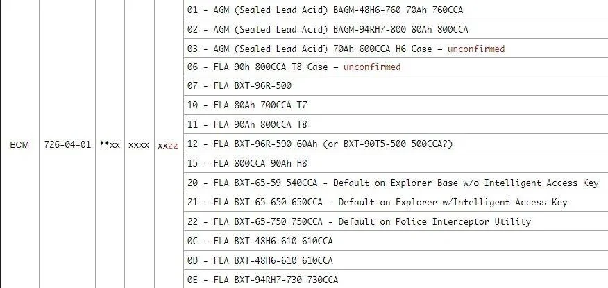

Oh nice! Didn't even think about how quickly it charges. But yup it's:
726-04-01 0502 0000
I pulled it from Jay Leno's GT VIN. My long winded write-up is here:
Just ordered Antigravity ATX-30 Lithium Battery
If it helps in your testing, my default smart charging battery profile was
726-04-01 1202 0000
And some identified battery codes from the F150 forum:
But thanks Demonic! Would love to hear the results of your testing.

Hah thanks. I had missed your post mentioning it. Now I can't help wondering if the actual Ford GT battery is a legit option too...
The table you posted from the F150 forum was the one I had found also and was referencing. My car stock was using the 0702 battery profile, and I didn't change it since the other profiles were for larger batteries anyway so I didn't see any benefit in changing it at the time.
