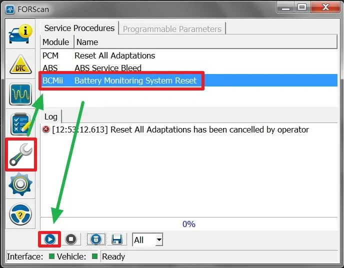

How do you do a "battery reset"?
You can either do it yourself with Forscan, or have a dealer use their Ford service computer to do it. Though some people have reported the dealer possibly looking at them with a blank stare. The ones that will do it will typically charge you their standard diagnostic computer fee.
In Forscan:
