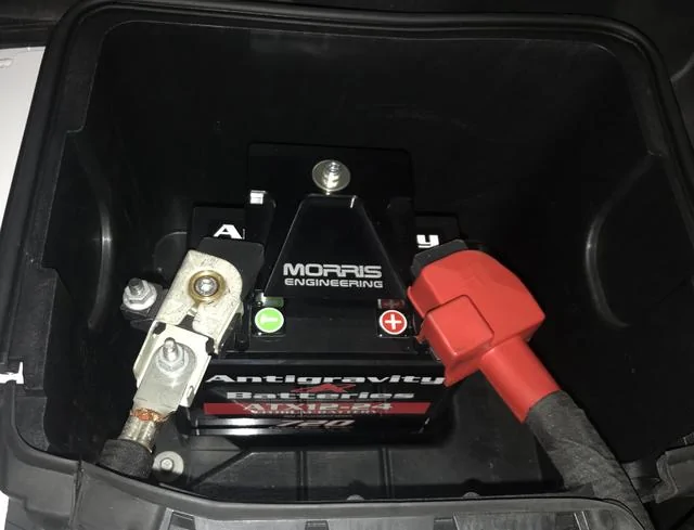

Has anyone removed the complete OEM battery box/ enclosure when installing the Morris Engineering mount? Seems like an obvious place to declutter and drop weight for a track car.
The Morris Engineering mount is made to fit into a recessed area of the battery box and includes specific hardware to adapt/mount to the OE battery box. In other words I don't think it would work without the OE box. While it may declutter you also lose the protection it provides. As far as weight it is negligible in savings if removed.

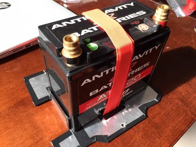

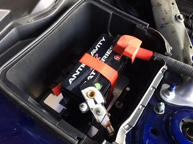

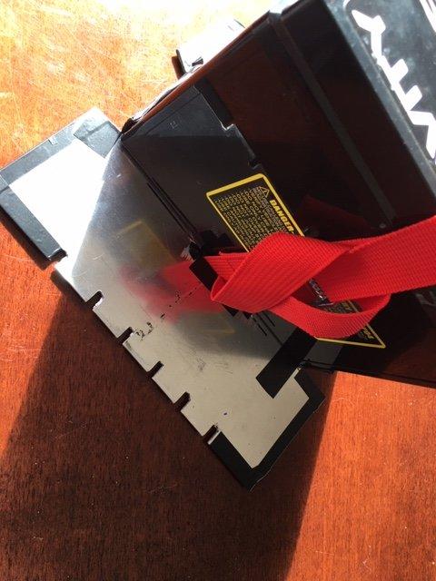

I just got finished installing my ATX-20 non-restart battery. I fabricated a tray out of rigid aluminium sheet. I'll make a better tray before I hit the track. Couple things I noticed and was wondering about...
1. Voltage is at 14v for about 30 seconds after I start up, then goes to about 13v. Then fluctuates between 12.5-13v. That's normal, right?
2. The Ford battery cable connections seem a tiny bit loose with the supplied Anti-Gravity posts. What other posts are recommended?
3. I plan on getting a Lithium Battery tender, but in the meantime when I disconnect the battery do I need to reset with Forscan each time I reconnect?
