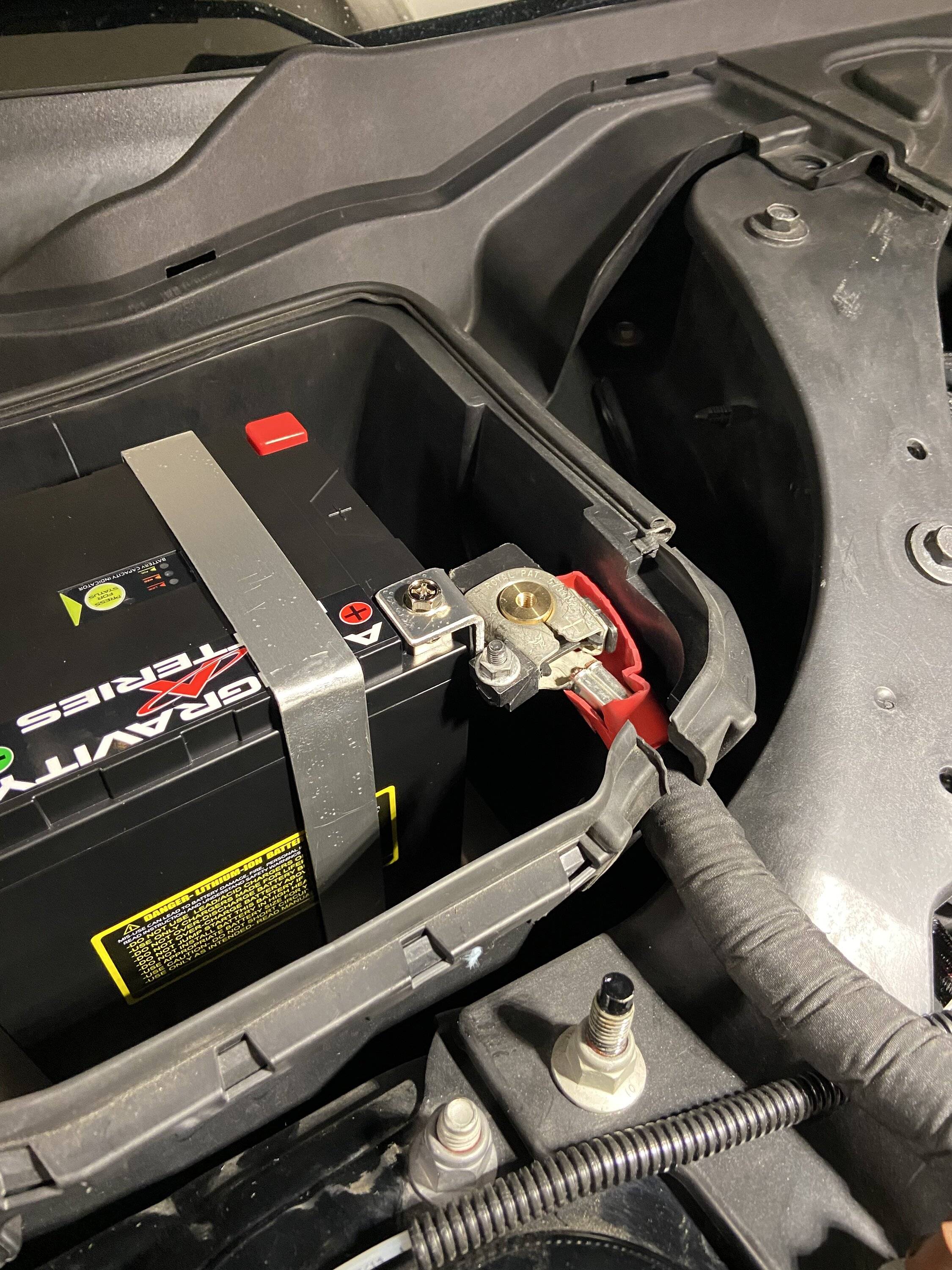

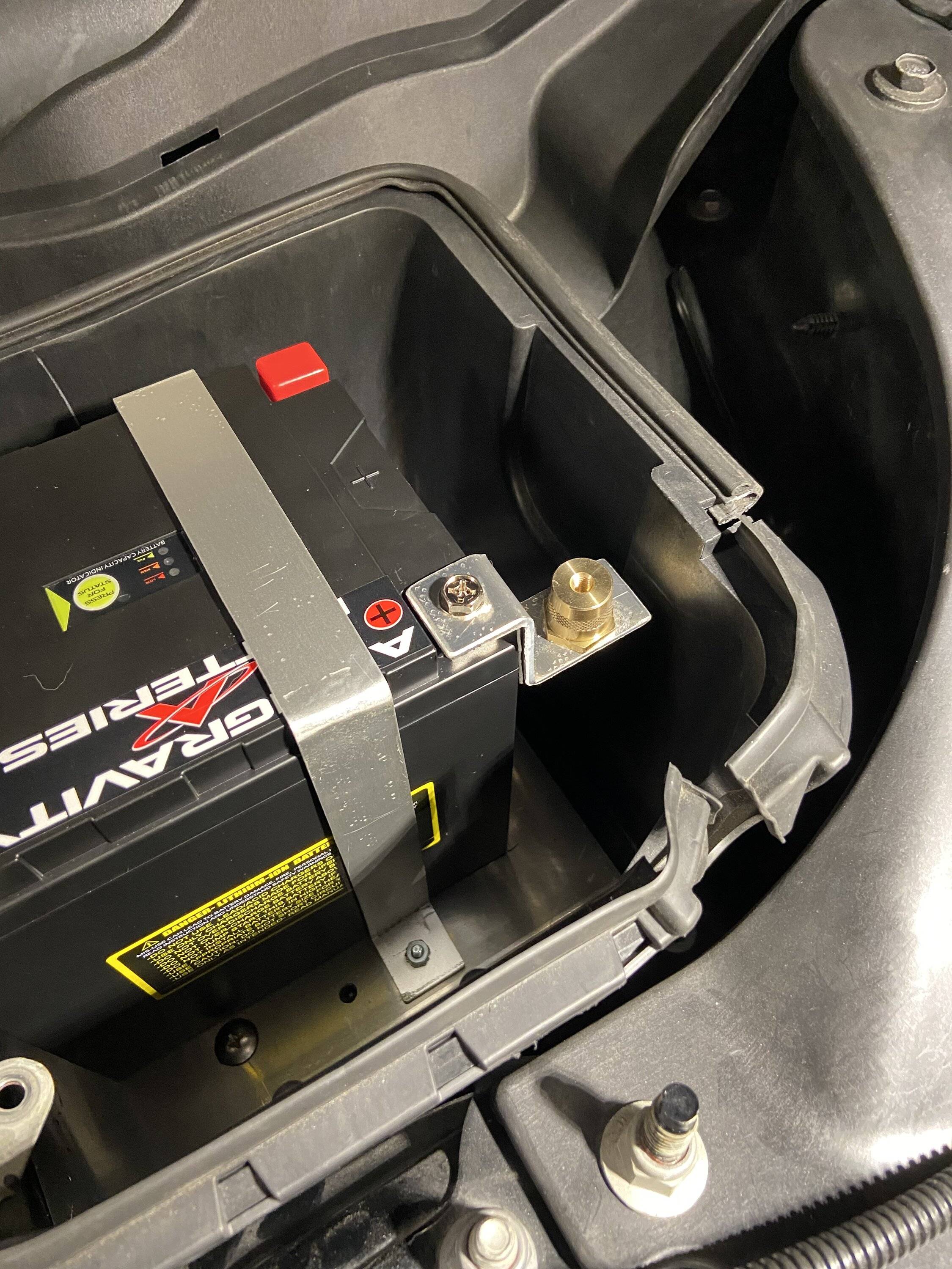

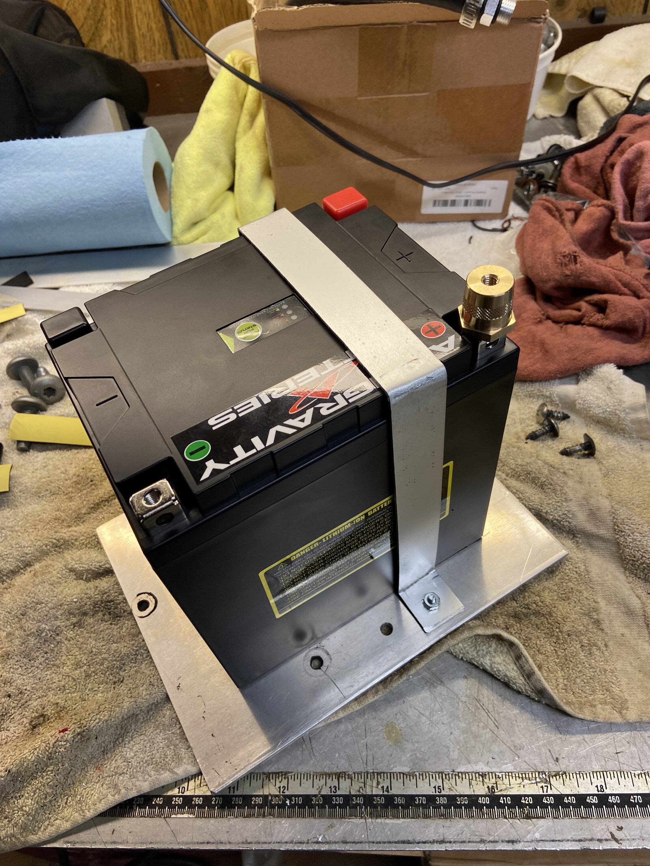

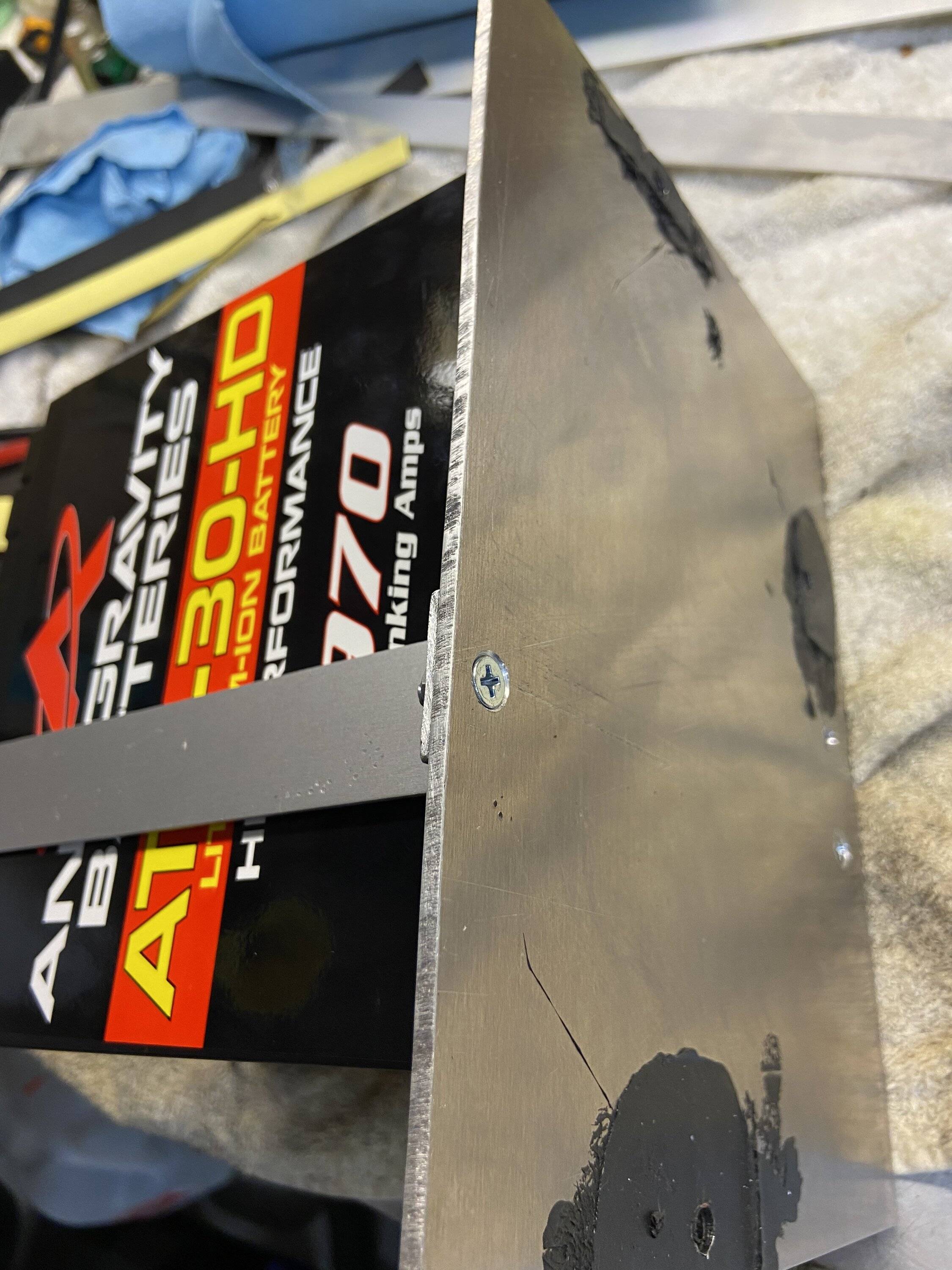

Battery (ATX-30HD) is in and going to be in the car overnight with a full charge. Made up an aluminum hold down for it, with an aluminum bottom sheet screwed in 4 places with RTV on the threads into bottom of the battery box. I’ll update after a few start/idle/drive cycles in the near future.

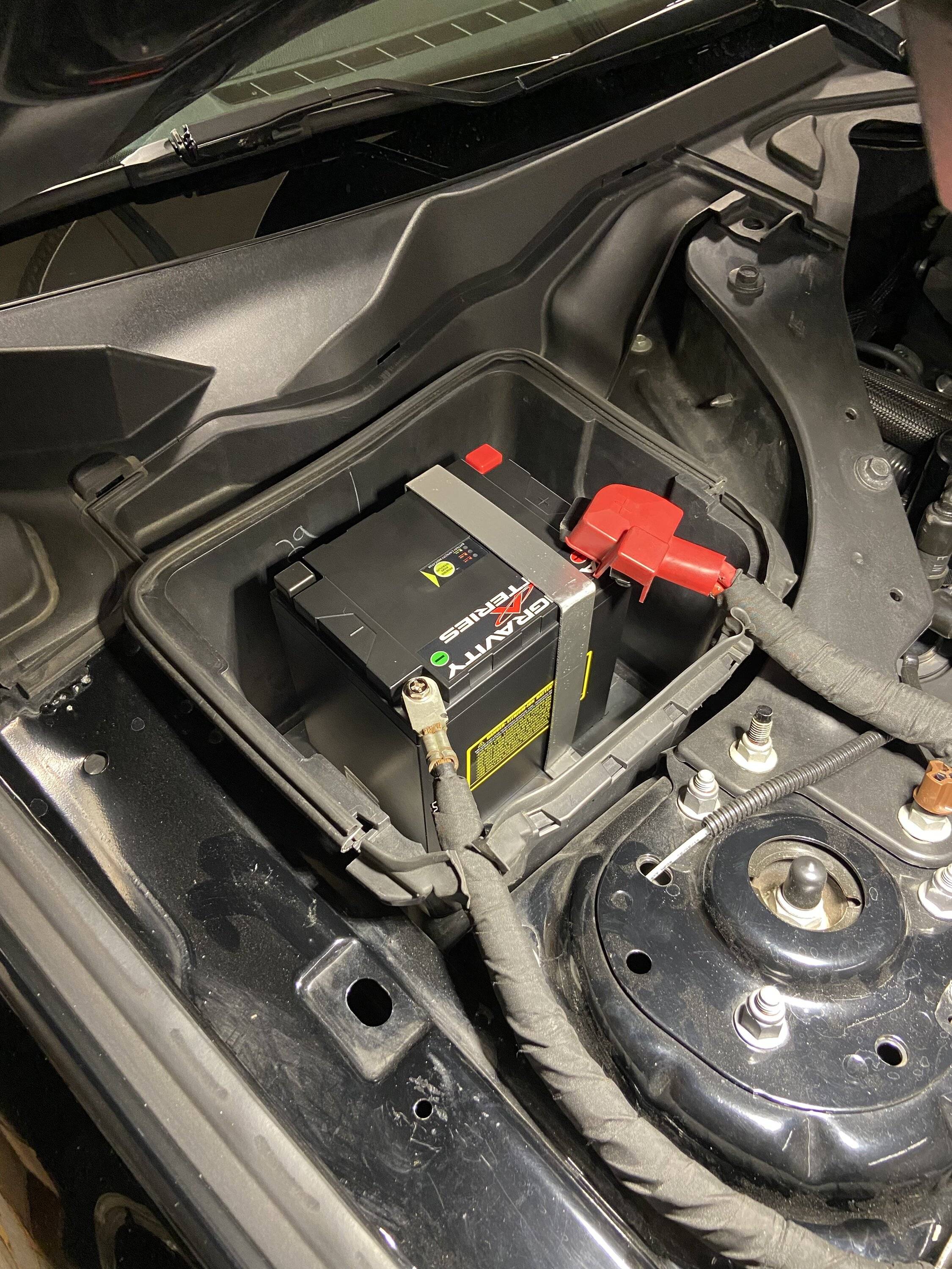

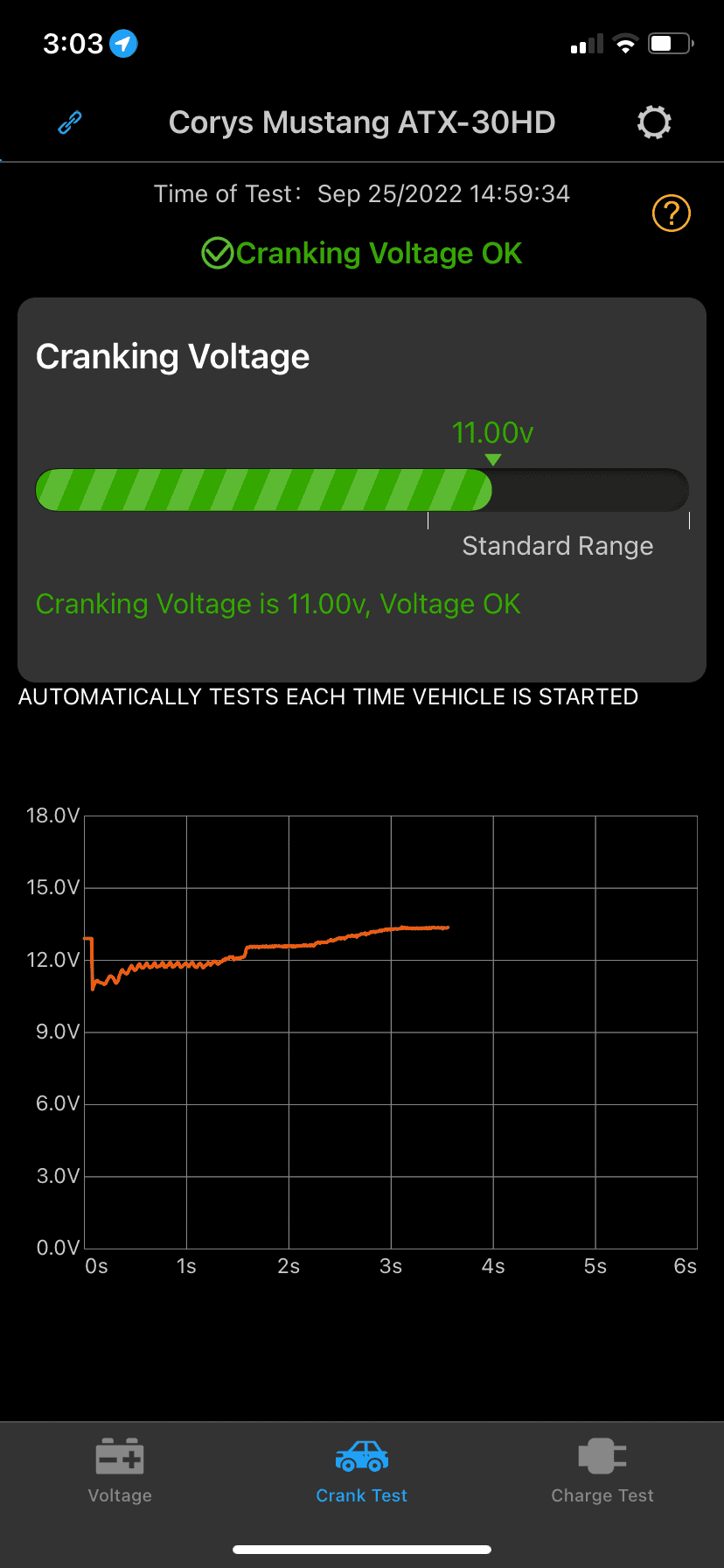

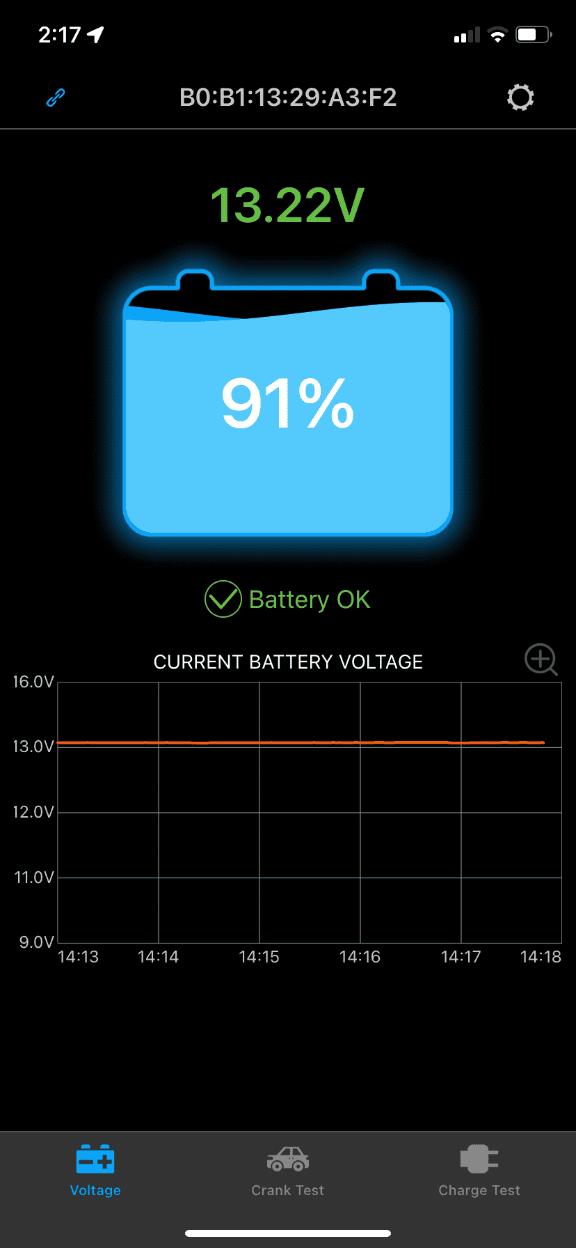

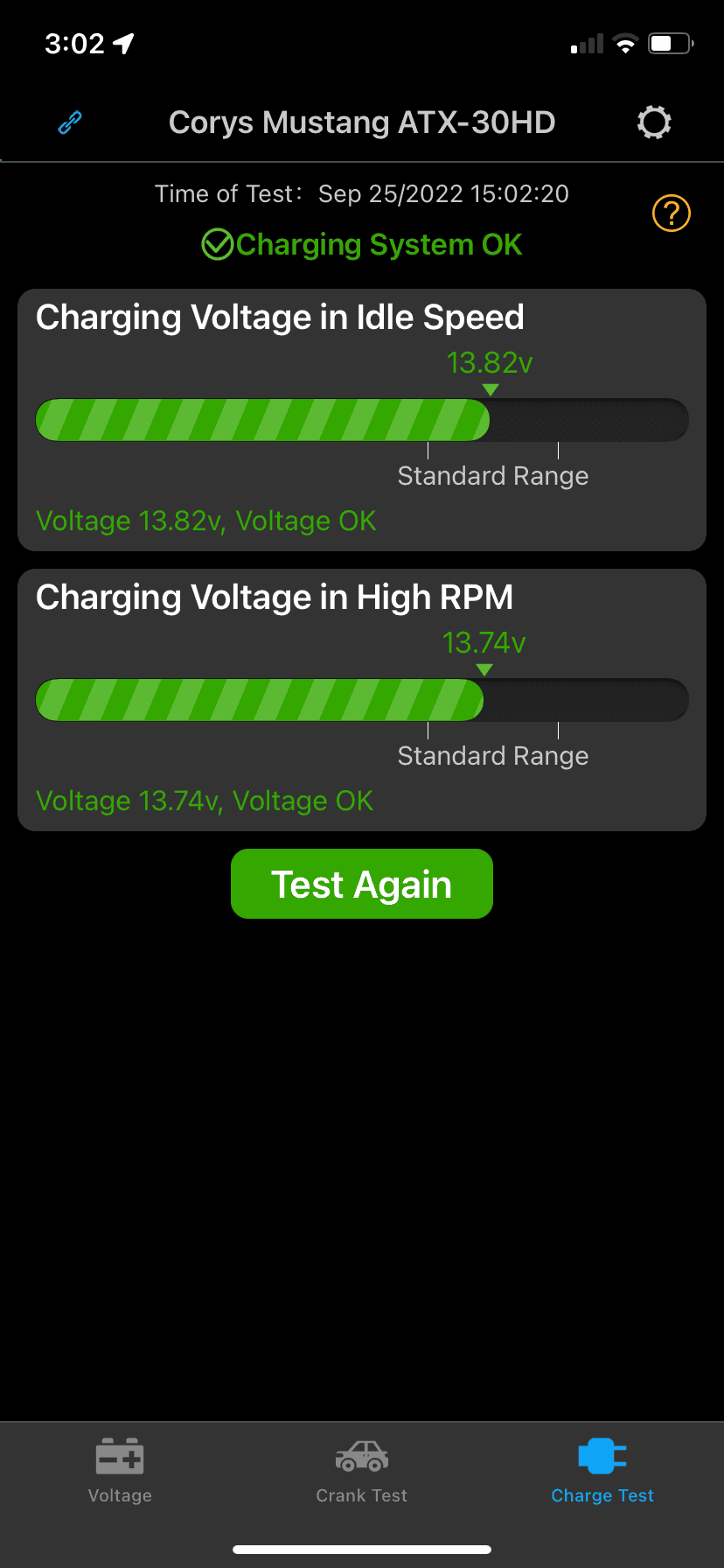

Started it up this morning with the newly installed AG ATX-30HD. It had a good 12 hours of sleep mode overnight. Charging was still showing a little high at 14.6-14.8V. So I did a BMS reset. Started it back up and voltage dropped to a nice 14.2V stable. Took it out for drive to let all adaptive strategies to learn. Voltage never budged from 14.2. I did 27 miles with 3 engine starts in between. So far so good.
Battery voltage at rest after 15 minutes in the garage is at 13.09V on my VOM.

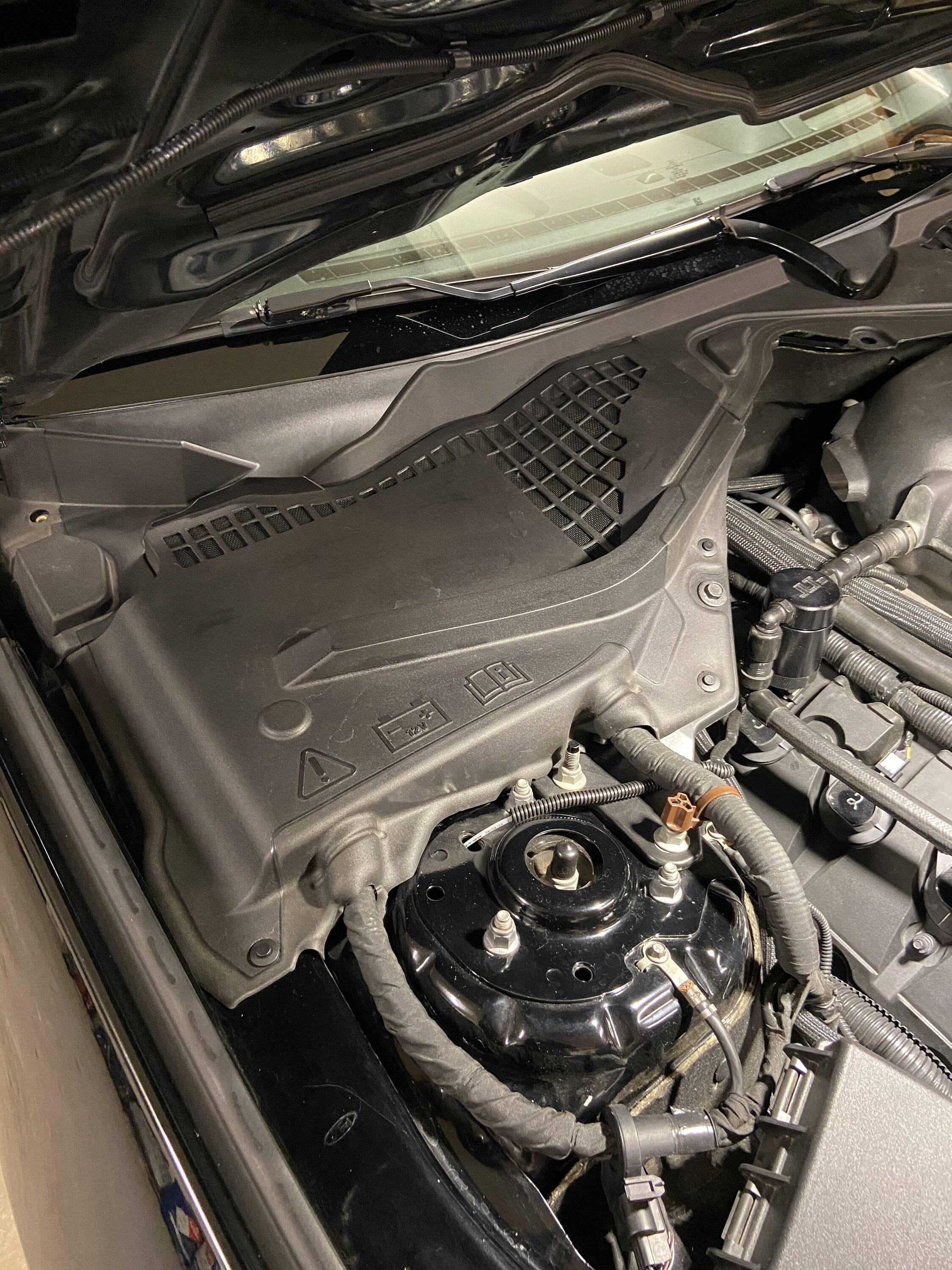

Hello Cory… so the ATX 30 fits without being too tall and fitting the OEM battery cover perfectly?
Currently fabricating something right this moment to allow the cover to fit. Will post pics up soon.

The Bluetooth app works great.
