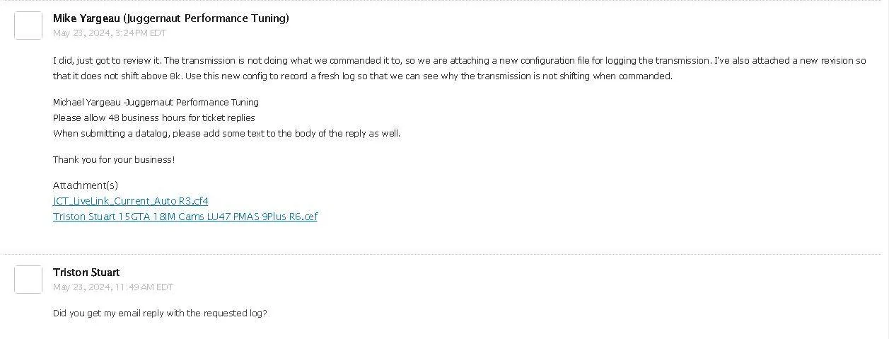

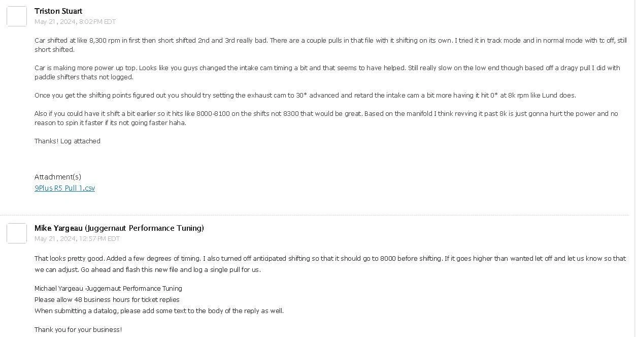

As far as the tune goes, I gave up after 3 weeks of back and forth when I was still on a 91 tune that was still slow as hell and couldn't shift right. My motor overreved to like 8400rpm in 1st then short shifted at 7,250 in 2nd. No tuners have ever had an issue with tunning my car and the shift points, why are we on the 7th revision after 3 weeks and countless datalogs and the car can't even make a close to consistent shift between gears.

Now that I can pull tunes maybe I will try to figure out what they were doing wrong. They kept blaming adaptive shift.
I am still not 100% on the transmission shift point tuning but it looks to me they just didn't know how to set the shift commands properly. When they would send me an updated tune the 1st gear shift point would change and sometimes second but 3rd (highest semi-reasonable gear to rev out on street) would always shift at the same point.
