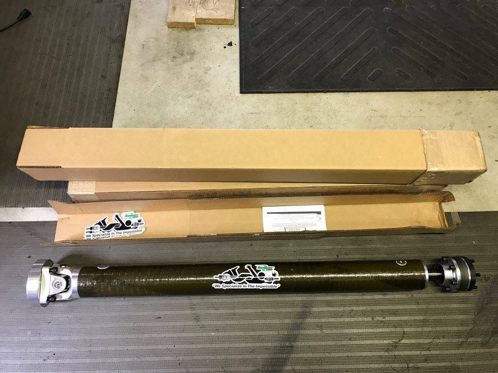

Today I installed my new DSS Carbon Fiber driveshaft and took her up to 100 mph and had zero NVH :thumbsup:
I tried Shaftmaster aluminum, DSS aluminum and DSS carbon fiber on my last car and each time I ended up switching back to stock because of driveline clunking but not this time :headbang:
I did notice the stock driveshaft bolts to the transmission tail shaft directly and doesn't use the big rubber doohickey the manual does. I imagine this is because the auto driveline is much kinder and this explains why the DSS went on without any increase in NVH.
I'm not gonna lie, I wish this driveshaft was a one piece design like the new Shaftmaster shaft that was just released. It would be nice not needing adapters.

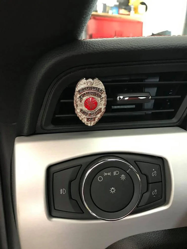

Kinda in a holding pattern waiting to install the suspension so I got a a few little things done today. Nothing special but I made a mount for my wallet badge and finally decided on a cell phone mount.
I also used the Forscan program to turn off the double honk and adjust the tire size in the calibration for the 325/30/19 tires.

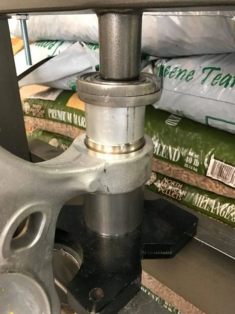

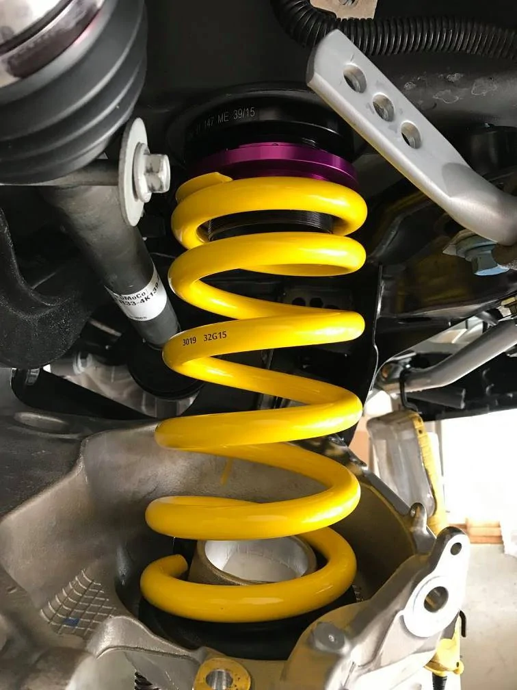

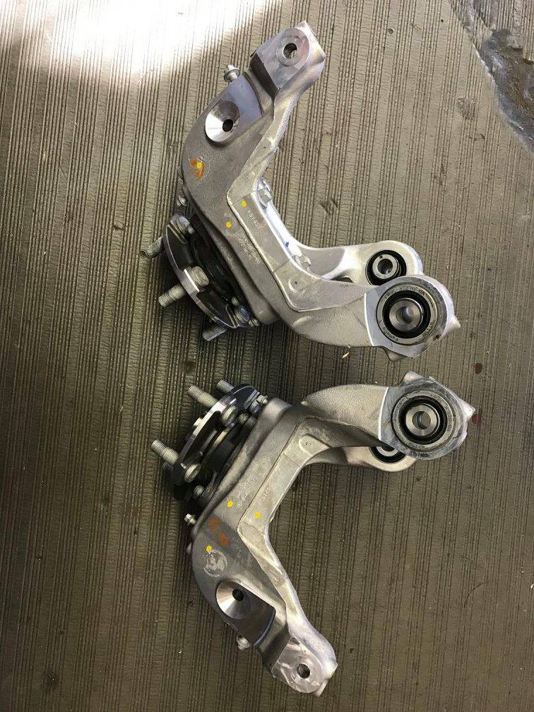

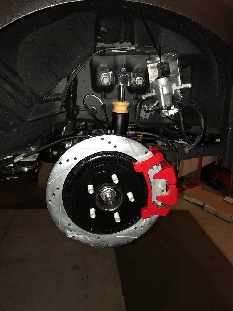

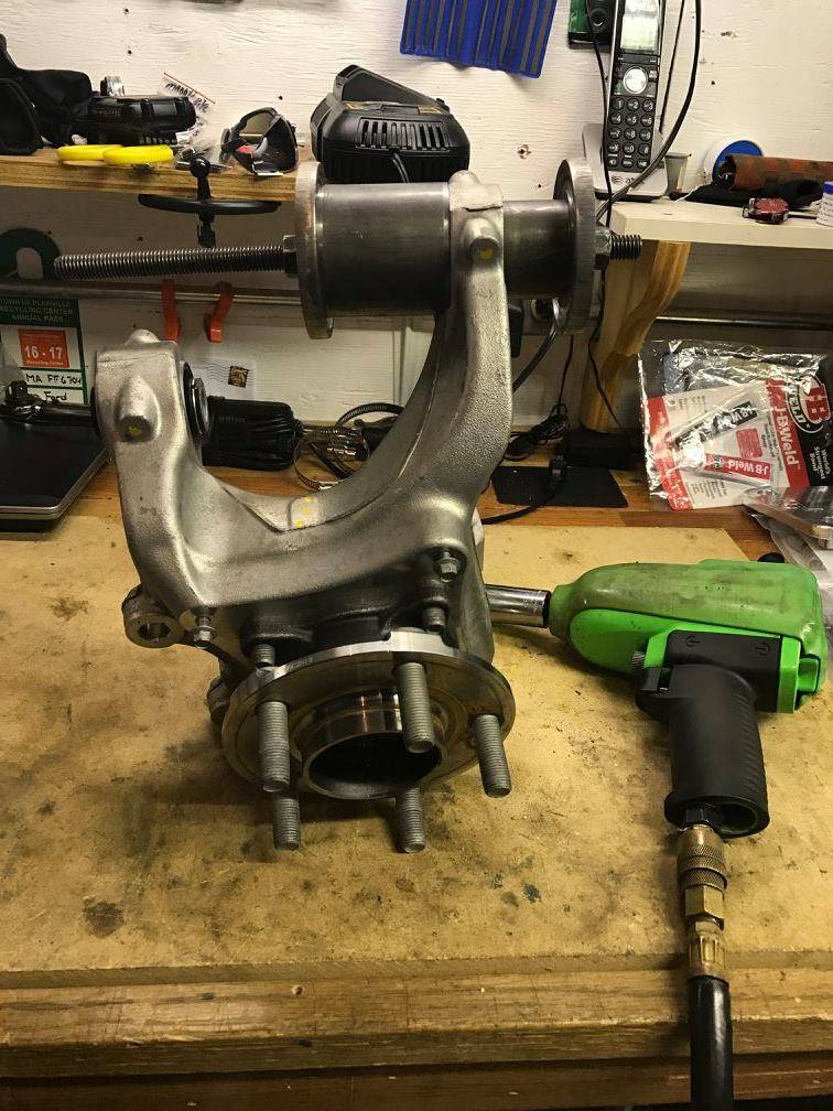

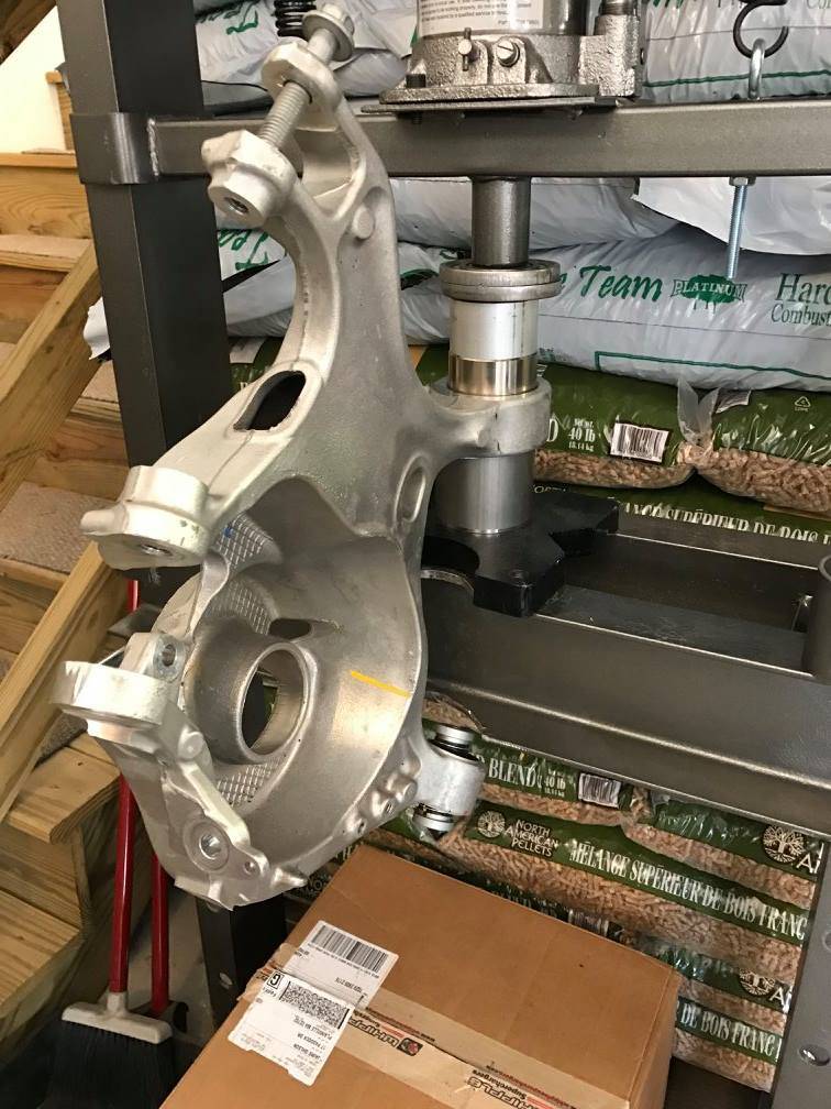

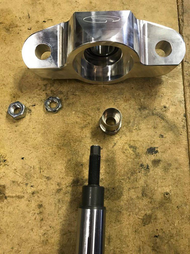

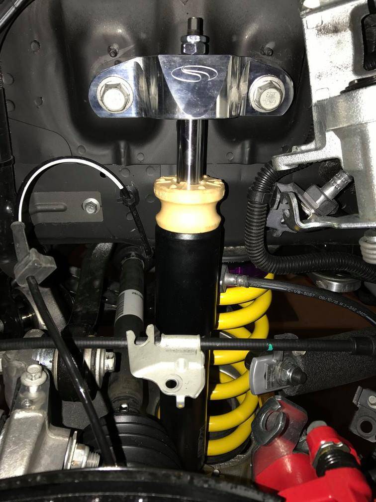

Well, busy day today. Got my Steeda LCA bearings and Ford Racing Knuckle bearings pressed in, KW rear spring & shock with Steeda's new Billet Shock mount for KW's installed, Steeda subframe centering sleeves, Steeda Subframe bushing inserts, RotorPro drilled & slotted rotors and started installing the powder coated rear calipers. Long day, those knuckle bearings suck!
