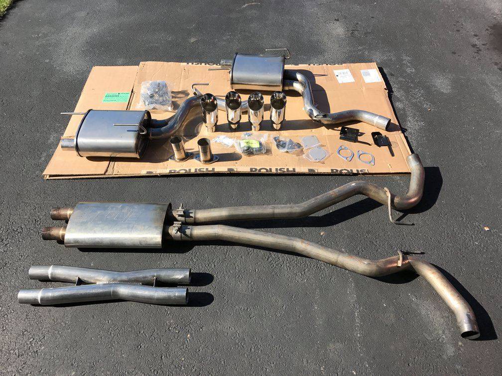

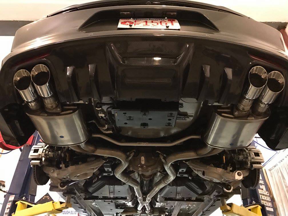

Well, spent 15 hours Wednesday and 8 hours today just installing my exhaust lol. It was a multifold process because I veered off course a few times to do other mods while I was where I was at the time as to not duplicate efforts.
Exhaust makeup:
Roush quad tip axle back
Roush "Active" add on module kit
Borla Touring donor mid muffler & mid pipes
Borla X Pipe

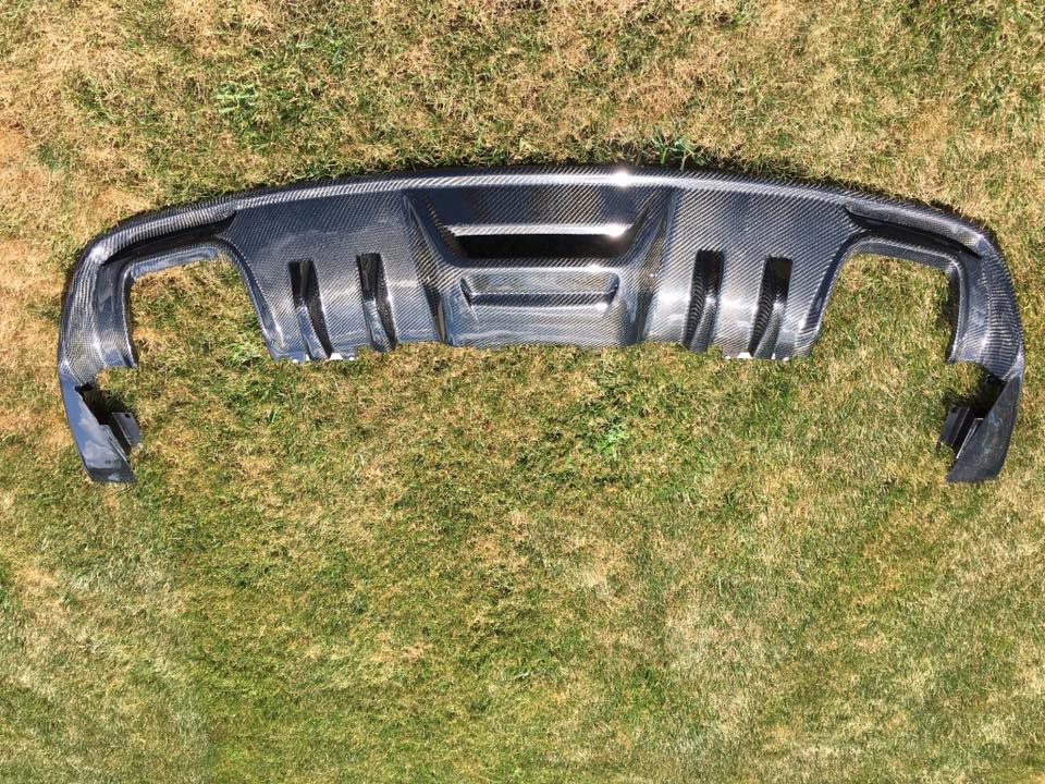

Tru Fiber Carbon Fiber quad tip rear valance
I am blown away with the quality and fit & finnish of both the valance and the Roush kit. The active exhaust is a work of art. Its no wonder they are expensive, this is OEM or better quality, The wiring harness alone was a work of art but every piece in the kit is phenomenal.

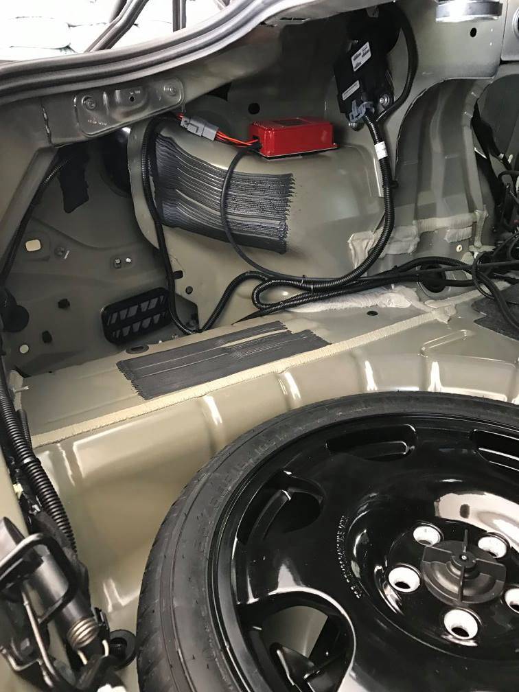

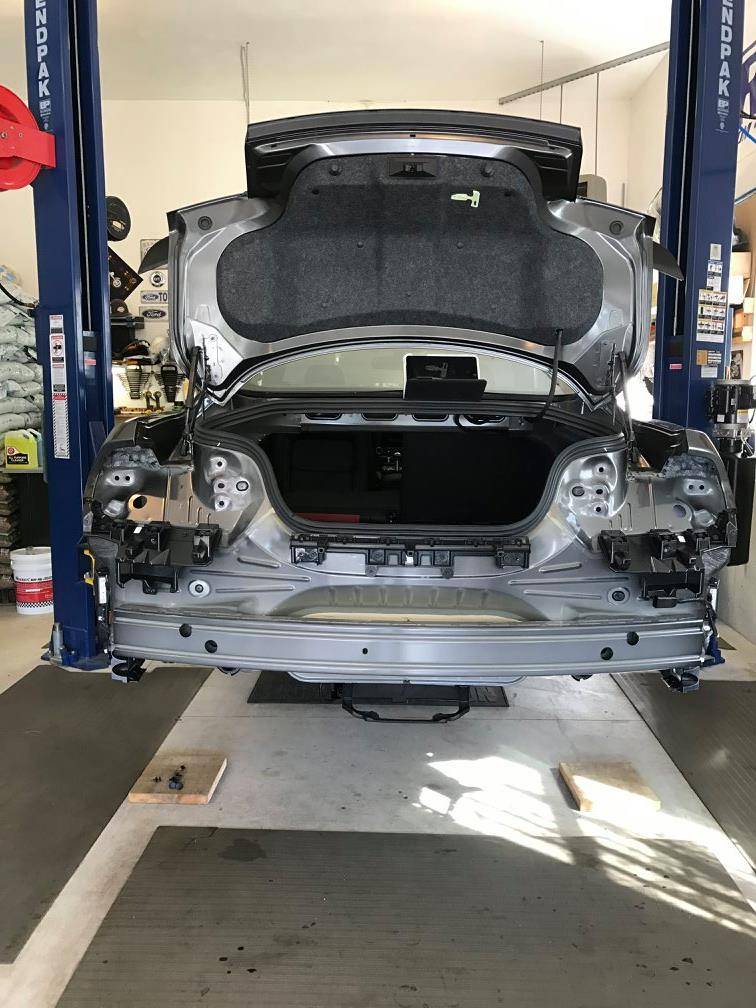

I started with the wiring from the trunk and while I was running the harness up front I decided to also mount and run my MSD BAP for later this winter when I install my Whipple. I moved its location from inside the spare tire hole to on top of the drivers side wheel well.
Cant believe with only 24 miles on the car I removed my bumper cover but I just had to get this exhaust installed, stock exhaust is just not something I can live with.

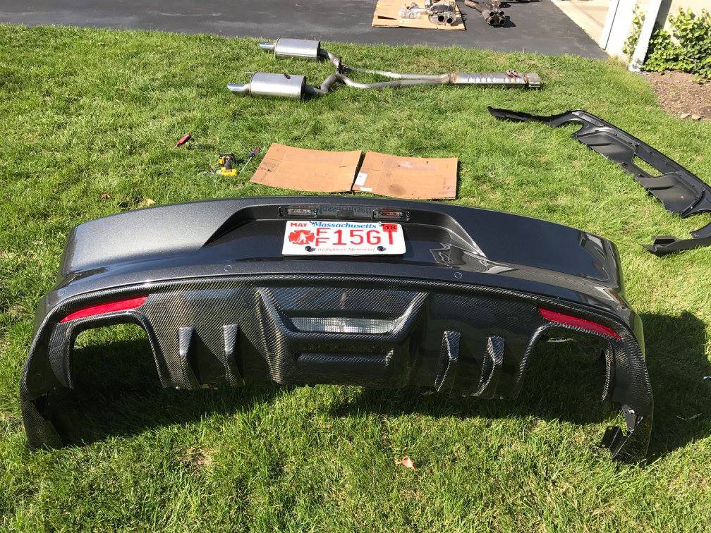

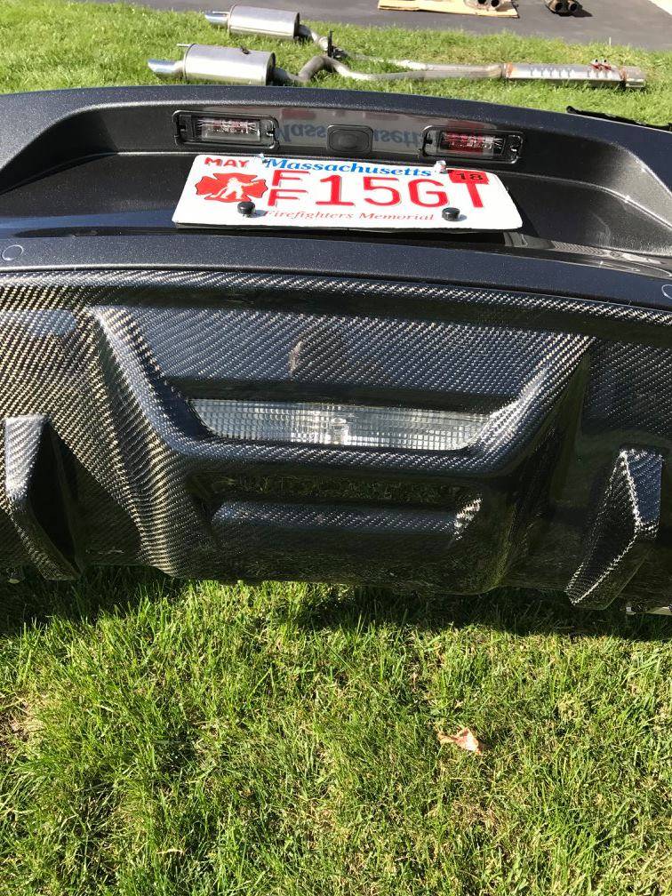

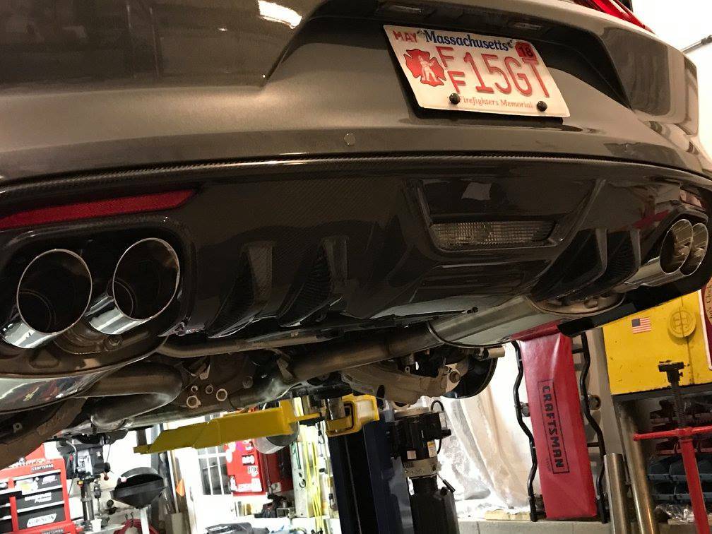

Valance installed. I must say it fits beautifully

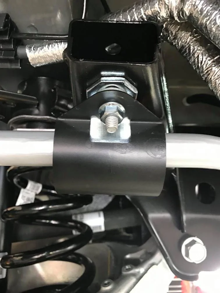

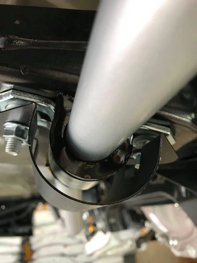

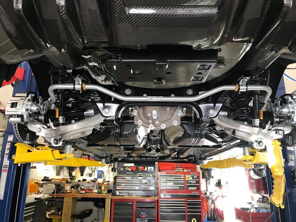

Part of the Roush exhaust kit requires the replacement of the rear sway bar bolts with studs because heat shields are used to protect the sway bar bushings. So......... while I was there I installed my Whiteline rear sway bar and end links

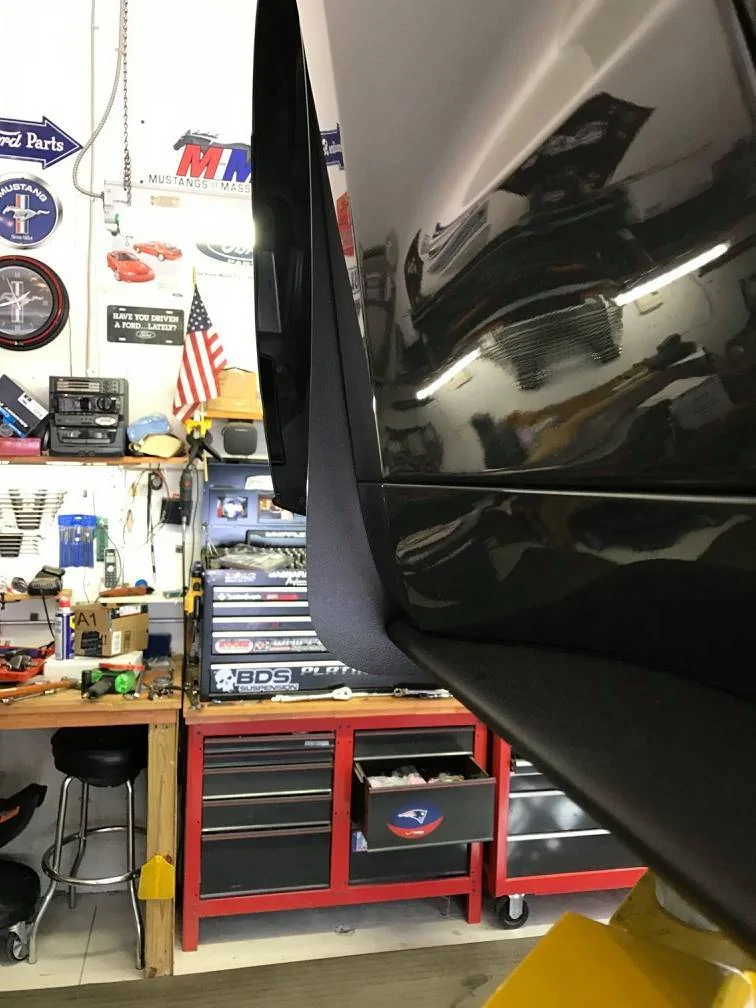

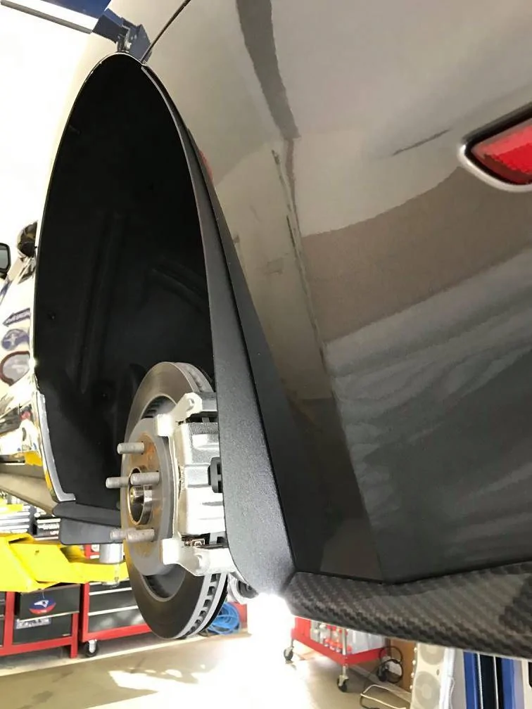

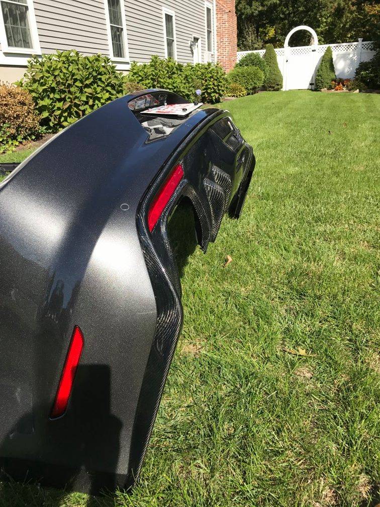

When I put the bumper cover back on I decided to install my ZL1 front & rear splash guards. Honestly, I am pleasantly surprised how easy they installed and I must say I like them a lot.

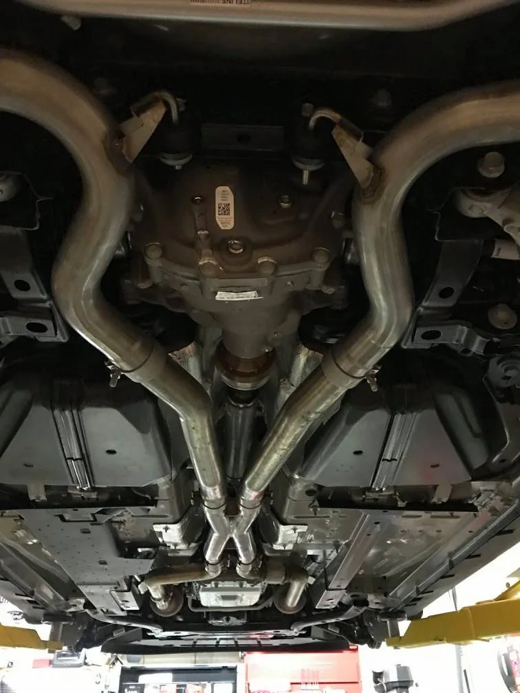

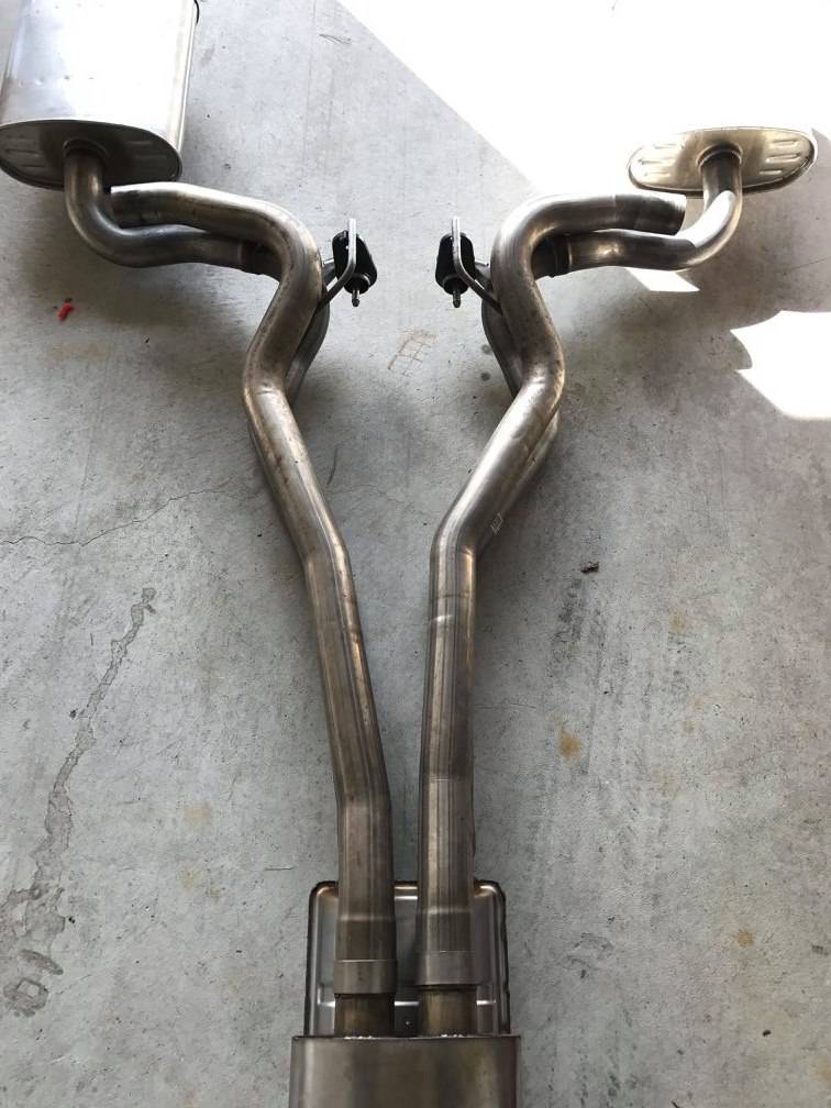

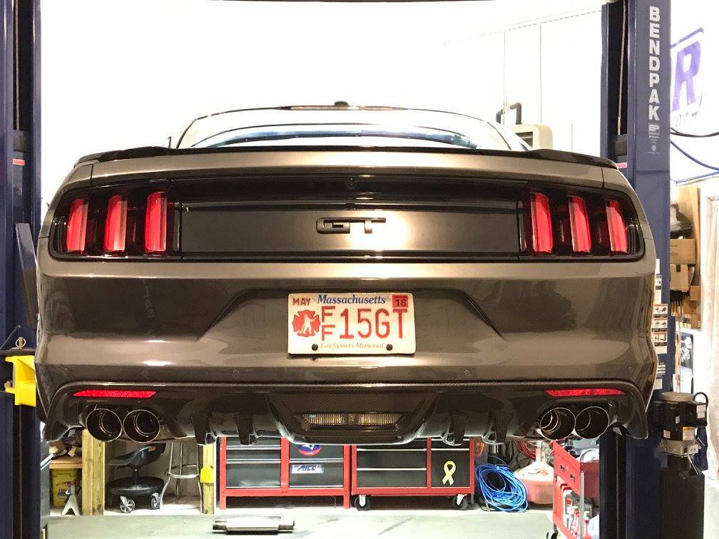

This kit has you cut the stock exhaust but I didn't want the resonator so I had to make it work with the Borla pieces I mentioned earlier. Here is the outcome, I must say it came out great!
Oh, while I was at it I installed my Diode Dynamics LED side markers and reverse light
Here is the outcome of the exhaust & valance. I am relieved to find out the valance works with the Roush kit. Not only does it work its freaking PERFECT. Fits like it was meant to be. Of all the exhaust Ive done over the years this is the best fitment I have ever seen.

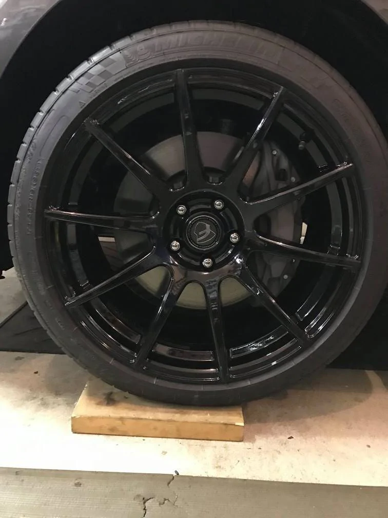

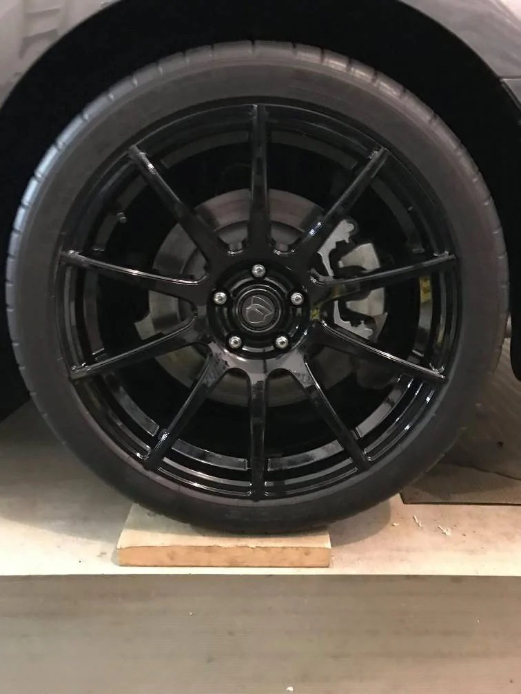

Lastly I installed my Forgestar CF10 19x10 with 275/35/19 and 19x11 with 325/30/19 Michelin Pilot Super Sports. I had 285/35/19 tires on the front but they ended up being taller than the rear so I used my 275/35/19's instead.Now the fronts are slightly smaller in diameter than the rears as they should be lol.
Cant wait to install My KW coilovers to get this thing lowered!
Took it for a short blast tonight and my god this setup sounds unbelievable. When in "touring" mode its a little quieter than the Kooks LT, green cats and Borla touring I had on last car. When in "sport"or "track"mode its an eargasm!!! I couldn't be happier, this is the best sounding exhaust I have ever had. WELL worth the money if you ask me.

That Roush exhaust fits so perfectly iin the Trufiber valence!

Thank god, phew I've been a little worried about it for the last couple months becuse I had the parts sitting here that's long. Thabks Tim
