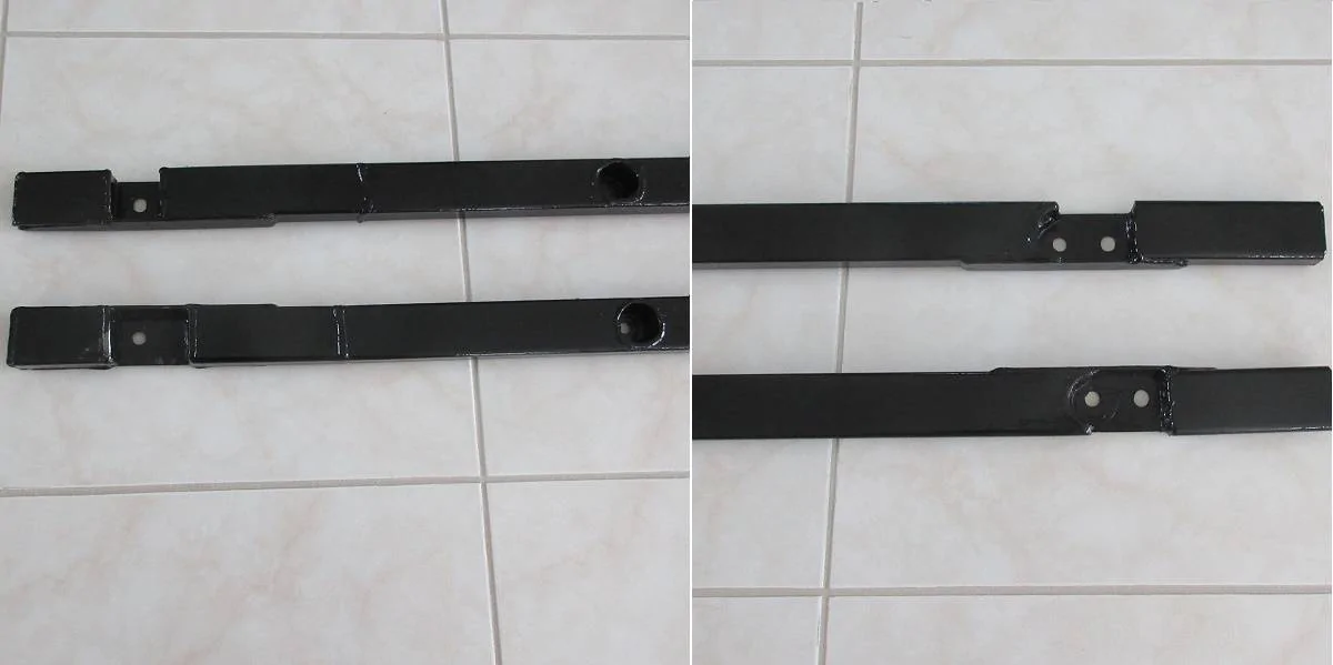

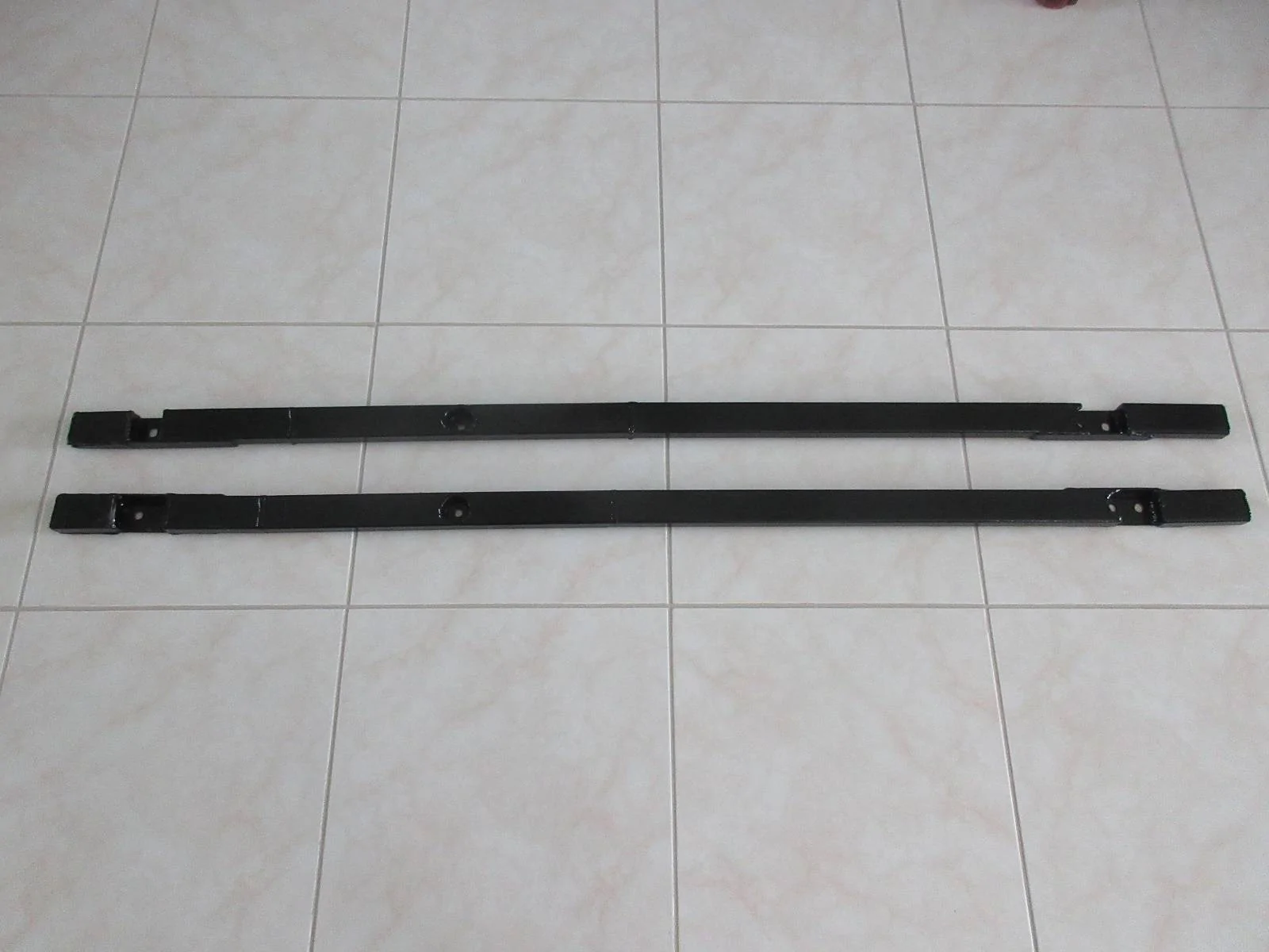

The Steeda Ultra Lite rails (the shorter ones) are made a little different than the newer longer ones.
The Shorter Ultra Lite low profile rails have 3/16" ANGLE IRON BRACKETS/W HOLES welded onto the 1" x 2" rectangular tubing at each end.
I believe this is the reason for the increased price difference
The problem with the shorter ones for me was:

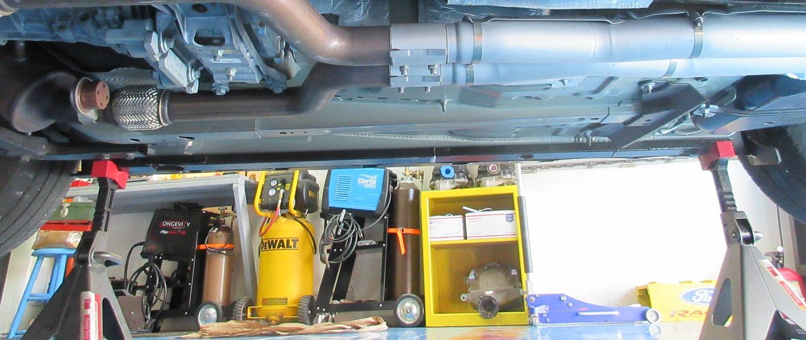

Great to jack your car up..., But I like to put my car up on 4 jack stands on the rails (spread pretty far apart) and the shorter rails just didn't allow me to do this safely.
I took my short Steeda jacking rails off and modified them as follows:
Sectioned a 8" piece in the middle of the rails to move the rear bolt holes to the 2 chassis holes farther back.
Then I lengthened the front approx. 5", ahead of the front 2 holes, then reworked and lengthened the rear 4" to the rear of the rear 2 holes, using 1" x 2" steel rectangular tubing.
Also modified the bolt holes to allow more spread on the mounting.

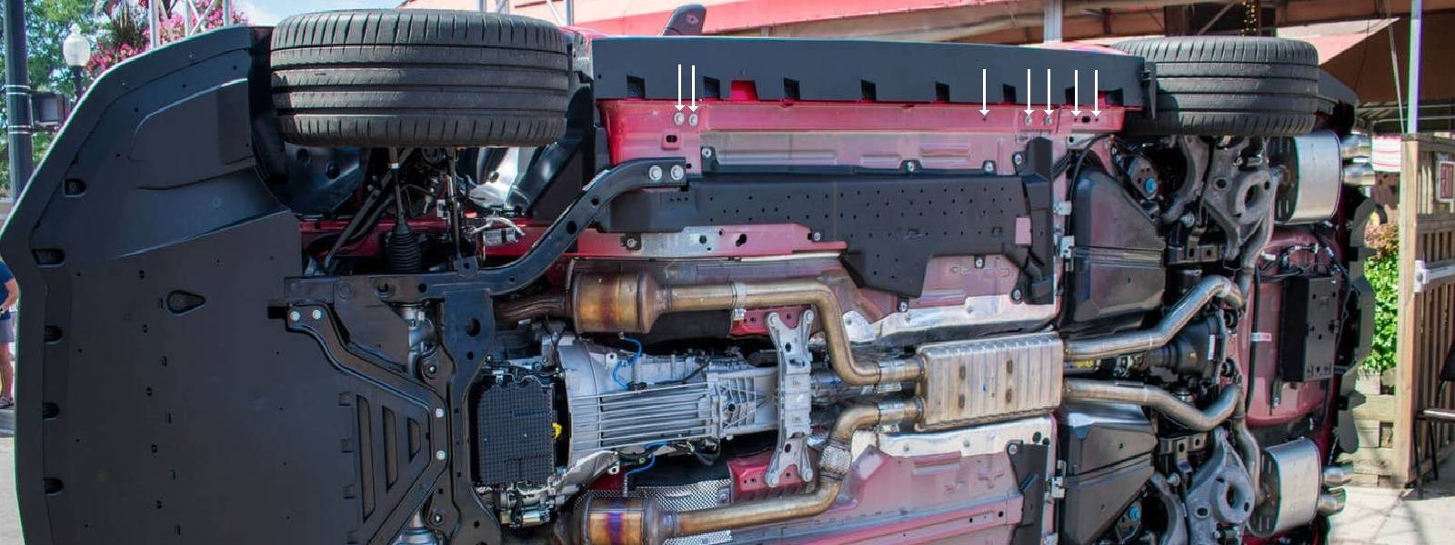

(There are 7 threaded holes available on each side for bolting the rails on the S550 chassis) -Mustang GT shown-
Now I can put my front jack stands right behind the front wheels, and the rear stands just in front of the rear tires on my GT350.
Perfect for working on tires, transmission, exhaust, rear end, oil changes, etc.

I really like the spread of the jack stands
If you are thinking like me you definitely want the longer ones...
