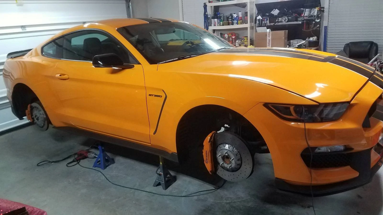

I have the BMR full length. They work great with jack stands, jack directly under the mirror and put a stand on both ends of the rail. Get some jack stands with the shallowest "V" or even flat topped. I put my car up on four stands with all four wheels off the ground for rotating the tires, swapping out the winter tires, or inspection / wrenching underneath. Which also allows me to level the car somewhat on my sloped driveway. They protect the undercarriage from tall speed bumps. They are great if you don't have an extra set of wheels and plan to take only the wheels to the tire shop for mount/balance.

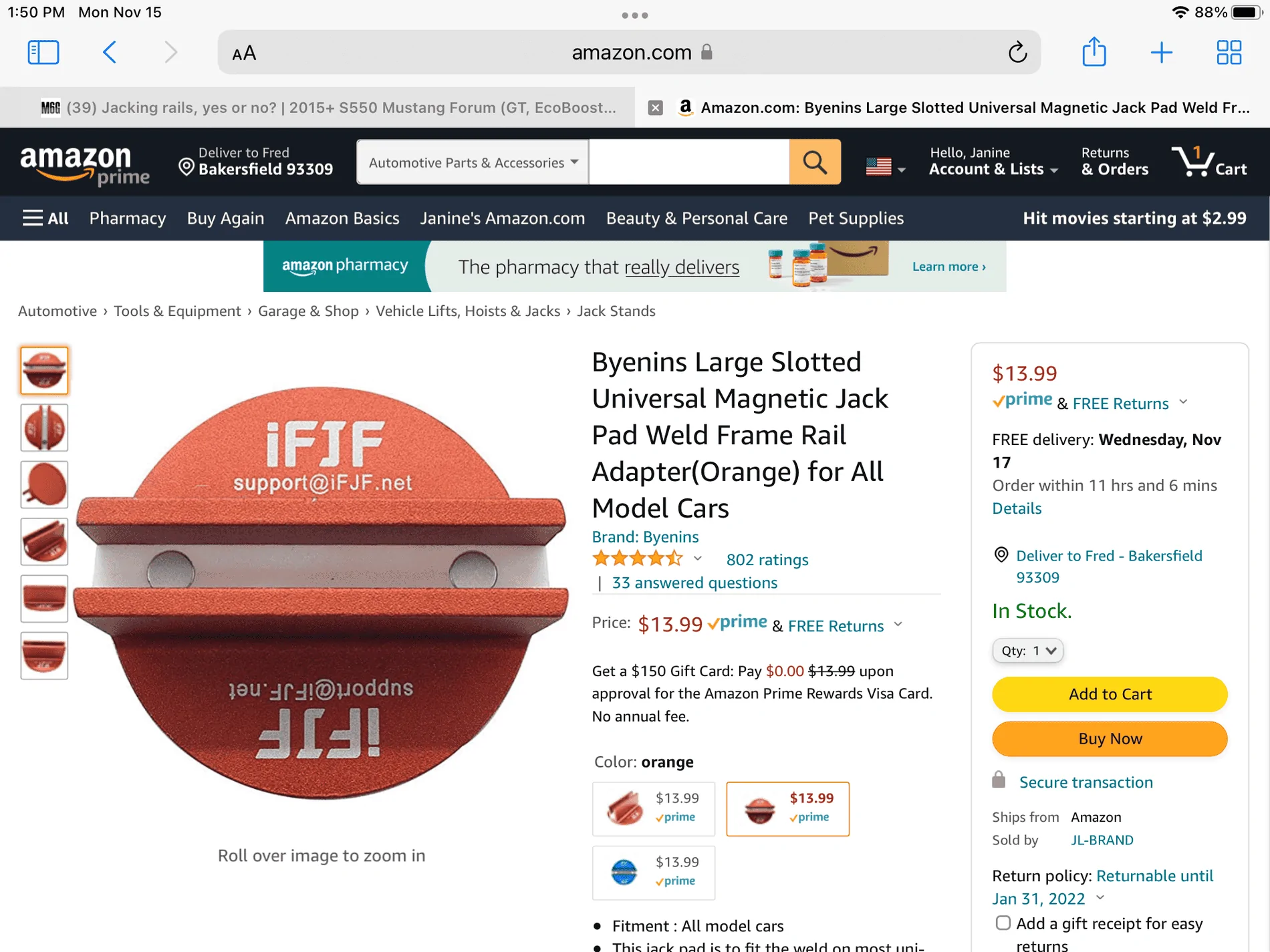

Absolute waste of money:
1. Unless you're in a timed event, that you need to jack the car up in 2 sec.
2. Just put 1 or 2 Hockey pucks on the jack and place it on the existing rail (please zoom into location on the photo below where the pucks are). When jacking one side of the car at a time I jack the car up in the middle of the door and place jack stands where the pucks are in this photo.
3. The Hockey Pucks are $1.00 each and don't scratch the bottom of the rails.
Total waste of money. (for a 2021 Mach 1, other Mustangs may have different plastic parts that prevent the Hockey Puck trick)
