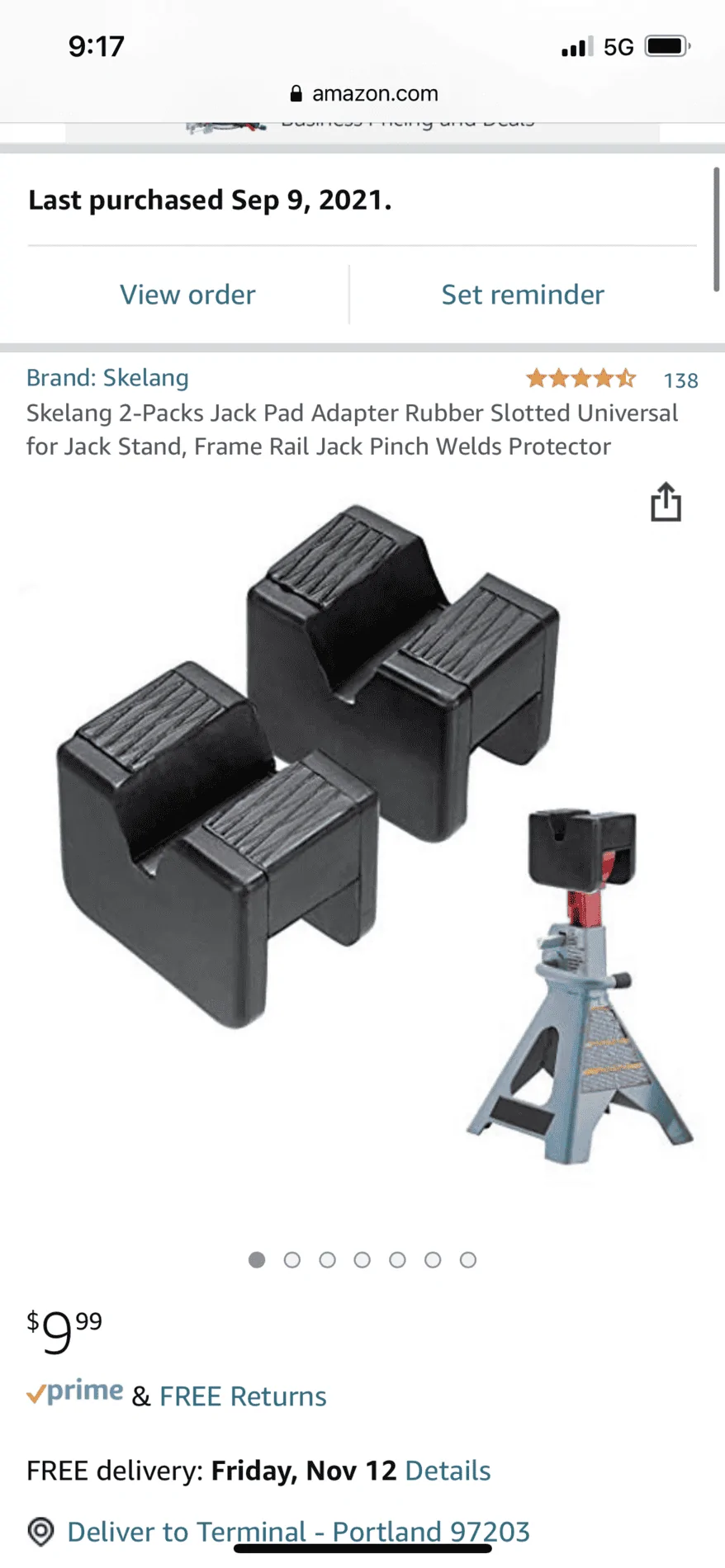

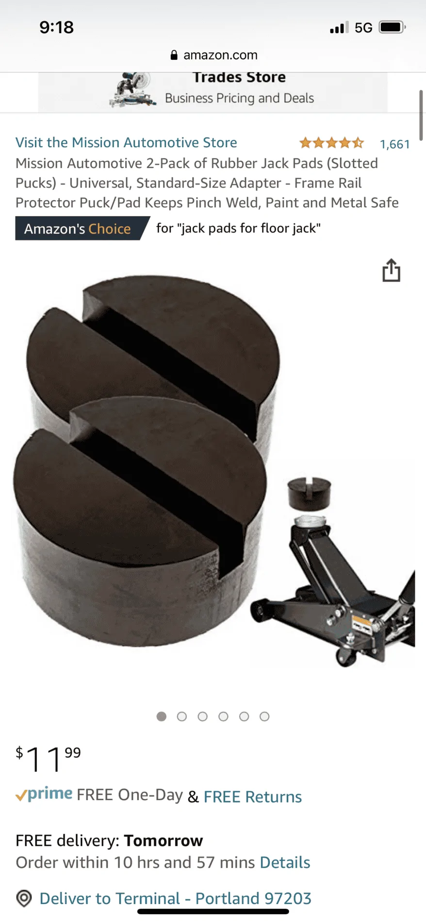

I didn’t want to add weight, so just use pads. $10.00 for Jack pads and $20.00 for Jack-stand pads so I can put all 4’s up at once.
I’ve used them at least 8-10 times the past few months and they work just fine for my needs.

Now that I learned what jacking rails are I'm waffling. I've been looking for pads for my hydraulic jack that will fit the 'stang and my Tbird. I think the smaller pads (65 mm) will fit the TBird but they seem to wide for the 'stang. Haven't found any pads smaller than 65mm. The magnetic pad noted above is 3" and won't work for either car, although it's a great idea if it would only fit.

Be careful with these, they have been known to occasionally split and fail under load after they've been used for a while. The notch with the rounded bottom instead of square is less likely to fail, not sure why that wasn't part of the design of the puck-style pads.

Jacking rails were the first mod on my Bullitt. A few weeks after installing, i got a nail in a tire and had to hit the tire shop. Who knows where they would have lifted the car without the rails. The slotted adapters would be great at home (i have some of the BMW-type jack adapters at home) but not helpful in an emergency repair shop scenario.
