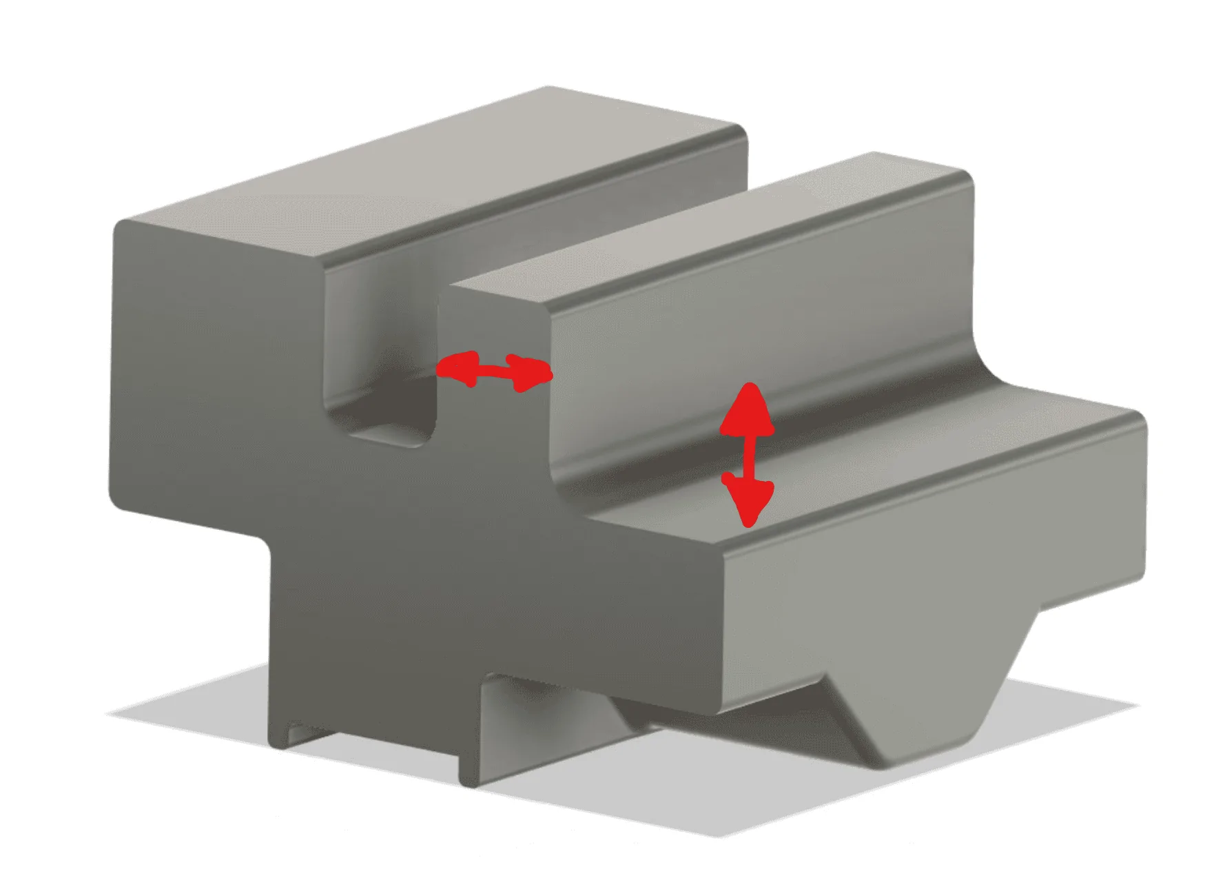

My solution for this is a 3D-prinded adaptor thats clicks into the OEM jack and fits between my BMR rail and the pinch weld.
https://www.thingiverse.com/thing:6156428
I only use the jack in the trunk for an emergency (which hopefully will never come).
The part will hold even with repeated use, but is nothing for continuous use.
It puts the jack not only on the pinchweld, but with the bulge also on the jackingrail.
For all work on the car I have a decent hydraulic jack.
PS: You could also grind the OEM jack a bit with the angle grinder to make it fit despite jacking rail.

I think every FDM printer starting at $100 can do the job.
e.g. https://www.anycubic.com/collections/fdm-printer/products/kobra-go
Over here, you can find people who will print something for you via classifieds and on the internet, there are even companies that do nothing else.
With the Fusion 360 file, which I also provided there, customizations to other jacking rail dimensions (I have BMR) would also be possible.
For customizations relevant dimensions is the height offset between the horizontal surfaces and and the width of the offset (to the center of the vehicle).
Maybe there is someone from the US on the forum who can print for you, @pilotgore e.g. is a maker for some S550 gadgets.

Thanks for the shout out! I’d be happy to help out a fellow forum member.
I’m slightly concerned about the weight of a car on a 3D printed piece such as that, but if you say it works I guess it works :) I’d certainly be interested in what print settings you used.
