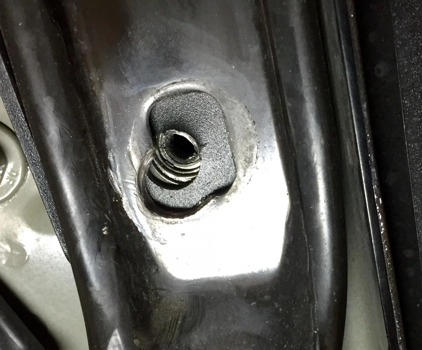

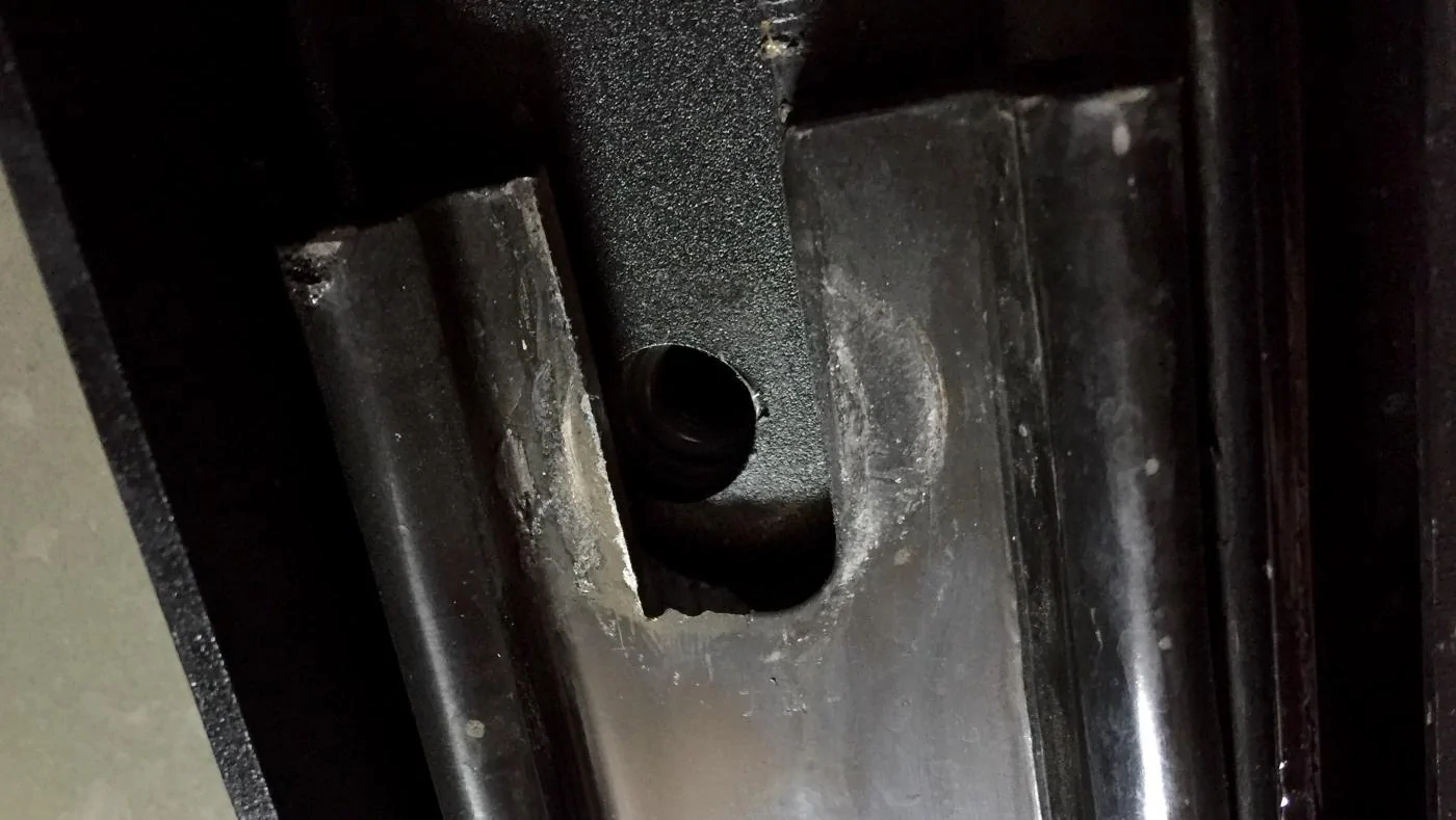

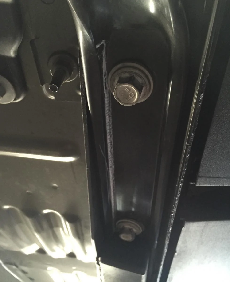

Here is what was done to bolt on my non vert (lol) jacking rails.
It don't look purrty but it works

you did that on the jacking rails? wouldn't that hole allow the piece to "move"?
thanks for the photos :)
Lightning
Miss my 93
Jul 7, 2015
829
373
Montreal Canada
50th anaversery GT, 2019 Golf R
Not at all, I've even hit a speed bumb:doh: and still solid :hail:
Just to clarify, not at all- I meant not at all as in that it's the OEM braces that were violated LOL not the jacking rails
