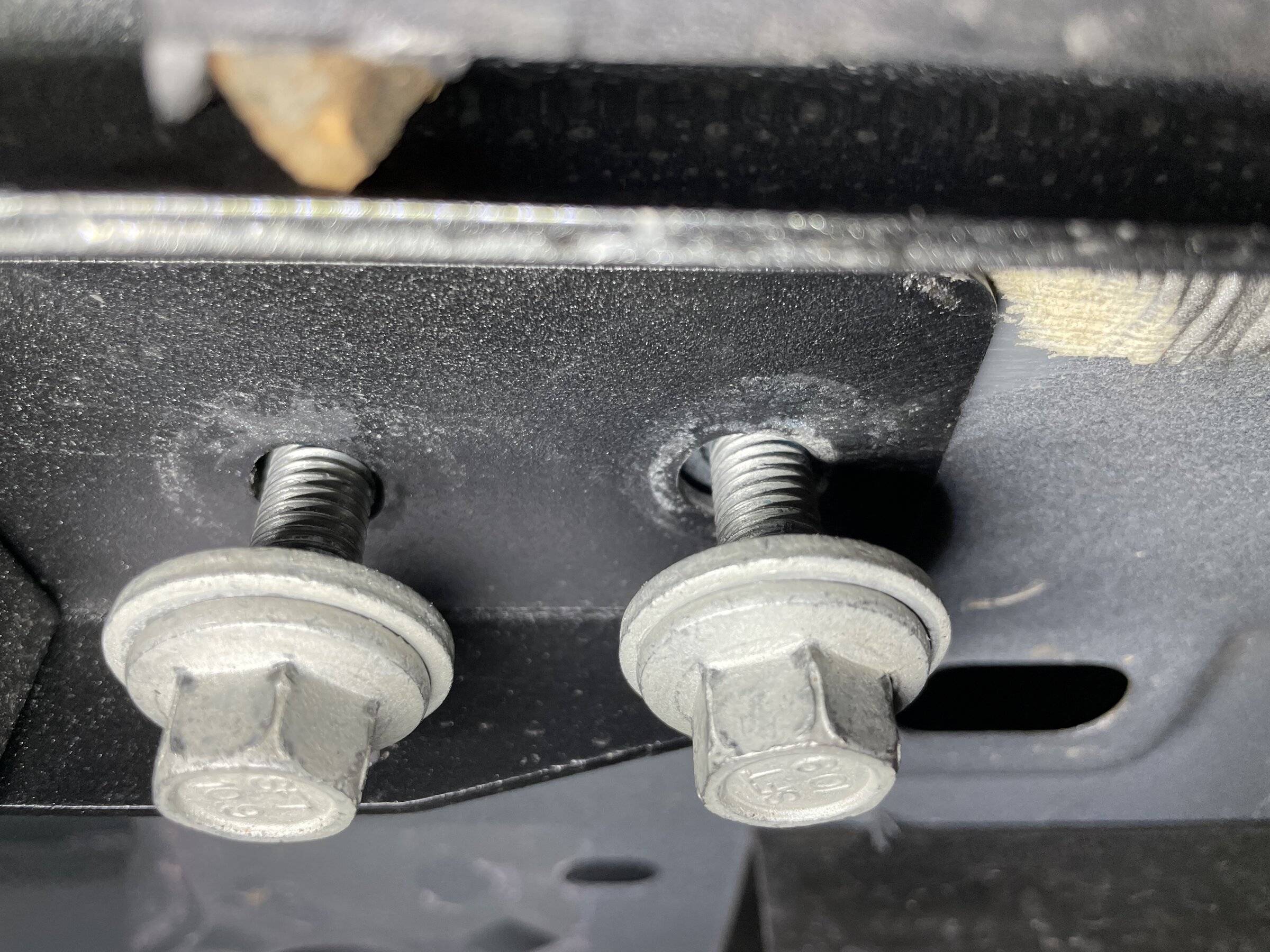

This is where you may have to grind. Notice the front bolt hole does not align.
Same exact problem that I had. I also believe the variance is more likely in the rail manufacture. I still have them sitting in my garage soon to go on Marketplace, I gave up on grinding. I'm going to order the JM, which I think is a better design, anyway.
