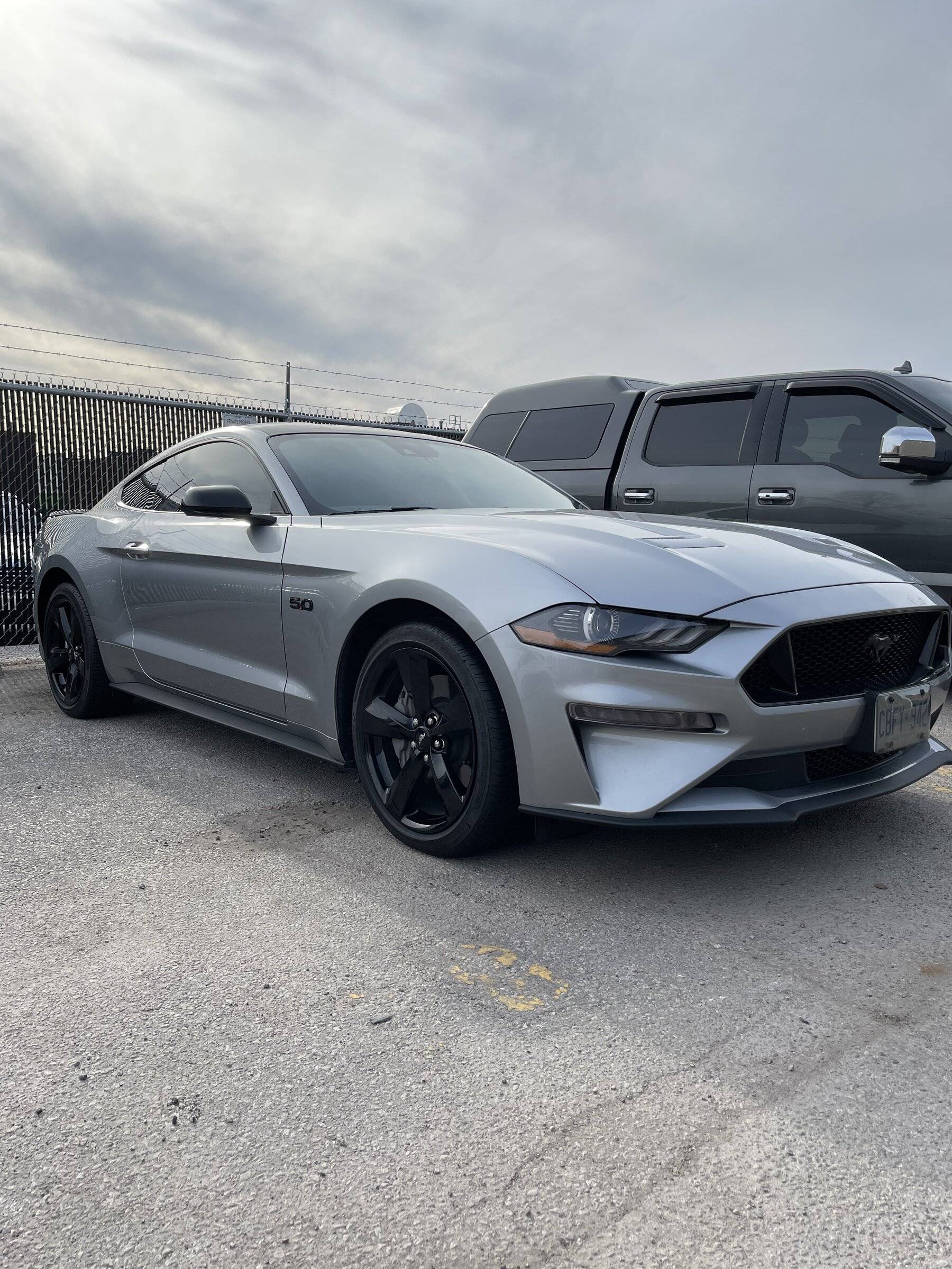

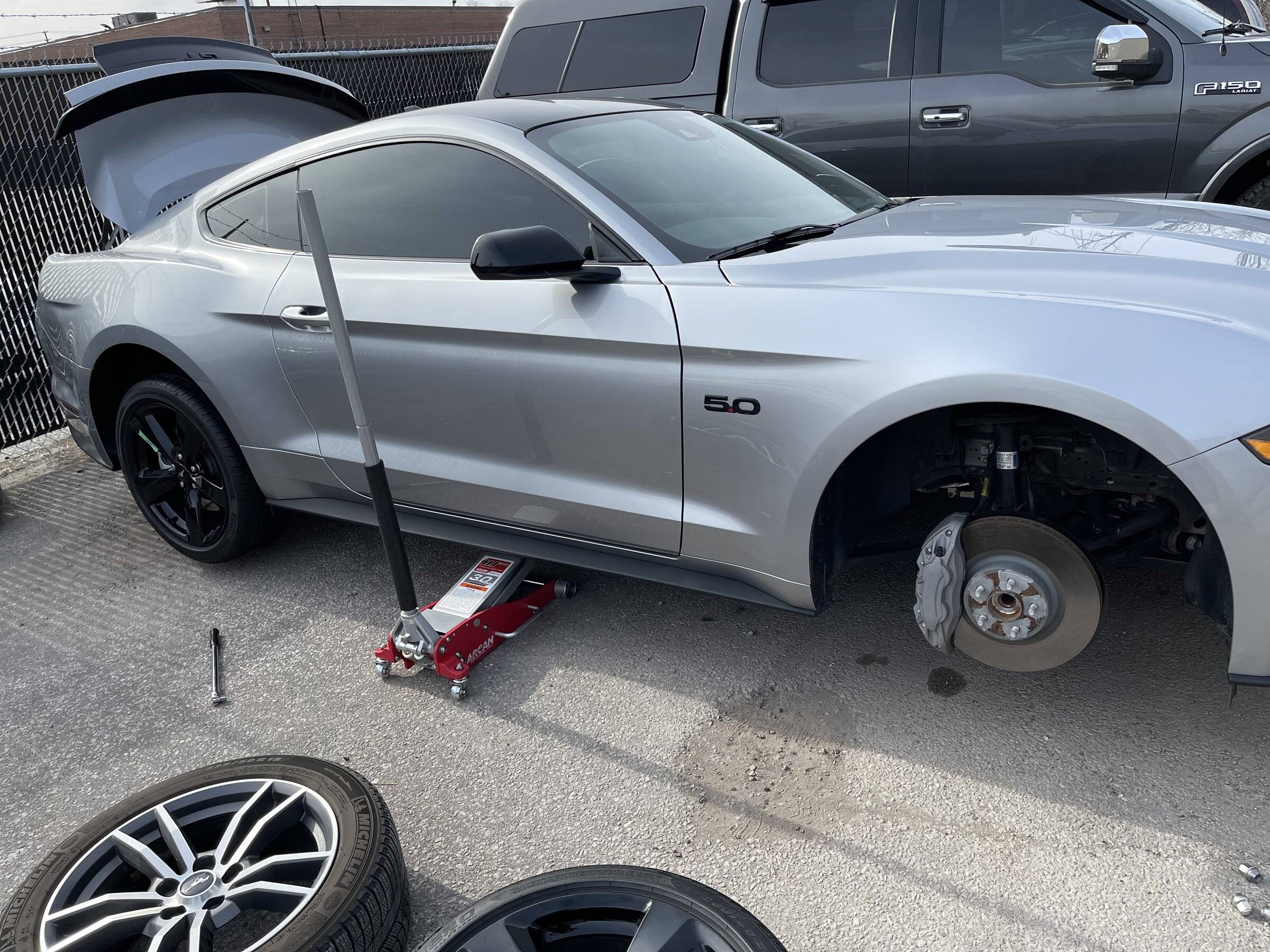

Jacking rails FTW!
Toretto
Jan 31, 2021
363
380
Mississauga
2021 Mustang GT Iconic Silver
Made the job so much quicker/easier :)

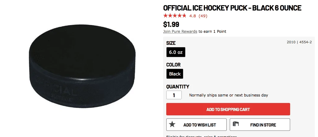

I went with the 2x HP old racer trick, saves weight and $$, use two on your jack against the inner rail. Easy works every time.

Can just use the front jack point and it will lift rear up as well....been doing it forever and works fine with vert as well.
My car came with out a jack. Got lucky and found one in local classifieds with a u grove on the top. Has the shop weld a lug sized nut on it and just sue the impact to jack.
Swapped four wheels and tires in 20 min the other day:)
Yeah you can do it without them, but the rails make getting the car on 4 jack stands much easier
