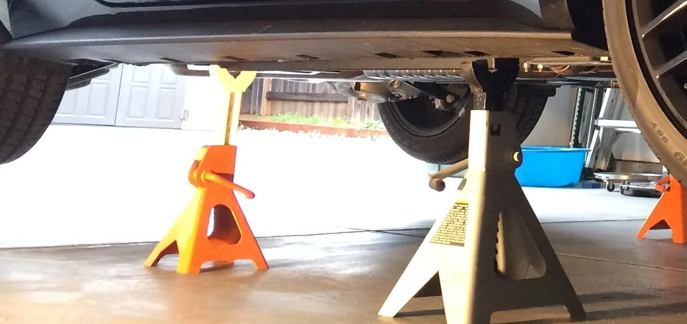

It's true, the Steeda jacking rails do cant inwards, so they are not flat. The mounting pads on the car's body have this tilt, so the rail being perfectly straight causes the entire rail to have the same angle. Doesn't bother me, my jack, or my jackstands, so I don't care....closeup pic below.
If it really bothers you, the BMR units are clocked so they sit level. FWIW, if you are jacking up one side, the rail relative to the jack pad will be tilting inward as the car goes up in the air, so it's likely in some scenario with either product, you will have lack of parallelism,

Thanks, great pic, more curious than bothered. It did seem very sturdy when up in the air. Didn't know that about the BMR. Definitely keeping the Steeda rails.
