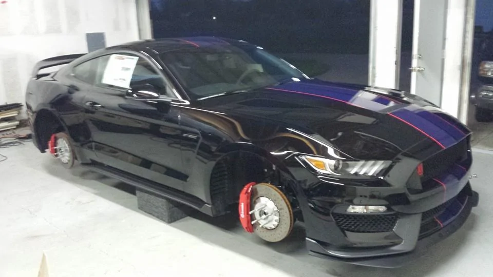

You can also do this if you have jacking rails. :)

Sorry, I don't have. Crappy nighttime cell phone photo. Yes, they are Steeda Rails. We were doing some detailing and applying CQuartz at the time and wanted to be able to coat inside and out on the wheels easily. You'll be happy to know that I installed the jack rails before I had even "driven" the car. I had the jack rails waiting. Picked it up in an enclosed trailer to bring home.

That's the first R on blocks! Lol.
