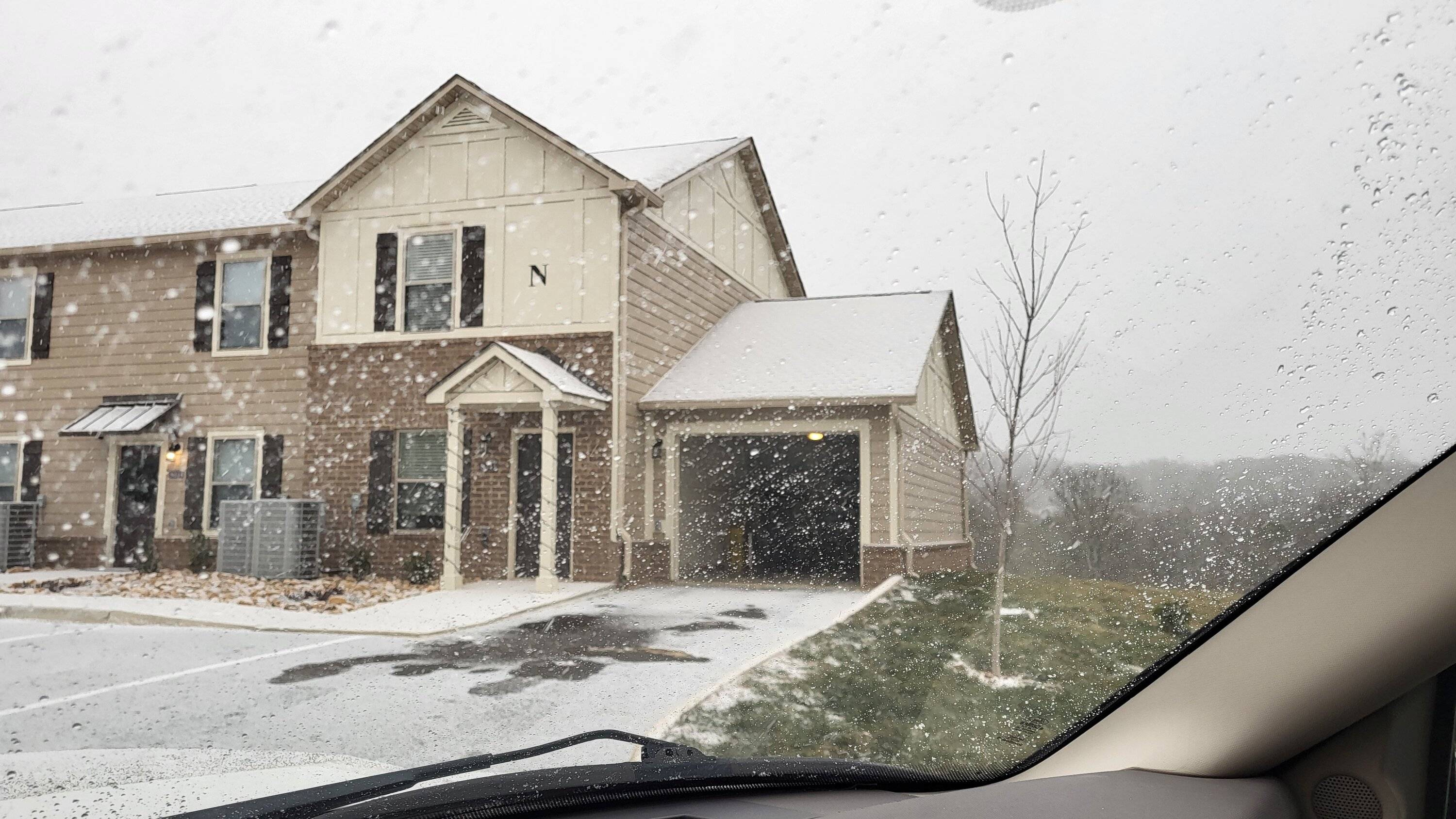

I live in an apartment with a garage (while waiting for my new house to be built). The apartments are brand new and the parking lot does not have the "top coat" of asphalt installed yet so there is a noticeable cliff going in/out of the garage. This cliff does not afflict my 4WD Expedition. Once the last couple of buildings are finished in a month or two they will pave the top coat which will hopefully resolve this issue.

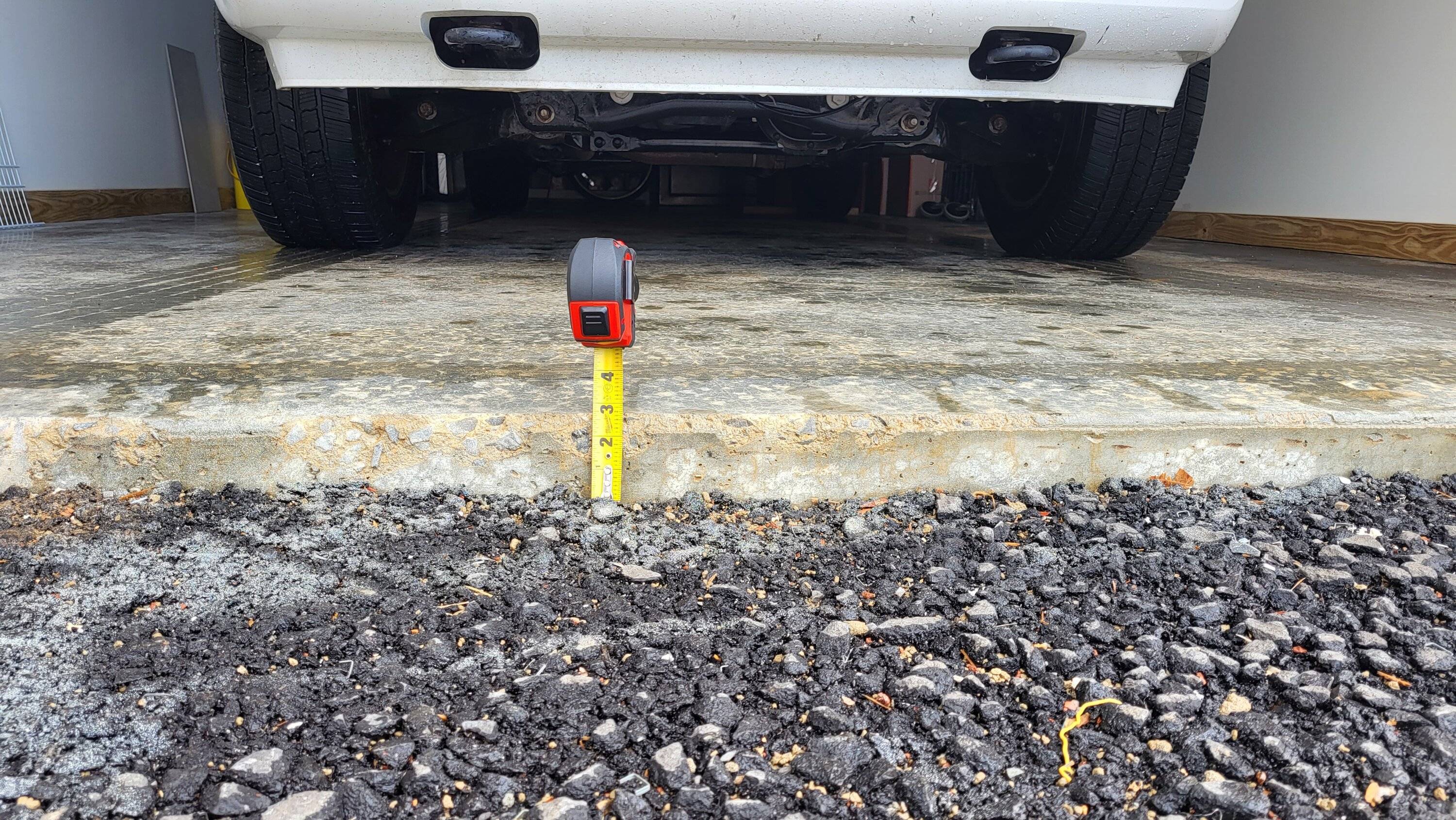

But for now.... is this going to be an issue getting the Mustang in/out of the garage? It looks like about 3" tall. I would really prefer to leave the Mustang in the garage rather than the Expedition.
If it is an issue, is there a good workaround?

I'd back in if I was you and there shouldn't be an issue. Going forward might be kind of sketchy but I'm pretty sure my pp1 lip would clear a 3" curb.

Not in the least bit. Your car can clear around 6".

I would put a 2x6 or similar across the front so you can drive up in steps.
This sounds like a simple solution if there is an issue.

you could pile some more gravel in front of it
This^^
just buy a bag of gravel in HD and dump it there.
Mustang with stock suspension will clear 3 inches. In stock form, it should be a bit over 5 inches of clearance. I wouldn't want to drive over this step multiple times a day though.

It'll be fine. Some yellow speed bumps around here are taller than that and i get over them no problem. Yellow meaning the skinny kind that go from min to max height in less than an inch distance, not the 4 foot wide kind. There are some streets around here with cliffs almost like this in the road, and i go right over them. I do slow down for them, though.
Also, as mentioned previously, back in for a bit more clearance if you are worried about it. That way, you also get a wicked reverberation from the exhaust! Yeah!

I can bump tires off a 6" curb and not touch the splitter or belly pan on 19" wheels and 40s. That is no problem in my opinion, but I don't know a damn thing so I'm told on here.
Now then, if your approach angle is 45* down hill into that tiny bump, may be an issue.

Im on pavement and the garage door concrete key is all of that

It depends on the drainage in the lot. If the elevation of the centerline of your parking lot is higher than the elevation right in front of your garage, you will have problems. If it is lower, you will be fine.
I've seen it both ways, all over the country. It just depends on how the engineer designed the drainage. Hopefully they designed everything to drain to the center of the parking lot.

It is slightly uphill towards the garage as you would expect.
