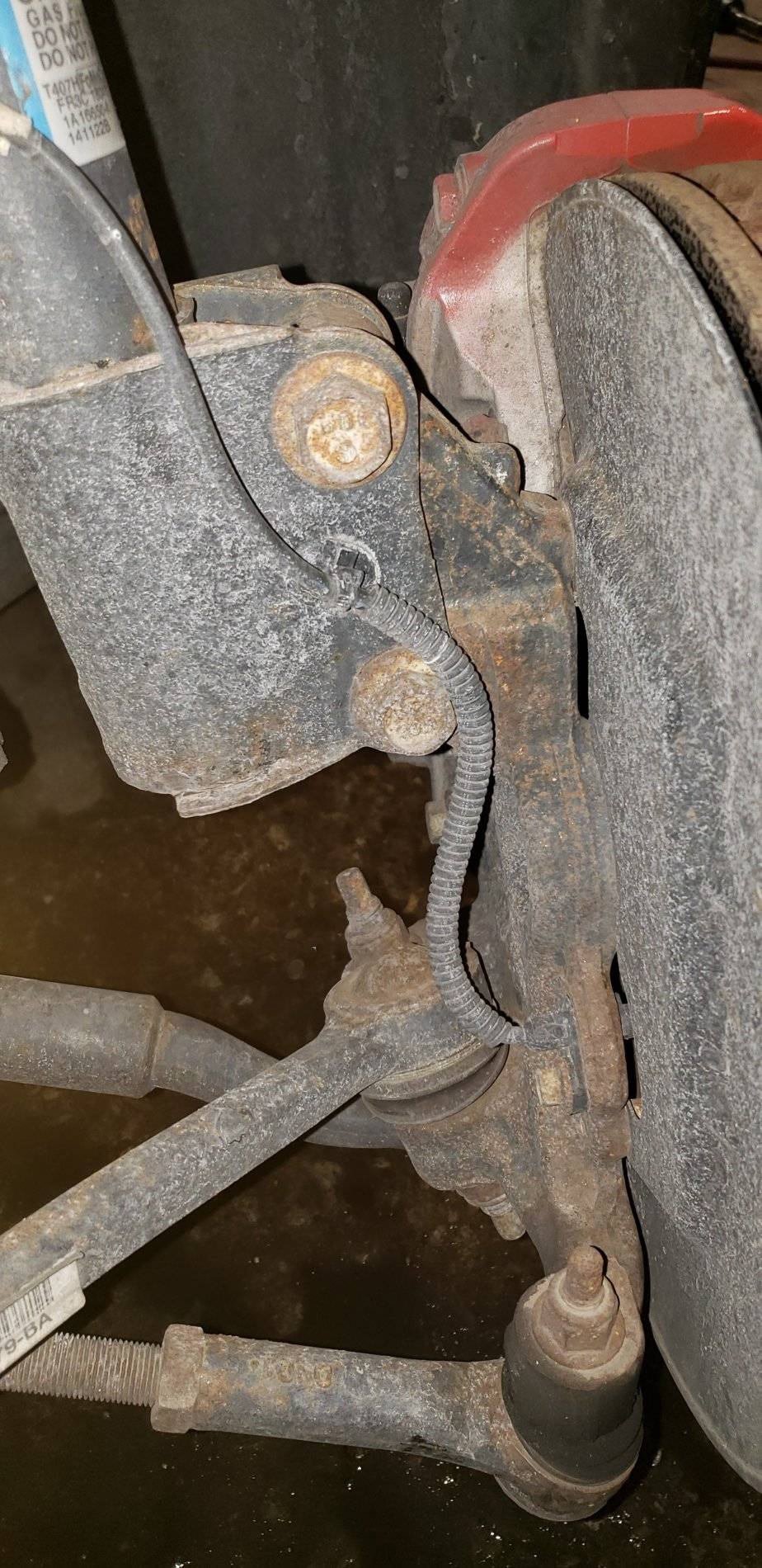

So I have been hearing a noise while backing up and reaching the small bump from my driveway and street. Took some pictures and found this. Can someone advise me on what to do..is it cracked? 2015 mustang GT

If we’re looking at the same thing, I don’t see a crack.

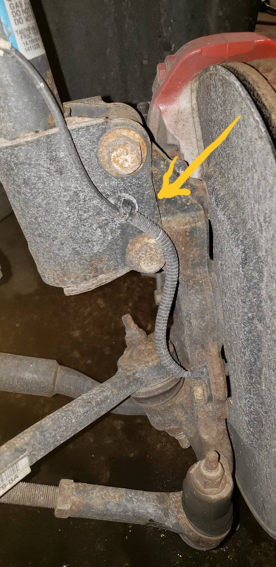

This looks like a crack to me

Thanks for pointing it out. That's the opening on the strut where the knuckle mounts. Two separate pieces of metal.

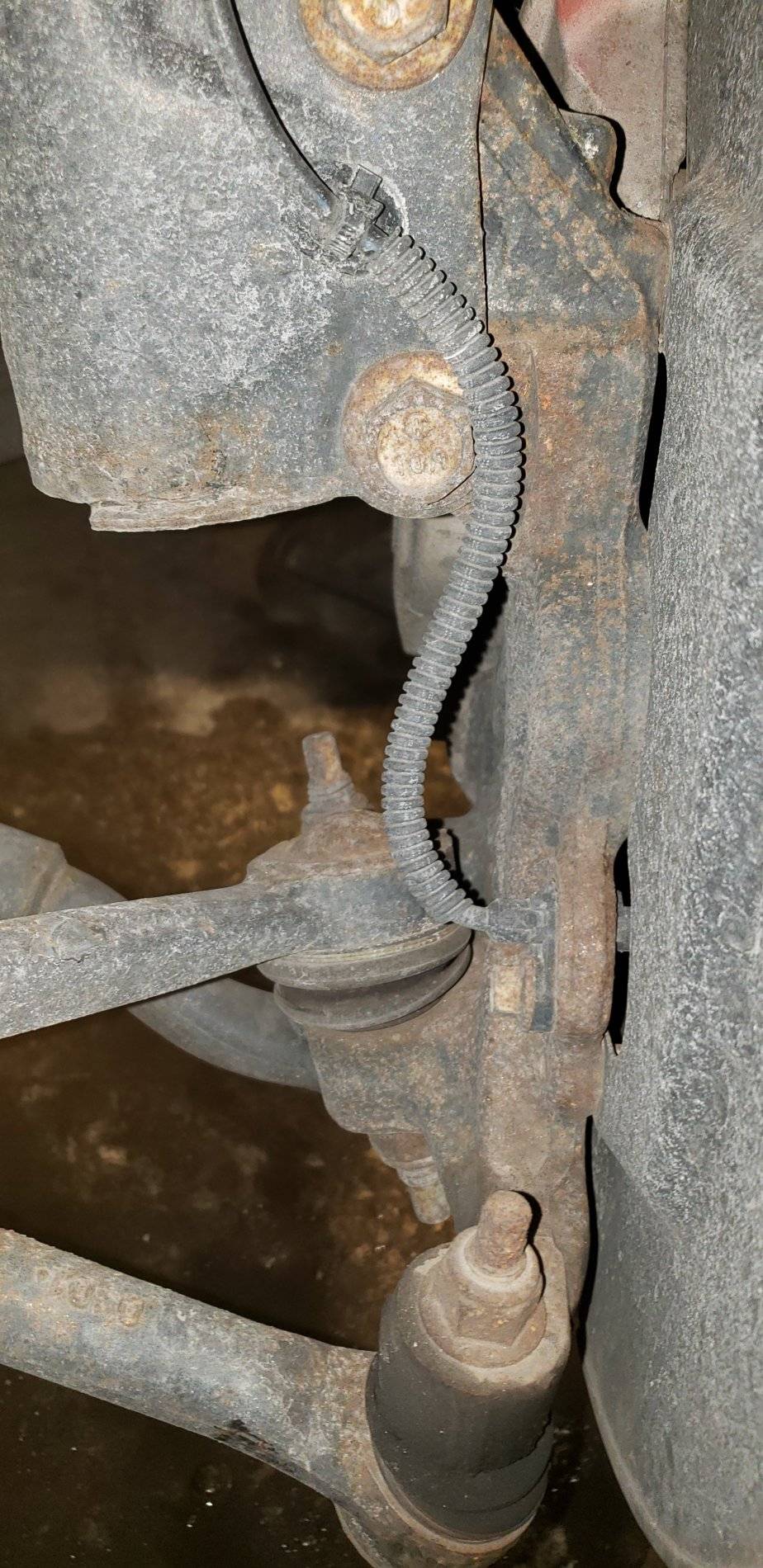

Thanks for your help. Took me a while to see it. The shadow made it look like a crack. I've checked all the joints can't for the life of me figure out what's happening. Here's a video you hear the noise twice.
