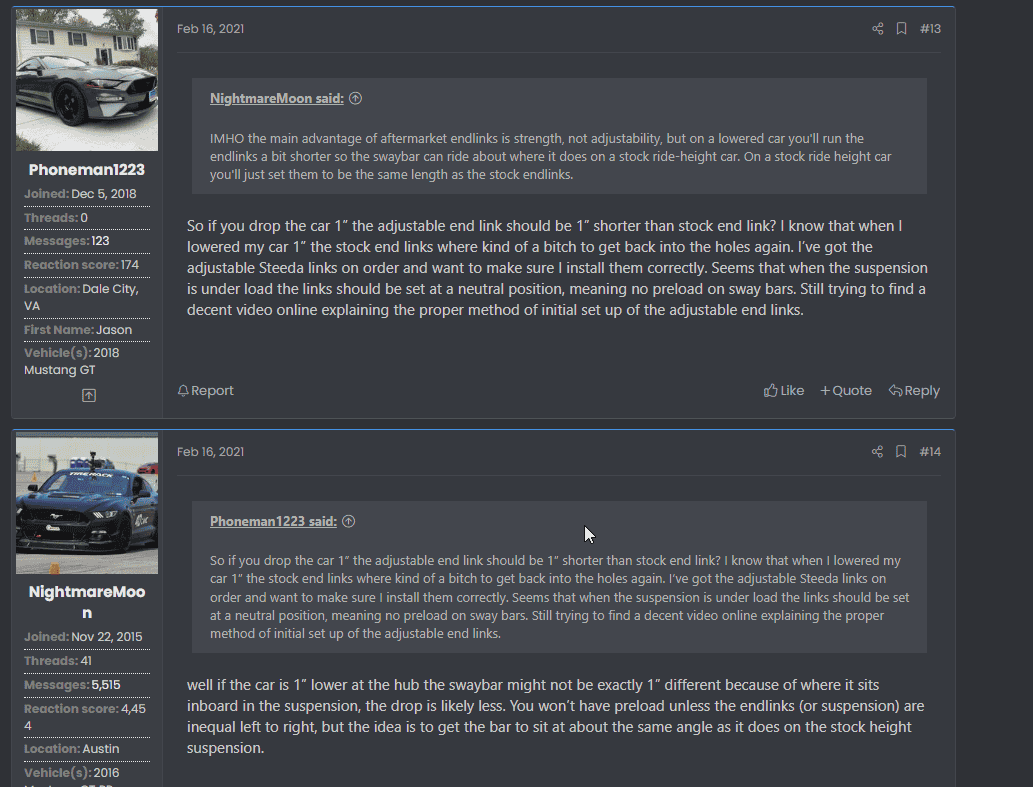

After a little more digging the attached thread is basically what I'm asking. I know I'm not the only one:
