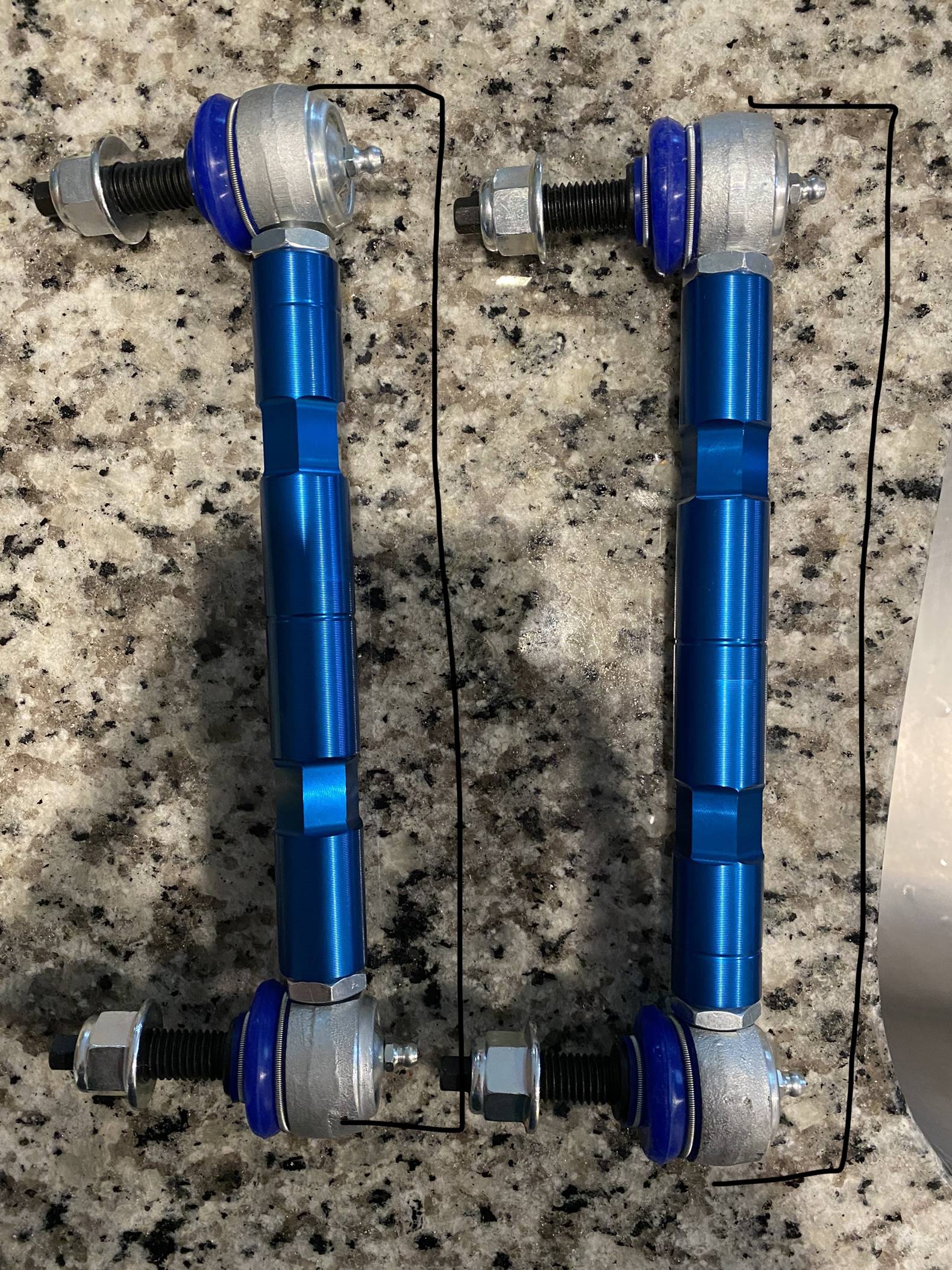

Well after long hours of debating and research, parts are starting to arrive as are more questions! Can someone please point me in the right direction of how long the adjustable sway bar end links need to be? These will be paired with the steeda sport progressive springs. Photo for reference!
