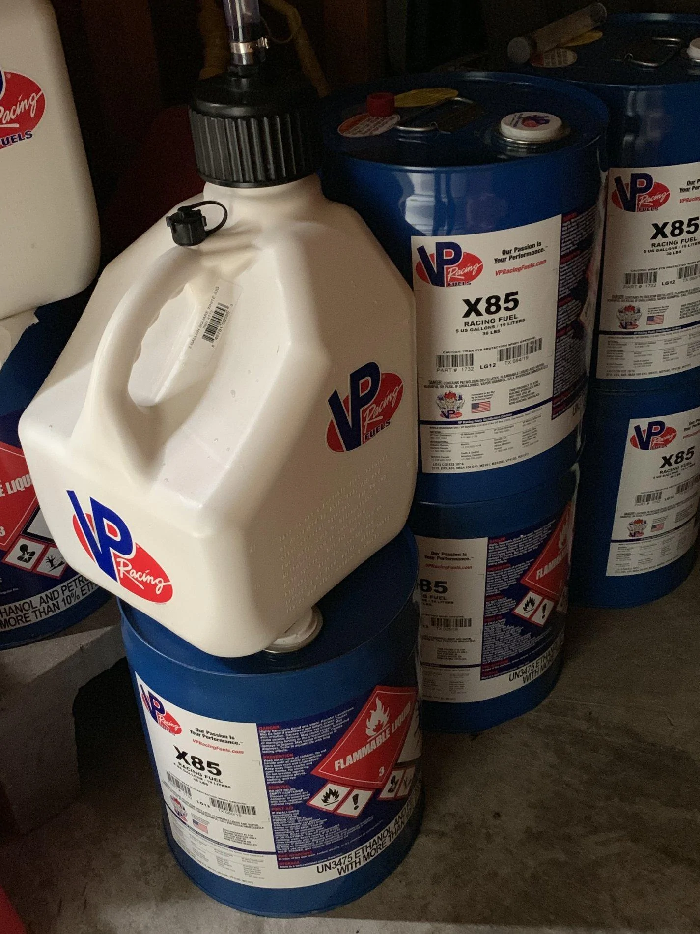

NO! When you find a place that has 85 Ethanol or better, fill up some extra cans to have on hand. Best to always test before you fill your car.
VP X85 fuel is always my back up in early spring, until my local gas stations get in the summer blend of E85. Winter blend tests about 79% in Michigan.
By any chance would you know if that 5 gallon drum would fit in a mustang trunk or would it have to go in back seat? Thanks!
They fit in the trunk.

Sweet, I found a distributor in Phoenix.
