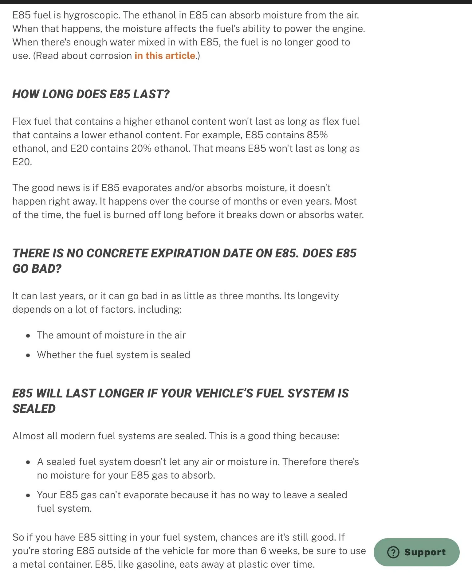

If you keep the car sitting for long time
pls remember e85 tends to absorb water .
you want to consider to add some addictives too
Like
HEET Gas-Line Antifreeze And... https://www.amazon.com/dp/B0016GXNC4?ref=ppx_pop_mob_ap_share
Flex.tune might be the best option. So you can mix with gas when u sit the car

How long sitting is an issue?

I don't think this will work on E85. The main ingredient in HEET is alcohol.
Not my field of expertise but tuner said that so i follow. I did some research and it does absorb water separating it. From e85.
But i think the best thing to do is flex tune and mix with some gas while seated.

how long do you plan on letting it sit? The longest mine sat with e85 in the tank was over the winter so say 5 months and no issues, I just filled the tank up before storage so it was full

Lucas has some E85 stabilizer that you can use if the car is going to sit for a bit. Prevents the moisture build up.

yeah you'll be fine if you are constantly putting fresh gas in it, even if you let it sit for a month or two.
