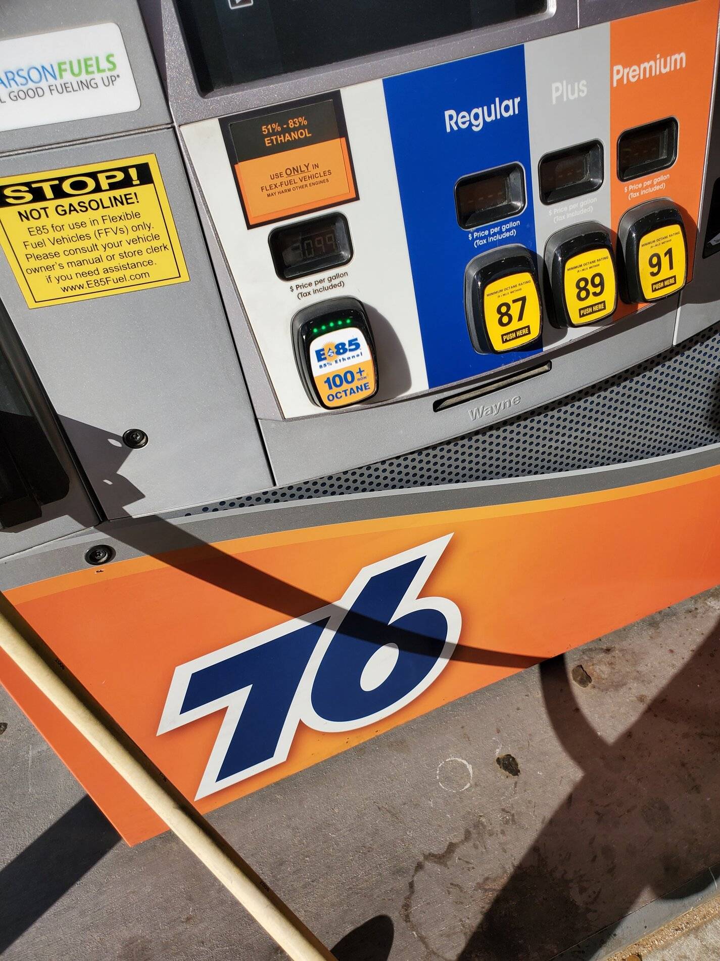

The E85 stations around here have a notification posted that it will contain at least 70% ethanol, which I am concerned about.
LOL WUT
Aug 31, 2015
1,859
2,617
Illinois
19 GT
I have many stations list that E content will be 50-80% or some similar range. The ones stating “a minimum of 70%” have been my go to stations for higher content E. I test every fill up and have never seen below 75% from a pump stating “at least 70%”.
For what it’s worth many people seem to think 70% or higher is good for the E85R tune. I personally move to the flex tune if I see E content less than 75%.
