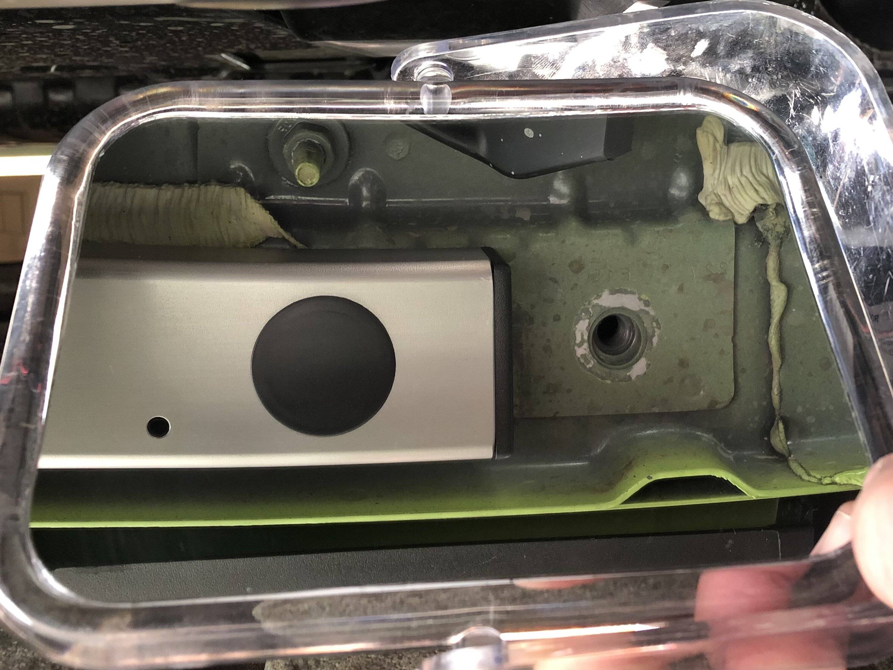

I just laid on the ground without the car raised and used a mirror to help install. Easy Peasy.
Same here, only I didn’t even raise the car.
I just got them loosely in position, supported them close to the floor pan on some random cardboard boxes, then bolted them in place using a bathroom mirror :
WD :like:

I did the same, with a help holding them up instead of cardboard boxes. Took about 15 min per side.
